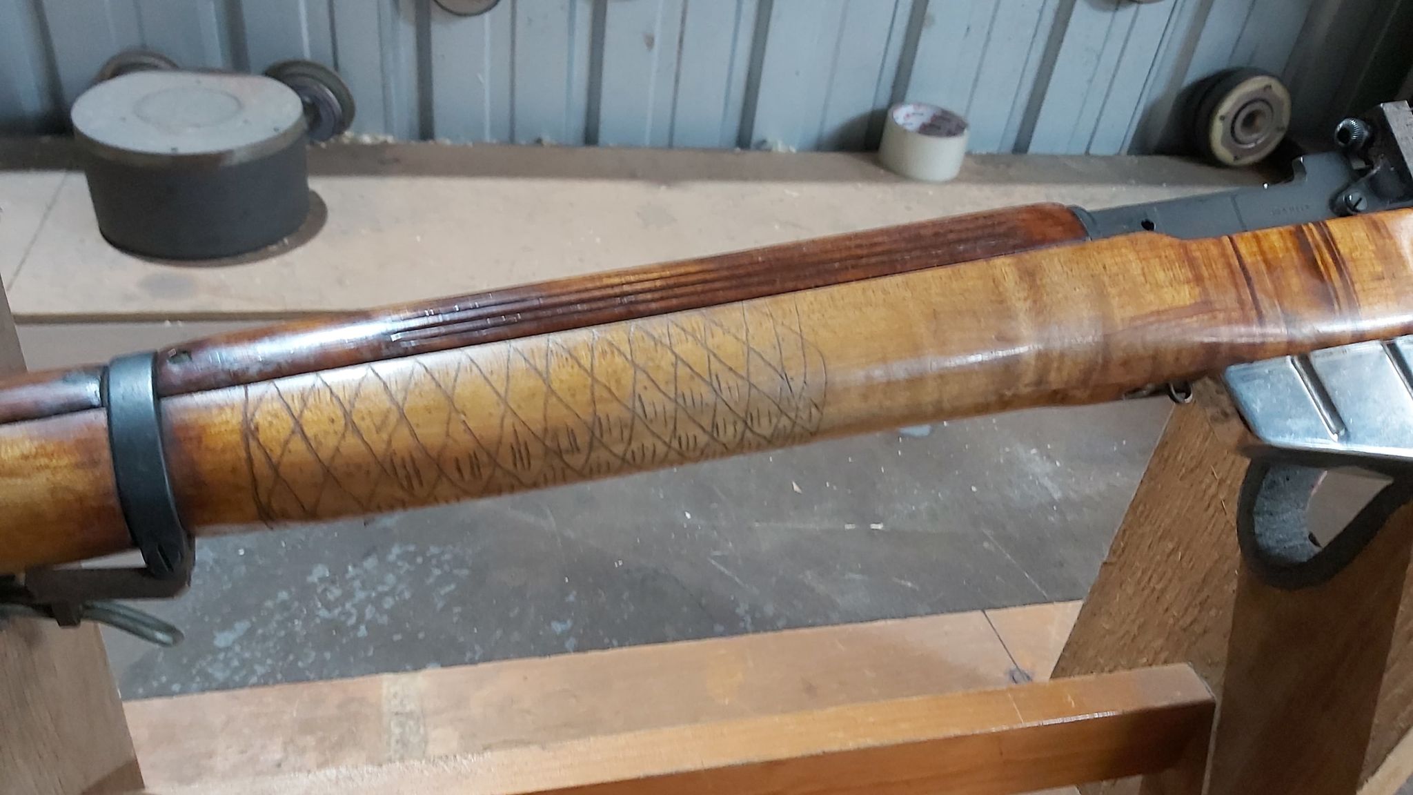

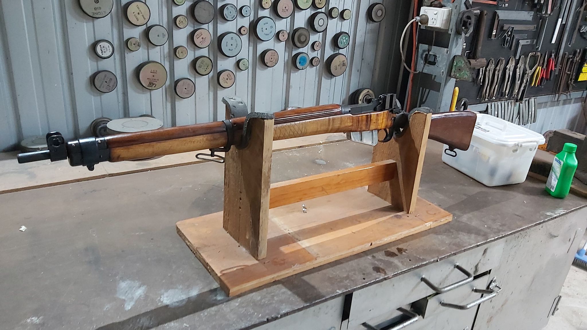

I just wanted to pick everyone's brain. I recently came into possession of a No4 mk1* for an absolute song, even came with a PH aperture sight. The only catch, minor though it may be, is that the wood is far from great. Im not a fan of the varnished finish, ill have to take care of that and refinish it with some oil.

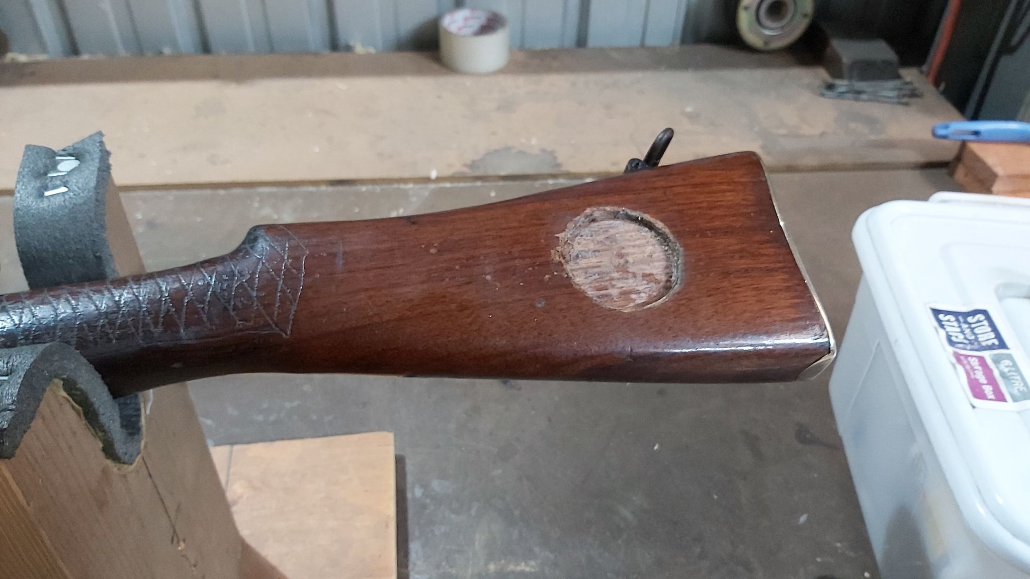

The 1st (and probably hardest to fix), is the original owner had a medal or something inlayed in the the butt and removed it before selling it so I got a big nasty hole in the stock. I was considering having a mate turn down a brass disk to fill the hole. I think a big shiny brass disk against the dark wood would look nice, but honestly i think the inlay job is beyond me. Does anyone have any experience with this? other wise i might consider replacing the butt all together (if anyone has a No4 butt stock there not doing anything with and wants to make some beer money let me know)

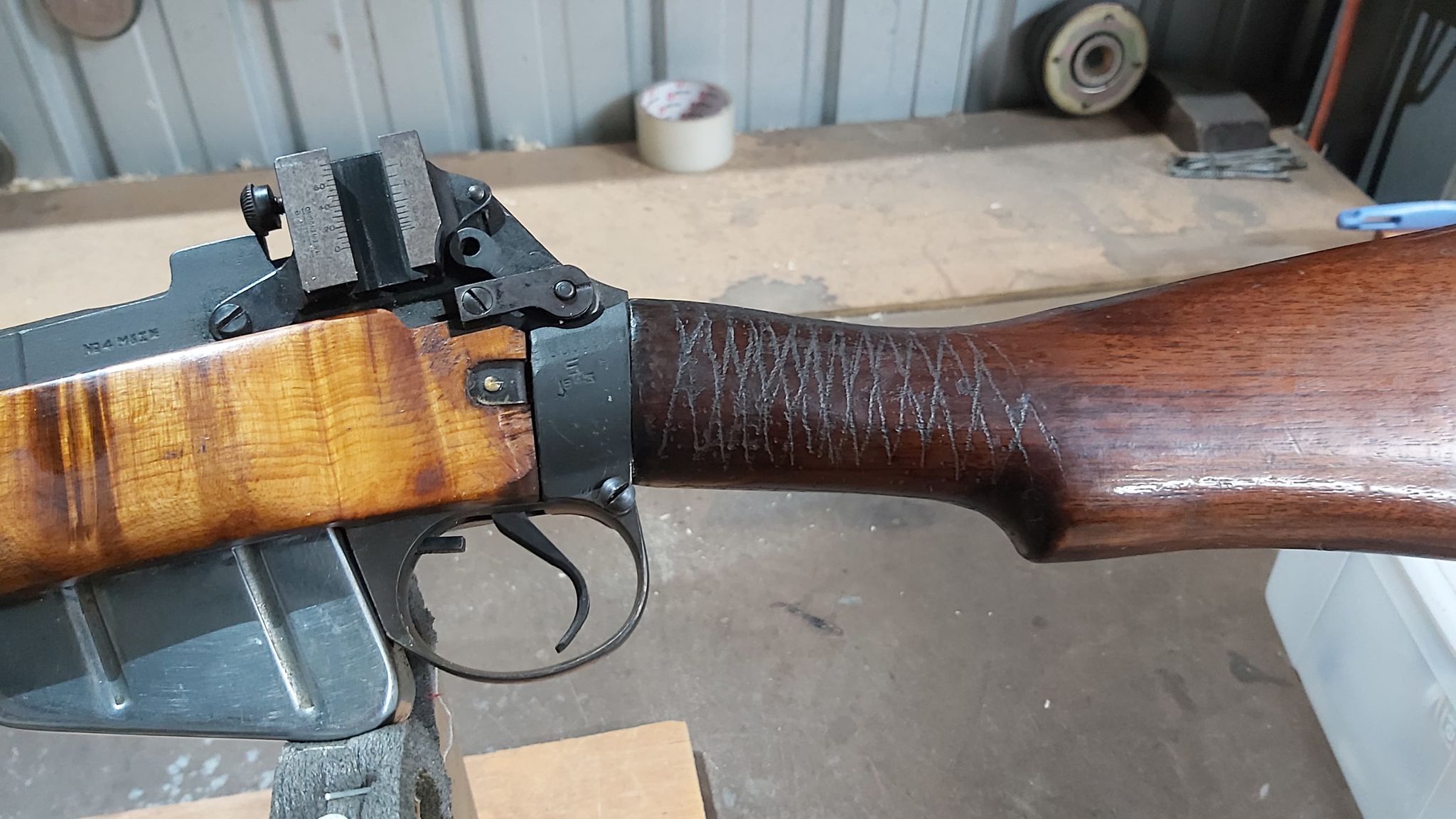

The 2nd issue I have is the previous owner for what ever reason scratched (poorly i might add) some odd pattern into the lower fore stock and butt stock. It looks like its just made it past the varnish coat into the wood, so even if I strip the varnish ill still have the pattern in the wood. Does anyone have any tricks or tips as to how to tidy this up? its rather not go at it with sand paper and make a small problem into a big one.

I would hit it with paint stripper and then some oven cleaner and finish the job with sandpaper. Look at it another way there is not much you could do to make it worse or take away any value. You will only improve its appearance.

Since you got it at a good price just ditch the stock and foreend and put your efforts into bettertimber. There are plenty o replacement options online from used n abused through to new old wood. All depends on what you want to spend on it but even if you have a go at refinishing your current wood I expect it will be better than what you have atm

Replace the butt stock
Sand that s**t out of the forend
Boiled linseed oil, dash of turps warmed with a bit of beeswax melted in is the way to finish em.
The woodwork on these were rough from new, I have no idea why people sand them and make them look like a french dining table.

That fore-end wood is a different colour to the butt. Does that bother you? IMO, it would (no pun intended) be a tricky job trying to stain it to match.
