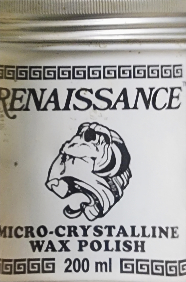

Post by Lazarus » 07 Nov 2022, 6:54 pm
I use Renaissance Wax, it cleans and protects.
Not cheap but it's magic stuff

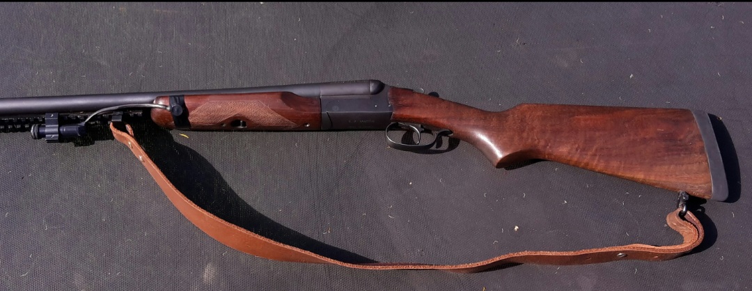

Post by on_one_wheel » 07 Nov 2022, 7:42 pm
:lol: Nice one appolo, your inner Mr Positivity is shining brightly lately.
My 12 gauge has a hardwood stock that's non varnished / oiled, and over time it generally gets the same dark marking from grime. Being such a dark timber it doesn't stand out.
General I keep on top of it by using a little turpentine on a rag and give it a real good heavy rub.
It will strip some of the oil out but not as badly as most solvents.
Re apply some linseed oil, let it sit overnight and wipe off any excess.
That's been my routine for the 10 years or so I've owned this one :thumbsup:

Post by on_one_wheel » 07 Nov 2022, 8:25 pm
Lazarus wrote:I use Renaissance Wax, it cleans and protects.
This would definitely be the safest, least aggressive option suggested so far, you can get a small 65ml pot for $36 on ebay.
Waxes are fantastic on timber.
