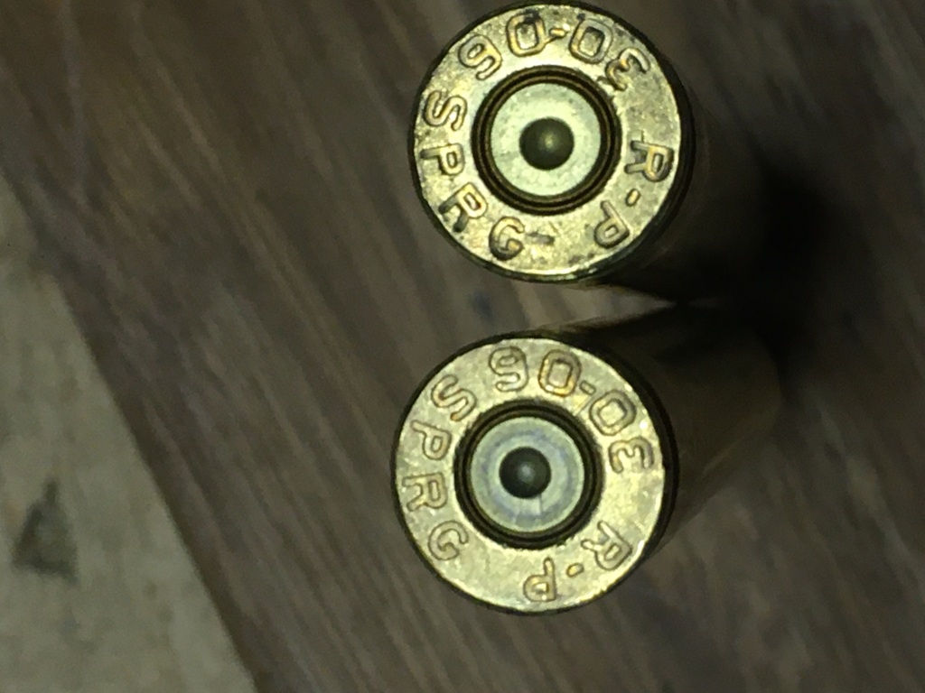

Oldbloke wrote:"Come on suddenly".
"Only after firing".
Did you change ammo? Or change load?
Sounds like a pressure issue to me.
No change, I've looked at the last few rounds and can't find anything that makes me think of over pressure (not that I know anything :crazy: )
They all look like this.

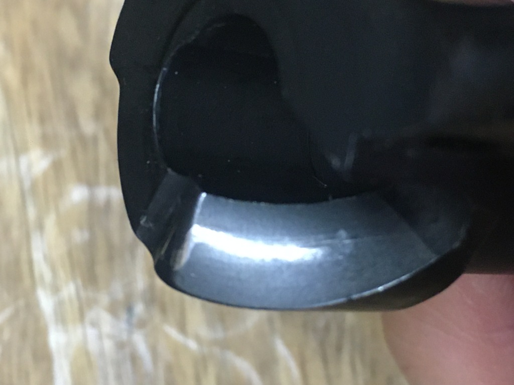

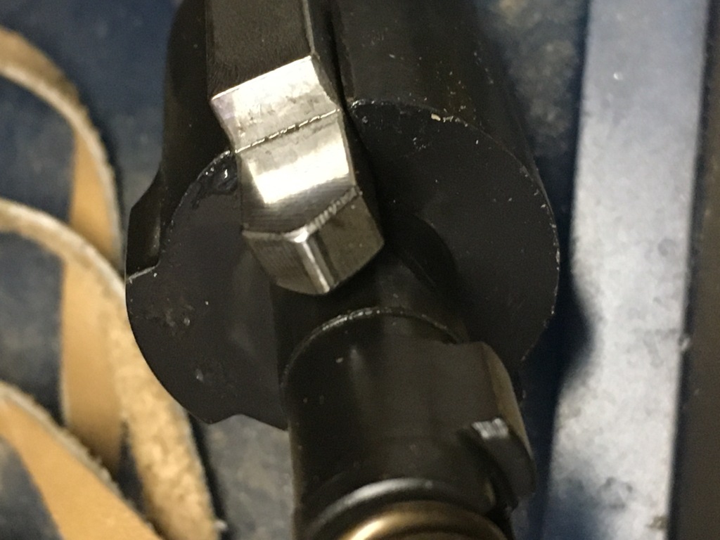

I've inspected closely, and there is a wear mark where the cam runs up the ramp(?) and possibly the beginning of a dent where the cam hits the ramp for the first time. Assuming this is the case, a bit of polishing with high grade sand paper an option? As above though, it's sticky the whole action not just to force it free.
Would a bent firing pin be a possibility?
Ok, more like 1mm gap rather than .5mm
Looks worse in the photo than in person, but could do with a polish?
Very hard to get a good photo of the ramp surface with it's curved face.

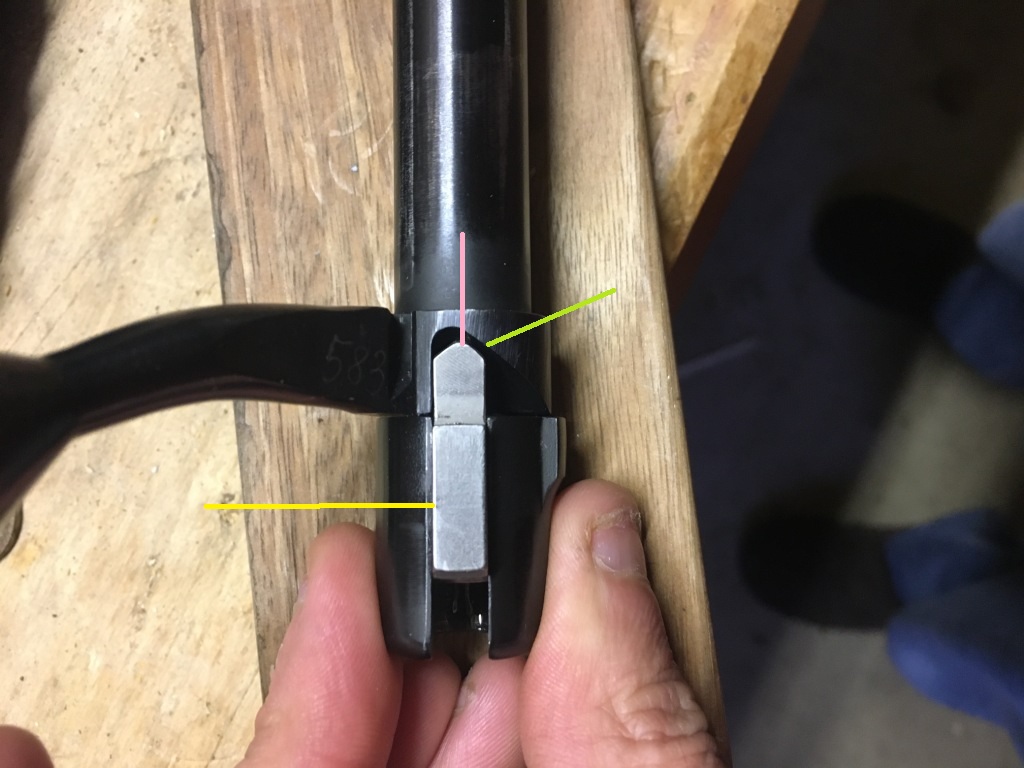

Post by straightshooter » 08 Aug 2023, 8:59 pm
Flyonline
Please look at my version of your picture.
If there is any noticeable wear on the cocking piece nose (the magenta line) then that is an indication of inadequate hardness in the cocking piece.
The cocking cam surface (the green line) should have a smooth burnished mark where there is contact with the cocking piece. Examine it carefully with magnification. If there is a grainy or flakey appearance then that could be due a hardness issue but it could also be due to an excessive friction load from elsewhere in the firing mechanism. The surfaces indicated by the yellow line should be examined and might benefit from being stoned with a small Hard Arkansas stone and light oil. These two surfaces rub on each other with some force when cocking and roughness due to machining marks could be contributing friction between the cocking piece, the bolt shroud and possibly the bolt itself.

straightshooter wrote:Flyonline
Nothing noticeable, but I'll look more closely when I pull it apart. The cam surface does have a wear mark, but I'll need to get a magnifier of some kind to look at it more closely.
