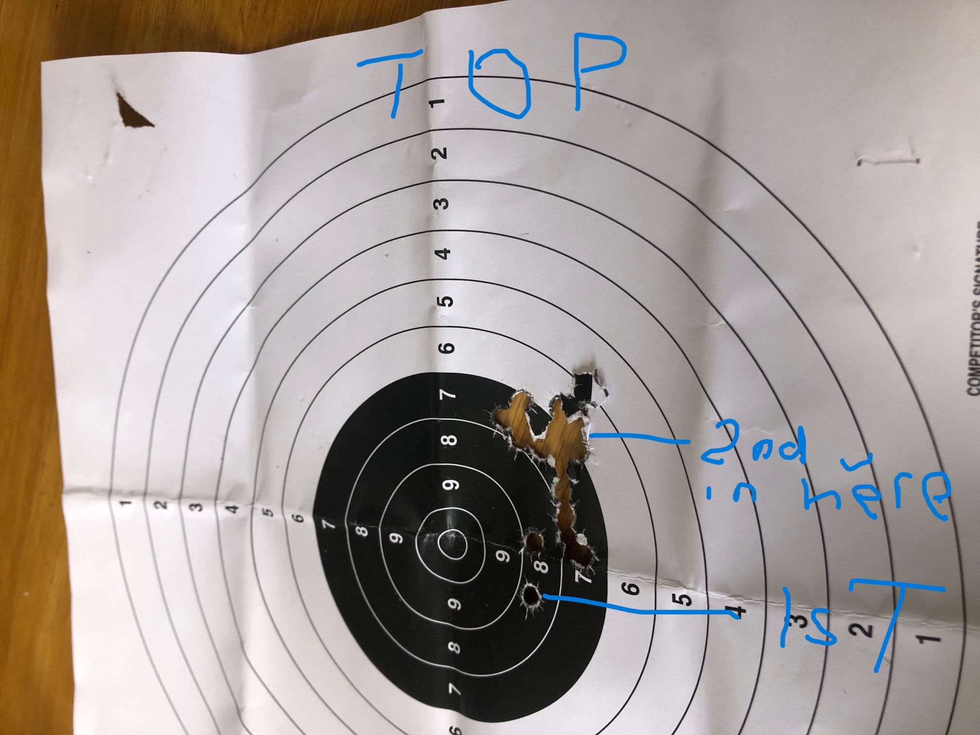

I have a 1982 BLR 81in 308, with plain timber with an oiled finish.
At times I'm struggling with fliers, couple of inches off on the first shot which isn't a major issue out to about 100 metres but is a pain in the butt at 150 - 200 plus as it isn't a constant.
When I bought the gun the fore-end was almost fully floated and I relieved it a little more so a sheet of notepaper curled into a U shape passed freely between barrel and fore-end(it has a very light barrel BTW). One of my club mates shot it and did the paper trick and it stuck about half way to the receiver so I guess the for-end is warping so I have a couple of queries,
1. Should I relieve the fore-end some more and, when that is done what's the best method for resealing the timber.
OR
2. After doing 1 above should I build up the tip of the fore-end with epoxy to act as a pressure point and then reseal it.
It's worth pointing out that subsequent shots make very compact 100 yards groups.
16 shot group cast 165 grn boolits at approx 1800 fps.
cast 16 @ 100.jpg (436.05 KiB) Viewed 7810 times

I would consider adding some pressure for a temporary test.e.g some cardboard.
Some rifles do shoot better with some pressure under the barrel at the forend.

What might be an interesting experiment, is to bench it with the forend removed. Little tricky balancing it on double bags, but certainly can be done. The objective would be to have the front bag under the receiver, not the naked barrel.

There are chapters from McPherson's valuable mess, around the BLR/Savage99, but the premise remains the same. To quote "any system that places wood (or almost any synthetic material) in direct contact with both the receiver and barrel offers the potential for the following things to induce stress between the forend and the barrel-receiver system: changes in barrel temperature, due to shooting or atmospheric temperature; variation in stock size and shape, due to changes in atmospheric humidity
I.e. you have to identify, then relieve any forend bind. That is of course if you desire to shoot groups with your lever. A tight three shot group is essentially the design specification for a hunting rifle, which any BLR, (or leveraction for the matter), will probably offer out of the box.

IN2anity, my BLR fell out the box 42 years ago. It looks like it's been well treated and the bore looks like it's been a 10 shot per annum rifle.
I accept all you say, shortly after I bought the gun, I cleaned up the fore-end so it was clear of the barrel and the accuracy was excellent, I won't bs with figures.It's overwintered in my safe and now produces flyers.Though it only seems to doit for the first shot. Barrel just receives a pull through with a bore snake after shooting and no prep before shooting. The only other unorthodox practice is I tend to clear the gun's throat with jacketed ammo then the bulk of the shots are with gas checked cast boolits at 1500 - 2000 fps. My regular hunting load is a speer 165 grain BTSP in front of 43.5 grains of N-150 SAFE IN MY GUN THINK TWICE BEFORE USING THE LOAD IN YOURS. It has a MV of between 2500 and 2600 fps.
I think I naively expected the wood not to react to having no treatment on the area I'd relieved other than a quick rub over with walnut oil hence my query what's the most efficient sealer for hide-away areas like this bearing in mind the whole of the woodwork, stock and fore-end, has been treated to an unidentified oil finish.

Shame it puts the cold low - that vertical stringing is very indicative of a forend bedding issue. Does your BLR have the barrel band by chance? Is it tightly clamping the forend and barrel?

I presume the only thing holding the forend on now is the hanger closer to the receiver. And that nips tight onto the timber underneath. Other than that all floated for now? What if you investigated a way of adding breathing room at this interface? Like a rubber oring betwen the screw head and timber? Or perhaps one between the hanger and the timber.. if yu get my drift. I've used RTV gasket silicone at interfaces like this in the past - integrity, without choking like an epoxy.
I must say though, sometimes these systems work more consistently with a dampening bed, like cork. Like a Lee Enfield No4 needs to be dampened for optimal consistency aka the "bisley bedding" method or "center bedding". That's along the lines of a full RTV silicone bed as described in other posts.

Well it may be sorted, loaded up a bunch of speer 165 grn BTSP bullets into some federal brass with 43 grn of N-150 and magtech primers, 20 rounds no fliers.
I scraped away wood so it was clear all down the fore-end then, when finished, bent up some small postage stamp sized pieces of ABS by heating it with a hot air gun and holding around the barrel where the fore-end ends. I had 3 thicknesses, 1.5, 1.0 and 0.75 mm and the 0.75 mm thick one was the Goldilocks, literally just pinched it between fore-end and barrel.
Grouping wasn't anything to right home about but that was probably me in a bit of a rush. Just have to get some filler now and do a proper job.
