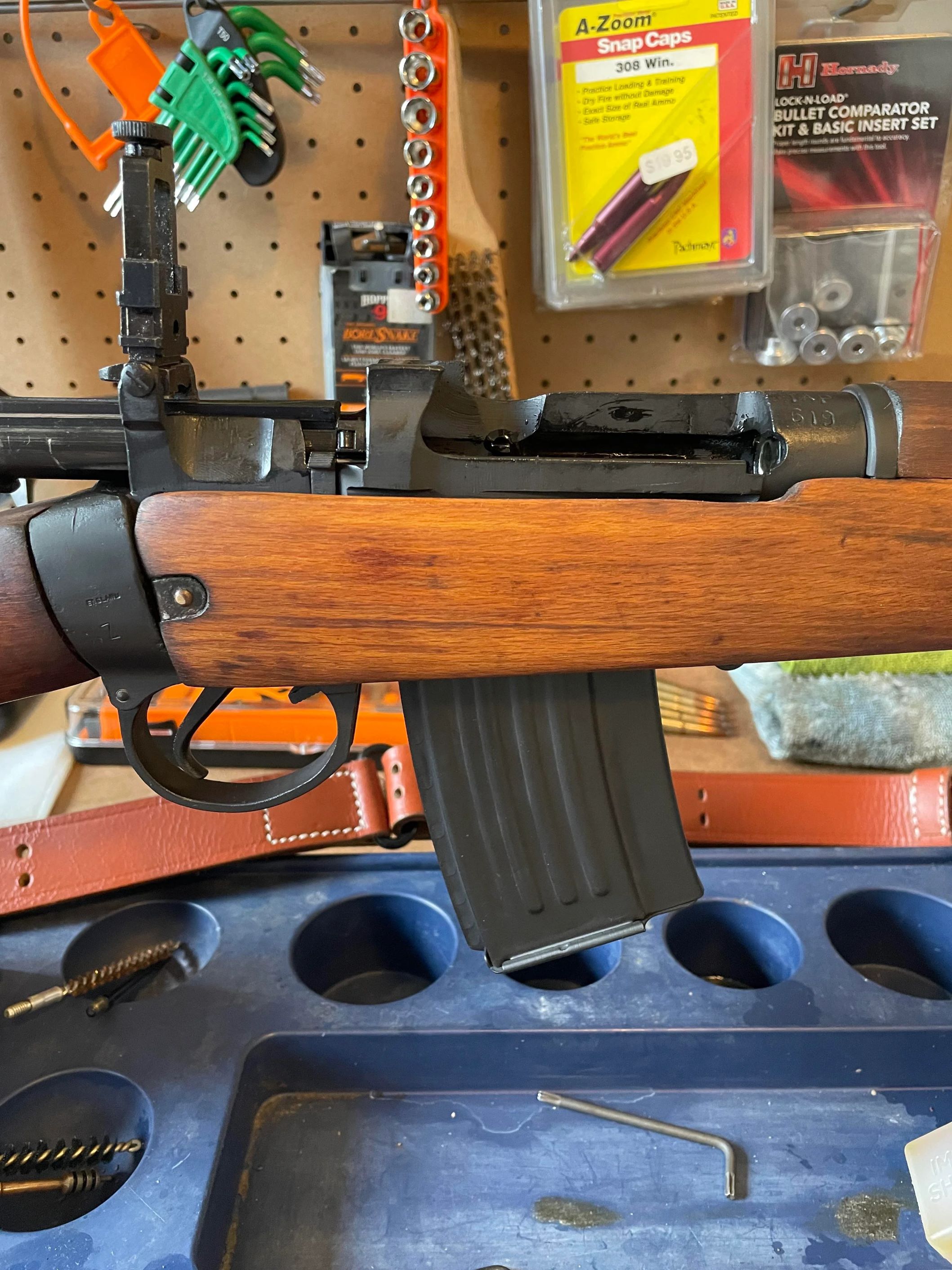

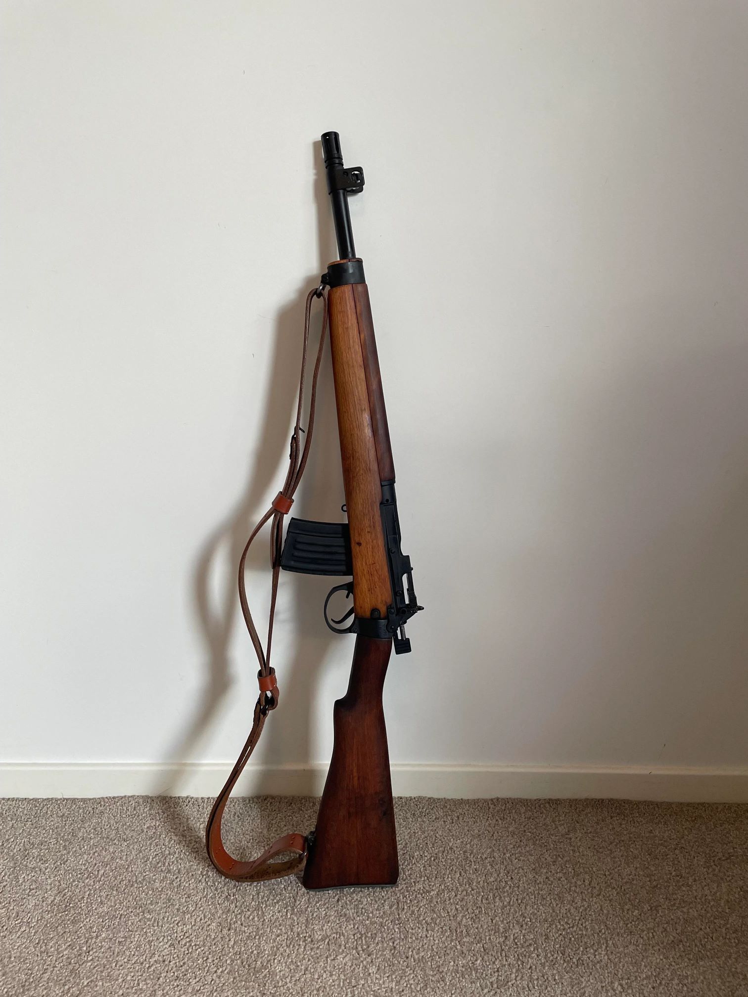

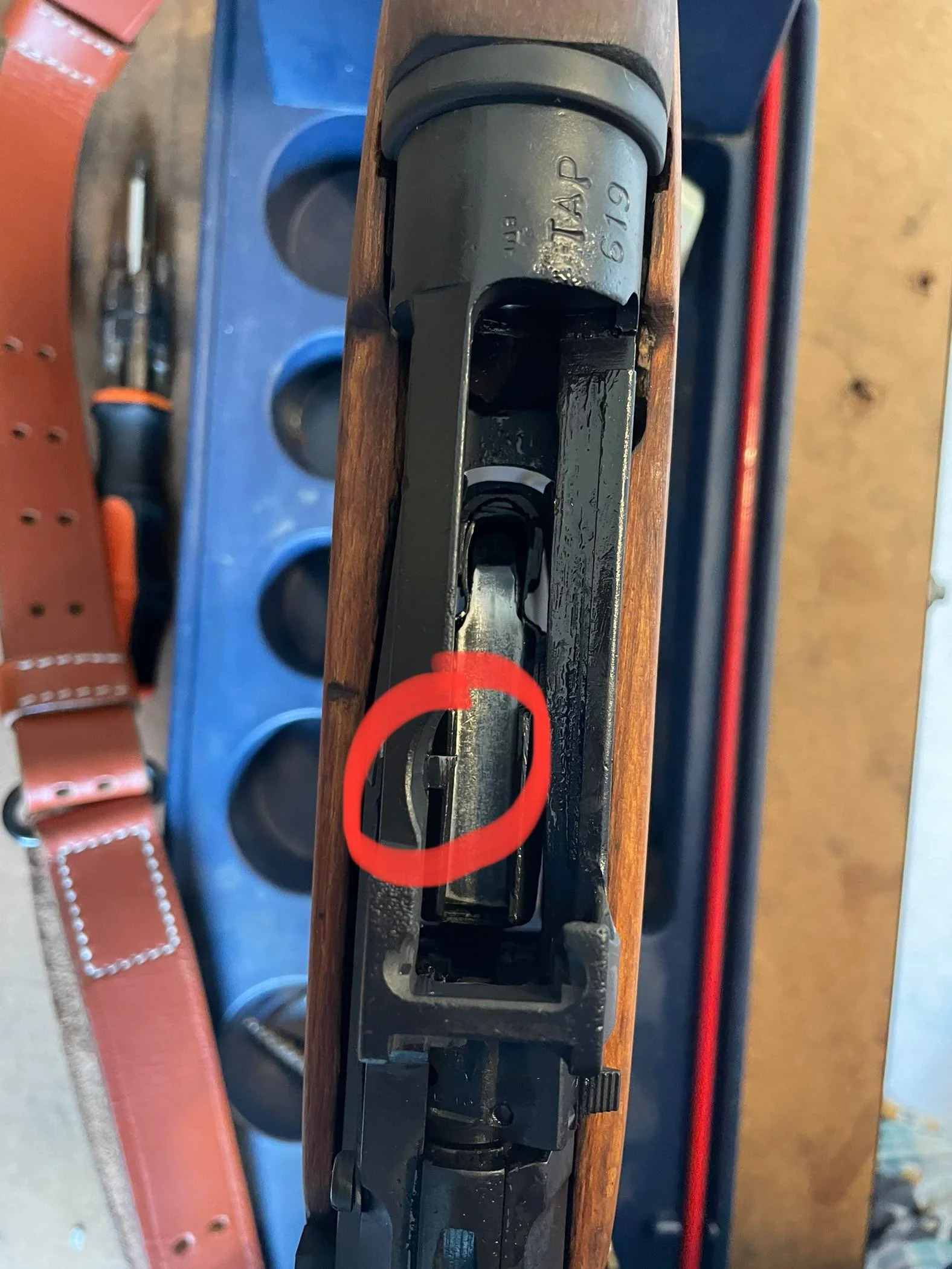

Post by No1Mk3 » 19 May 2024, 11:29 am
Just google 223 Enfield, plenty of articles and videos, here are some pics of a rifle converted in Qld
