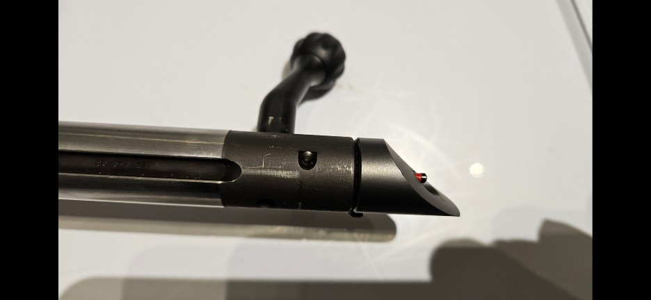

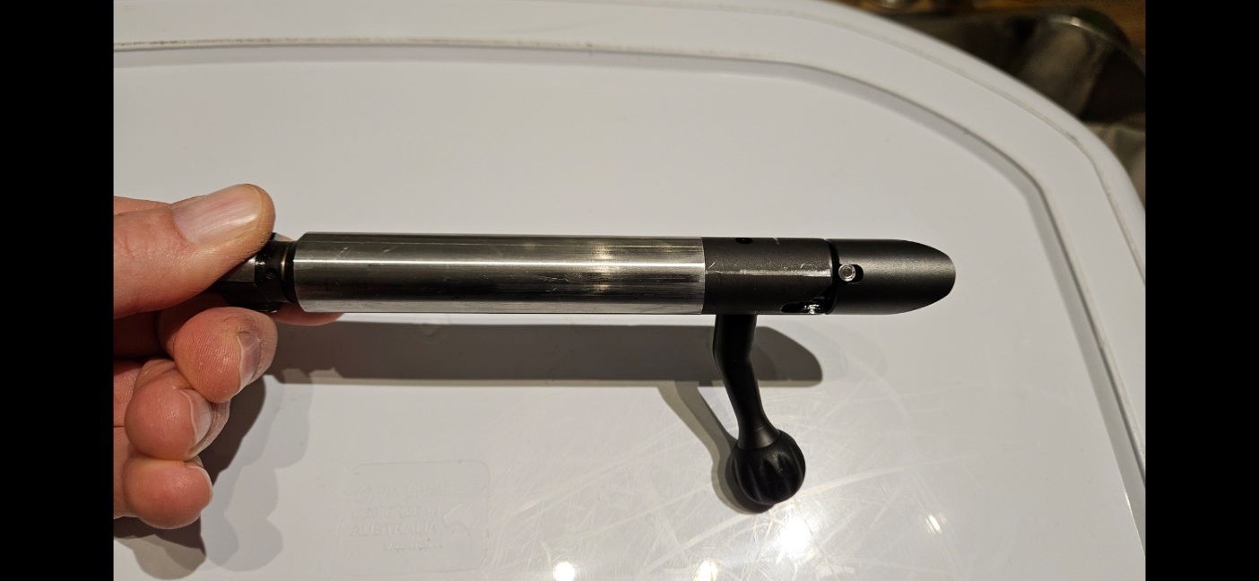

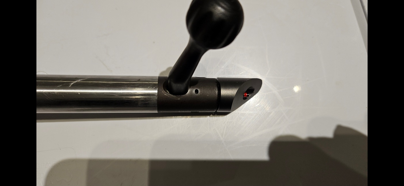

Hey Trapper22 I hope you're still around! I know this is an old thread but do you have any pictures of your bolt and the pin you say to drift out? Do you mean the small pin at the base of the bolt handle that has a bit of a mushroom head?

Post by Charlie2072 » 04 Jul 2024, 8:18 am
Here are some pics of my bolt from a Sauer 100
