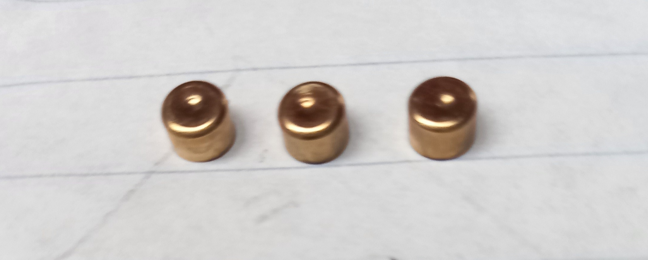

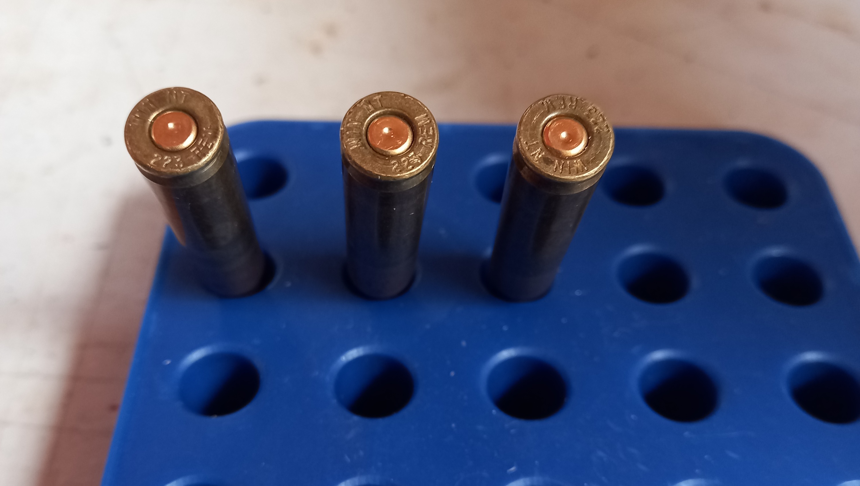

Next I found 3 of the cartridges that misfired.
1. Pulled the bullets
2. Dumped the powder.
3. Replaced the dented primer with a new one. (Retained the old ones)
4. Dug out 10 recently FLS'd cases and primed them. (abt .008" h space)

Meant to add this. The 3 misfires.

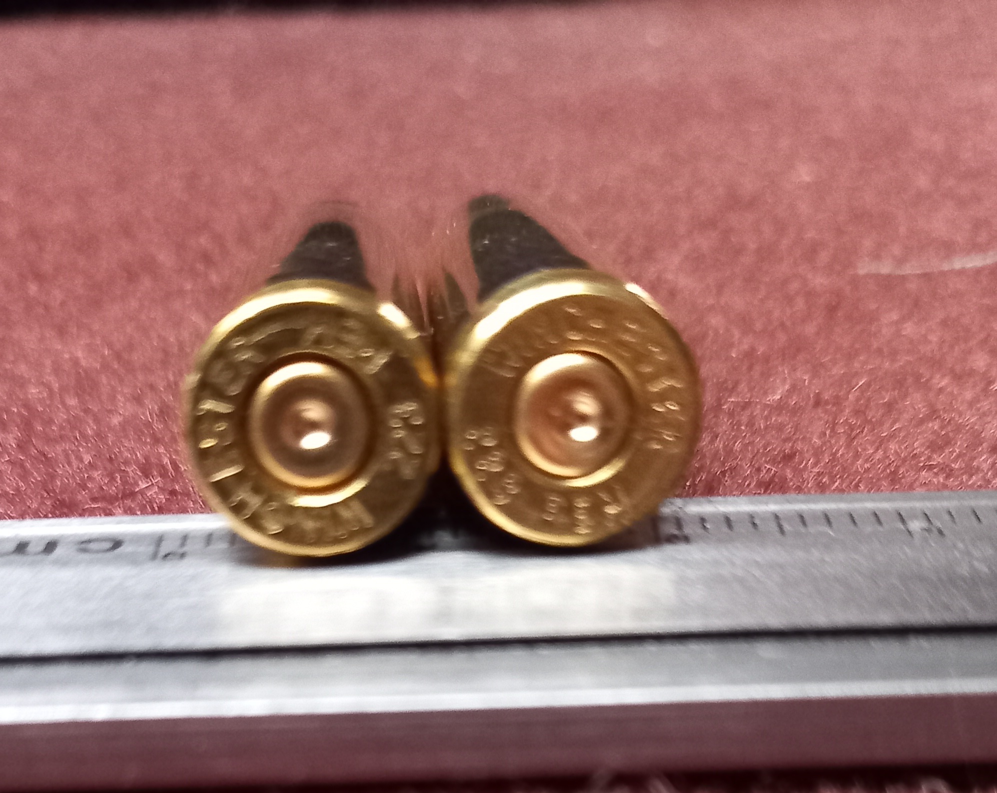

Post by on_one_wheel » 24 Nov 2024, 4:57 pm
They certainly look like shallow or light strikes.
Did the ones that fire look a little deeper?
Re: Misfires

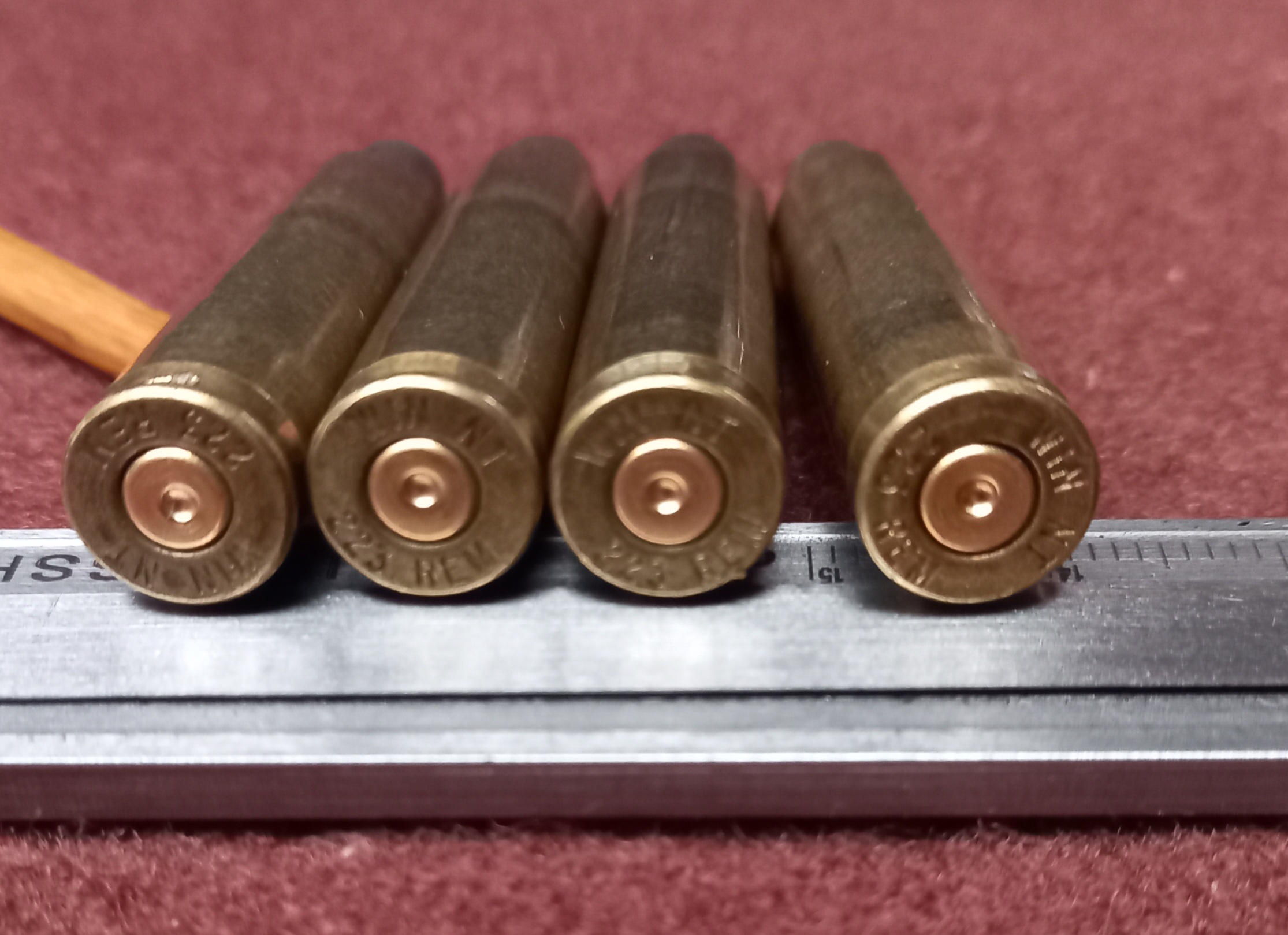

Post by Oldbloke » 24 Nov 2024, 6:11 pm
3 mis fires again
2 fired only with primer
4 normal cases, primers
Re: Misfires
Post by Oldbloke » 24 Nov 2024, 6:15 pm
I agree, the misfire primers look a tad more shallow than the others. And only about 1 in 7 misfires.
Really not much in it.
