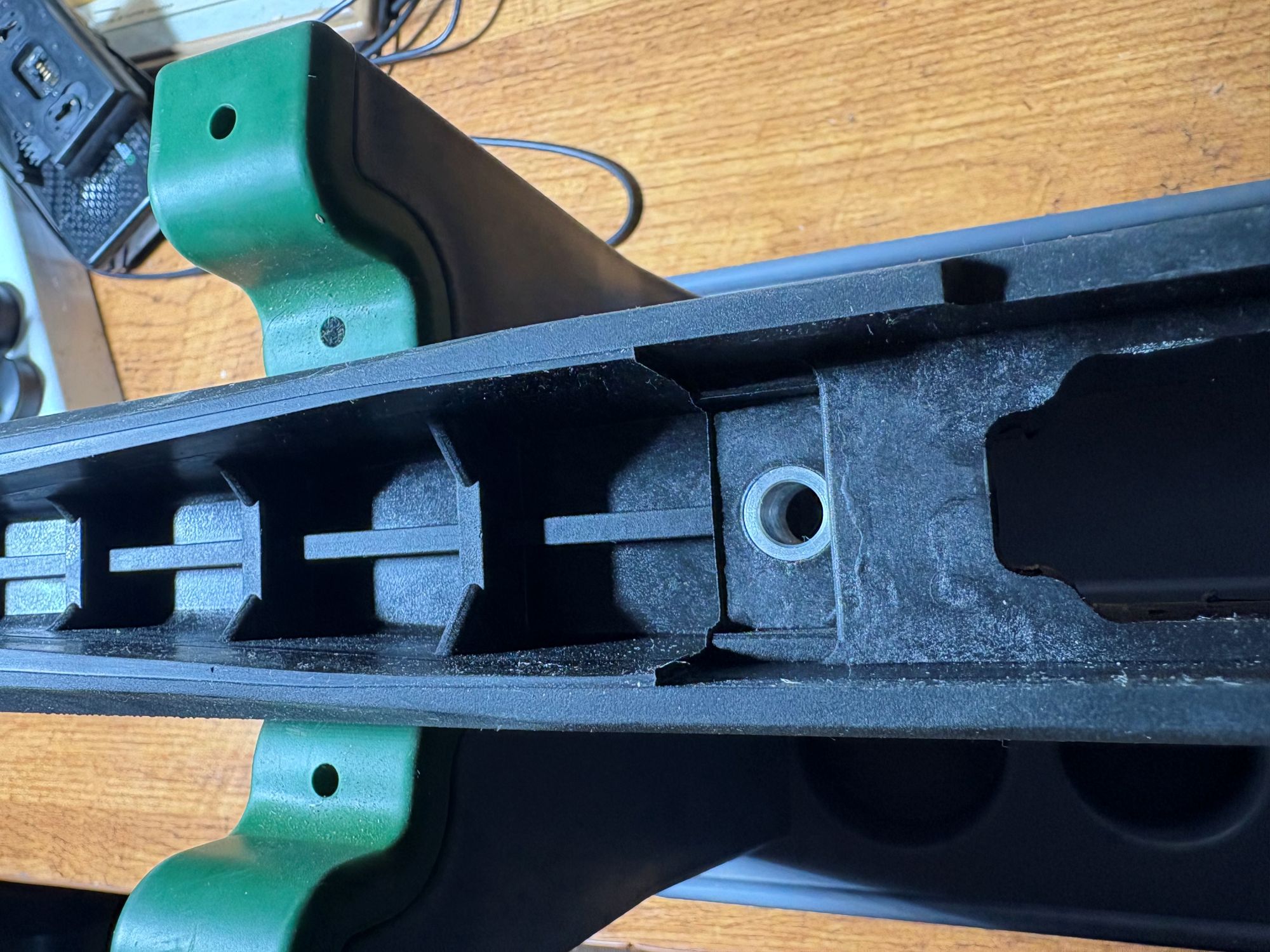

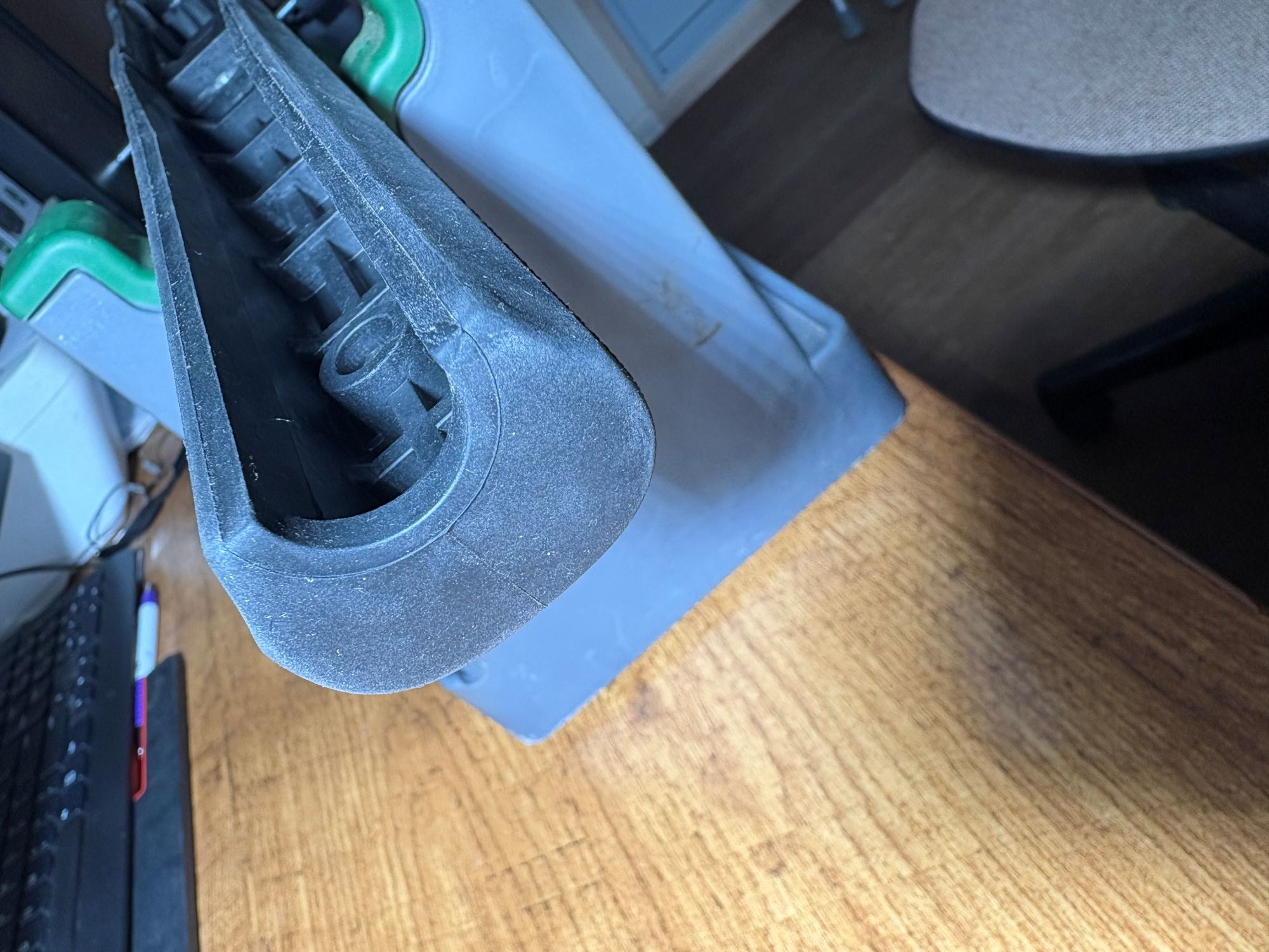

Has anyone peeled out the inner lining in the barrel channel of one of these stocks.
It appears to be a separate layer that is ? glued in.
This one suits a sporter barrel,,,,, but if I could peel the inner lining out,, the heavy barrel would slot in nicely.
:unknown:
Howa Hogue.jpg (358.57 KiB) Viewed 325 times
2nd Hogue.jpg (428.81 KiB) Viewed 321 times

It looks to me like the inner part is the supporting structure of the stock, with an outer aesthetic "skin" wrapped over it. Get a socket that fits the channel, wrap sandpaper around it and sand out enough material to fit the barrel.
Hi Blade,
The extreme outer skin is soft and grippy.
The inner section that I think can be removed is rubber (to the feel) ,,,
Which leaves the hard plastic support of the stock itself that should accept the barrel.
I don't intend changing the action/bedding section.

I've opened up a few Hogues, for Rems and Howas.
But only to better float a sporter barrel in a "sporter" stock. To give more clearance because it was lop sided and touched in spots.
This I did with a die grinder and a rough stone, controlling the trigger so it doesn't go past about half-speed. That way, the rubber coating and poly stock underneath grinds off in a powder, instead of melting.
I suppose a drill would do, but because of its low speed, it's easy to have it slip and run off.
Use thick duct tape to protect possible run-off areas.
I cannot imagine how futile sanding this stuff would be, even the poly stock substrate.
However, I've had a gander at the idea of opening up a sporter Hogue to fit a varmint barrel, and I reckon there's not enough of the original material to do that. A varmint barrelled Hogue is, in the ones I've bought, wider in the forend where the barrel centreline is.

Yeah mate, have a look at what dimensions you have there if you were to open it up.
On the ones I have, so much would have to come out of it, there wouldn't be much left around the top of the stock, and the rubber coating would be likely to peel off because where it now rolls over the top, it would be cut right back too, and exposed.
At least, that's what looks like happening. Buit your example may be different, and your barrel might not be so big.
