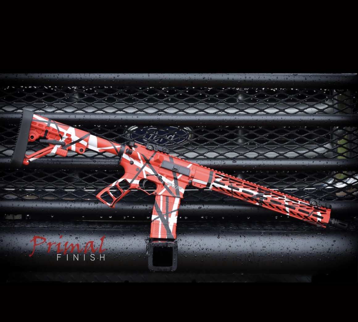

Post by MG5150 » 05 Aug 2025, 10:23 am
Being a Van Halen fan I've always wanted to do this!
