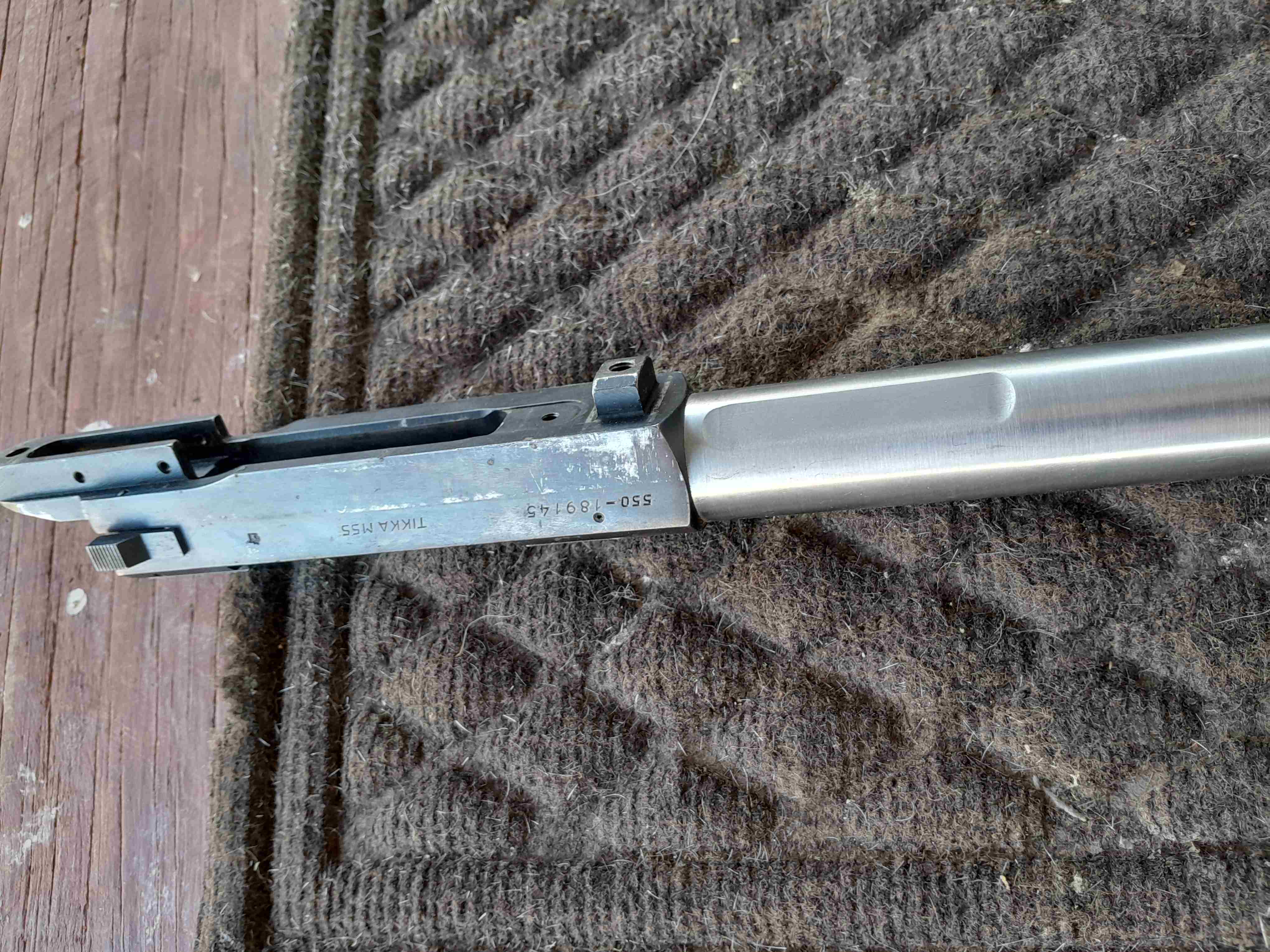

Post by Wapiti » 16 Mar 2026, 8:17 am
A word of warning,
The son of a mate down the road on a cropping joint bought a Tikka M55 222 that was in good nick except for a worn out barrel, he had it rebarrelled down at a place between Bris and Warwick.
They offered him a second-hand super heavy stainless 22-250 barrel cheap, just pay for cutting off the old chamber, rethread/chamber and fit to 223, so he accepted.
He just got it back and outwardly it looked OK.
His dad asked me to come down because he wanted some advice on setting it up in a small lathe he'd bought, and when helping out I found that one, he didn't have all the gear he needed to set it up and two, when I brought some stuff down to show him how to clock the barrel straight on the bore at one end and the chamber at the other (has to be on the bore centreline, including the action centreline, not the external) , the action was running out by 15 thou at the end. That was cut that way by the supposed gunsmith.
The barrel also had a big flat milled in it at the chamber end, this was at the 4.30 o'clock position on the knox, hidden by the stock.
I can only assume it was put there to allow a big objective scope bell to clear this massive barrel, as it's virtually straight from the action. There's no way it was put there to tighten the barrel in, that would indicate a smith without the correct gear. He wanted to bed it and asked whether it might cause an issue in trapping the barrel into the compound.
Disclaimer - I'm not working on any other persons guns or modifying them whatsoever, that's not legal here unless one is licensed as an "armourer" in Qld and I'm not, nor would I want to. He's in NSW anyway. I was merely showing him basic lathe setting up principles and how not to bodgy stuff up. He did this to have a look for why things weren't going so well, and in doing so he found out that not all "gunsmiths" that charge for their work bother to do a straight job.
Maybe it was a Friday arvo job, or one "training the apprentice"?

Wapiti wrote:A word of warning,
yeah there's some dodgy smiths out there , no doubt about it . i stick with my old mate up in toowoomba . if the smith who did the job on the 223 is who i think your referring to , i'd get the chamber looked at and the headspace checked as this was a frequent problem with that smiths work . tikka m55's are a nice bit of gear too, only issue with them is getting replacement extractors if their worn out, or magazines :thumbsup:

Post by Wapiti » 17 Mar 2026, 7:58 am
From the measuring gear I brought to show what he'd really need to keep things straight, it looks like the barrel was threaded using the OD as the centre, not the chamber.
As it ran out at the locking lug area externally, but more at the rear. The reamer would've followed the bore to a great degree though. But without removing the barrel and measuring both bits, can't tell. It shouldn't have run out though.
Supposedly, he was told that the receiver face was "squared". Off the centreline too, I hope, using a real slick no-play mandrel to clock off. I can't see any other way to do it accurately, the thing isn't a complete cylinder.
But I'm assured it shoots good.

Post by Wapiti » 18 Mar 2026, 6:17 am
Rich, the barrel that had the interesting flat on it.
I can only assume it was cut for a large scope objective on a previous rifle.
Customer wasn't told this was there, because the rifle was given to the gunsmith and also returned, fully assembled.
Wouldn't make a difference to the rifles performance.
