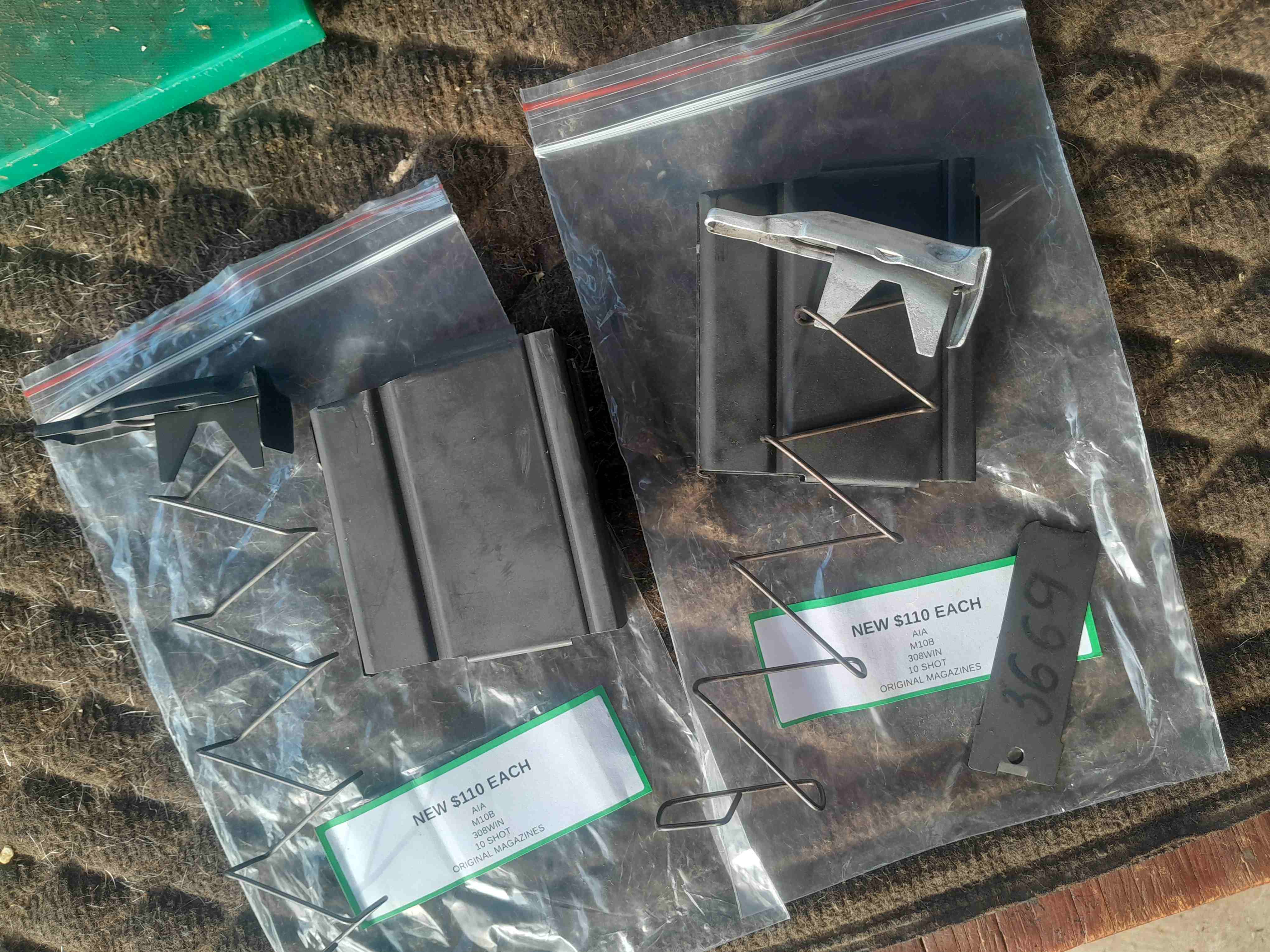

I show a couple of examples as I just got a delivery of some more magazines here.
Above is an AIA 10-shot double stack mag in 308. Coincidentally these are the same as M14 mags, and the makers of AIA modern Lee-Enfield copies use the much better M14 mags, what these are.

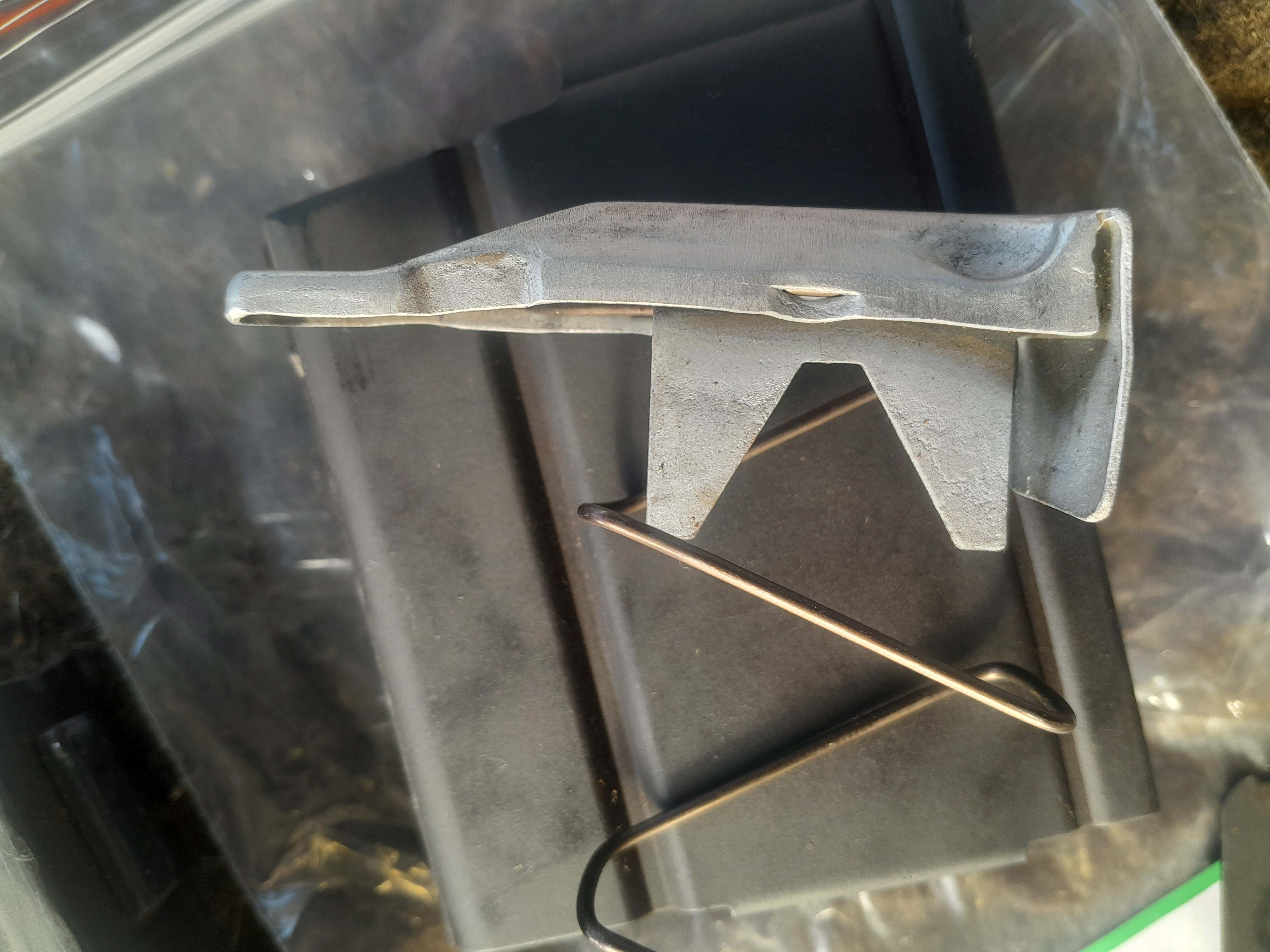

Now these hold 10 rounds, but the 10th one is hard to pop in, and certainly you need a hammer just about to get them in, unless you only load 9 cartridges in. can you see the capacity limiter underneath the floorplate? These two tabs bottom out on the mag base when full, and don't allow the 10th round to be pushed down enough when seated on a closed bolt.

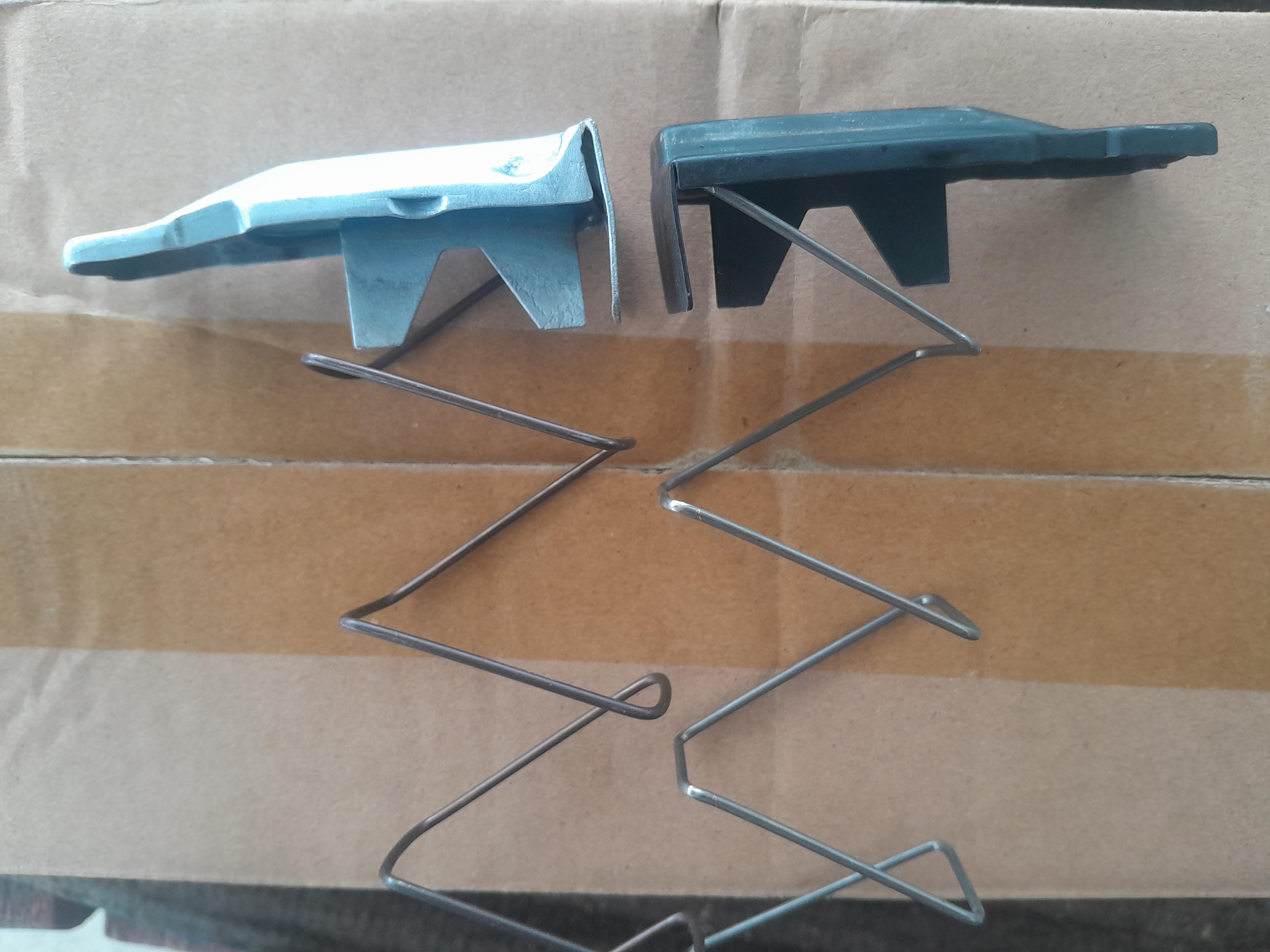

Above is a close-up. What we want to do is grind these two tabs down to the same level as the rear folded-down guide behind them. We don't want to take anything off the back of the floorplate because this stops the follower from tilting and possibly causing the floorplate to stick.
Obviously, but just a mention, is to unclip the mag spring before doing this.
Above is the job done. You can see that the two depth-limiting tabs are ground down to match the length of the rear guide. the rear guide has not been touched.
This now allows the full mag of 10 rounds to have easily enough extra travel to clip into a closed bolt rifle without any force and works perfectly.

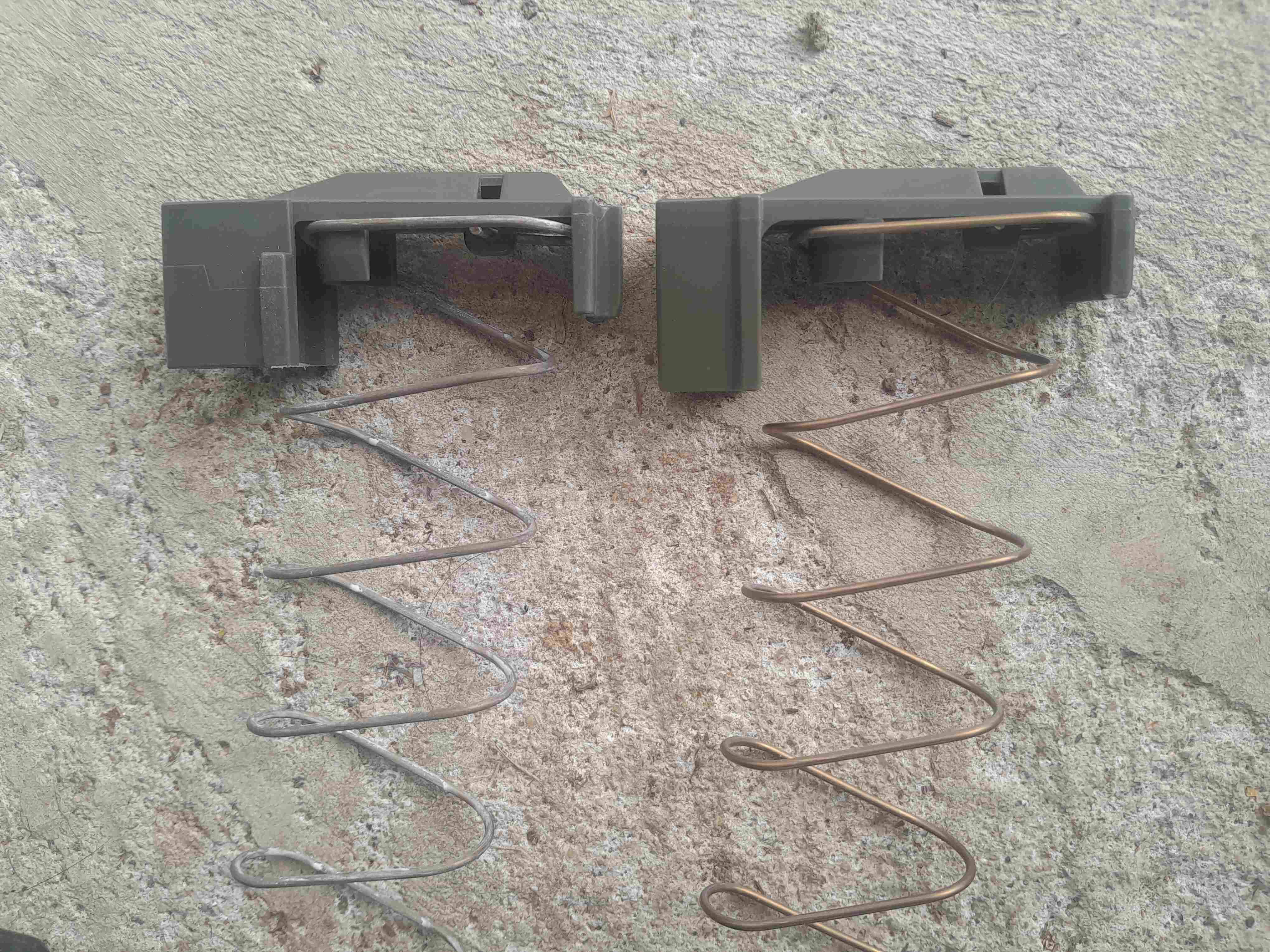

So here's the mod to some P-Mags.
In this instance, these are 308 versions, but the smaller 223 ones are just the same.

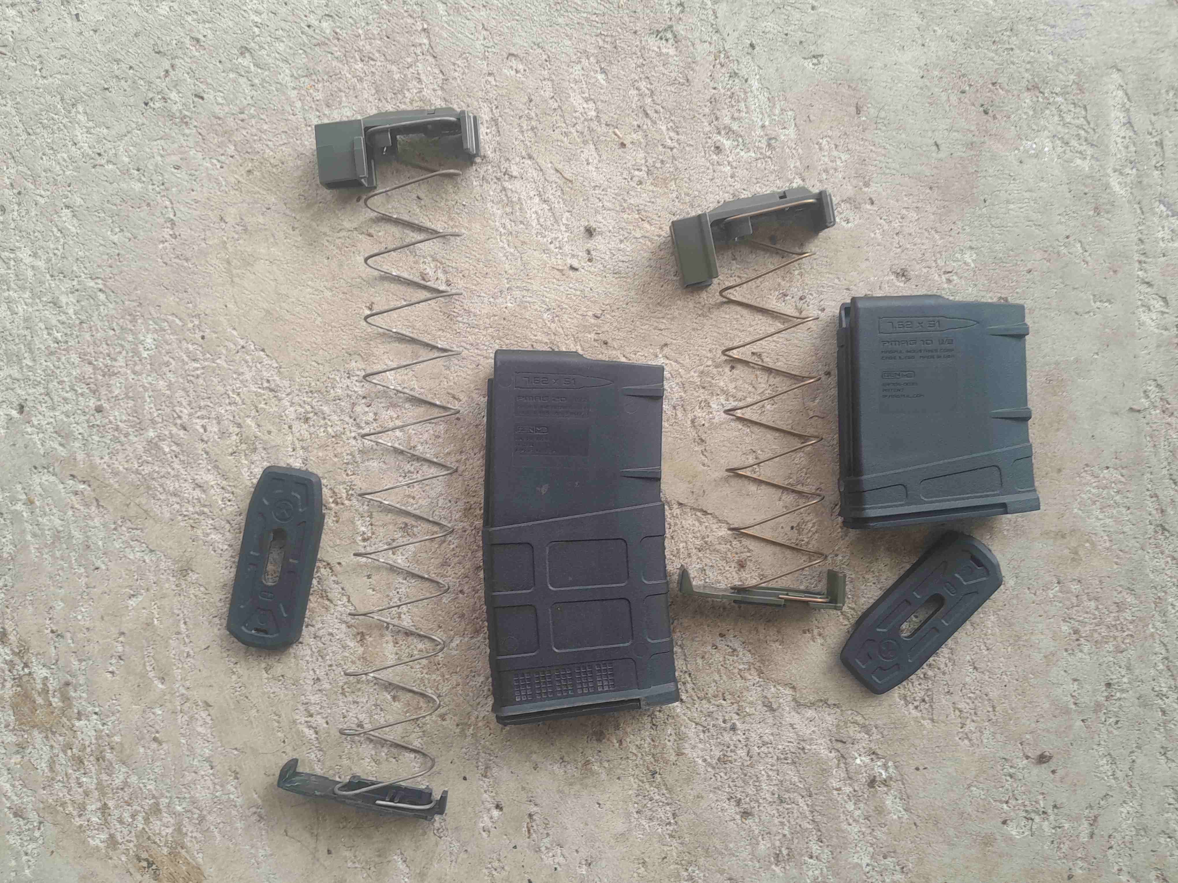

Above are two disassembled. On the left is a 20-shot Cat D mag, with the follower already shortened. On the right is a 10-shot version for those without a Cat D license or firearm, with the follower unmodified - as it is from the factory.
In an autoloader, I can't clip these in with the stated capacity of cartridges, i.e. 10 or 20 rounds, unless I run around with the bolt locked open. NOT a good idea in the dust and sh*t that blows everywhere, and unsafe. I travel with a loaded mag, but NOTHING in the chamber.
The safety comes on after a round is fired and is only on whilst the rifle is unloaded before moving on.
Above is a close-up of the two followers. The 20-shot one has had 6-7mm sanded/ground off it. NOT enough to cause the follower to jam as it slides up and down in use, but enough for the full mag to push the top cartridge down enough to easily and securely clip in and load when needed safely.
Don't take off any more material than that.
Or try and take so much off to get an extra cartridge in. You'll crush the mag spring.
For other magazine designs, disassemble the mag as you would for cleaning every few years or so and see if this is an option for you.
Hope this helps for those of you who wondered about this or see the need for it.
