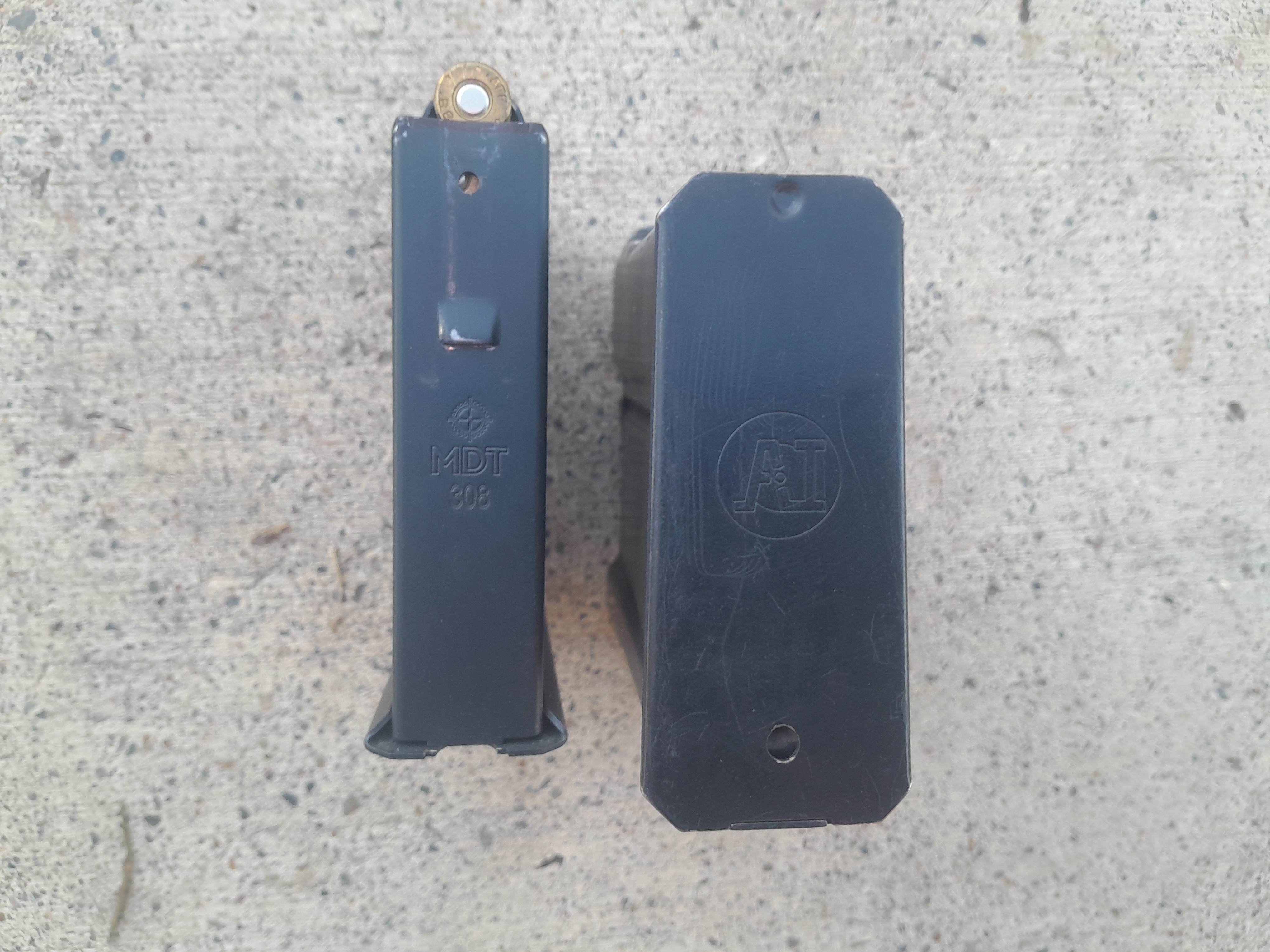

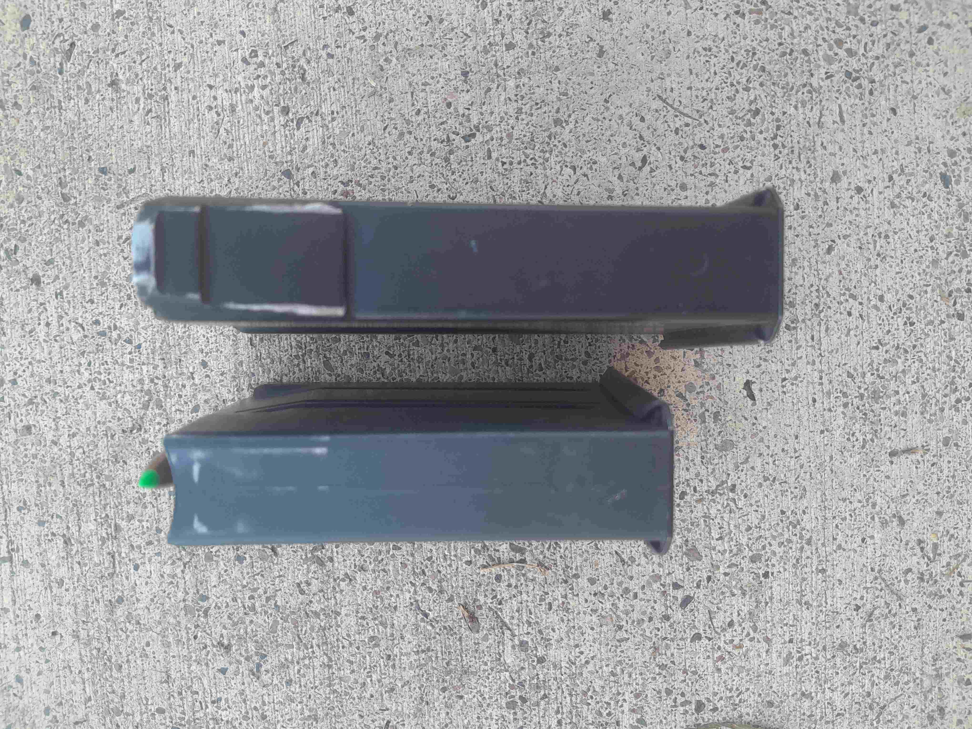

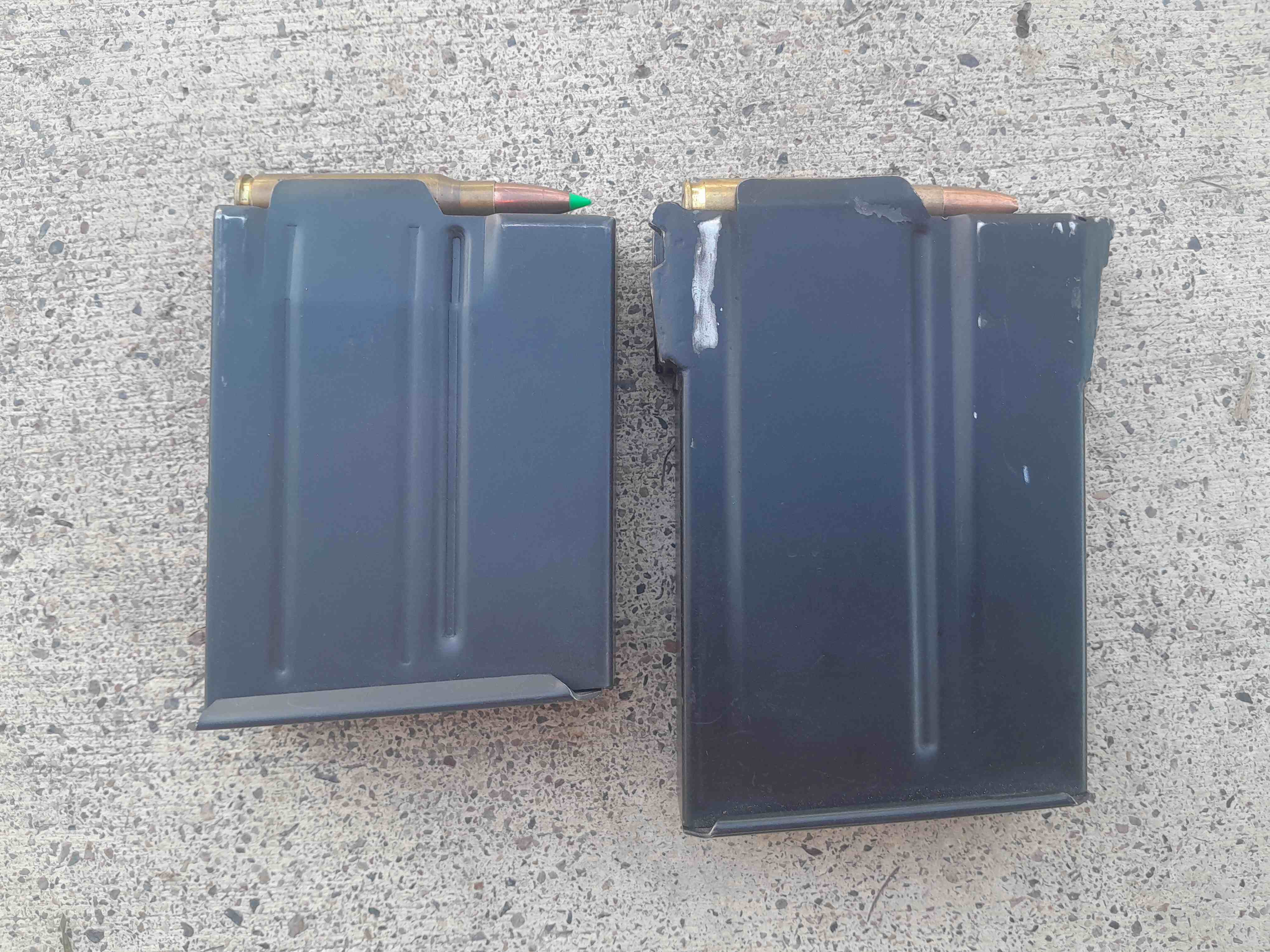

For those interested, the latest version of the MDT 10-shot AICS-fit mags are streets ahead of the Accuracy International so-called "Rolls-Royce" of magazines.
The mag on the left is the newer, double-stack 10-shot MDT, and the right is an original AI 10-shot mag. Ignore the steel blocks tigged front and back, these make them fit my 308 7600 pump action rifle.
The difference in length and width is marked, the Canadian MDT is evolutionarily advanced in comparison.
Both have had the followers modded to easily get 10 cartridges in and clip easily into a rifle with a closed bolt.
How these MDT mags have stepped up the original design is marked.

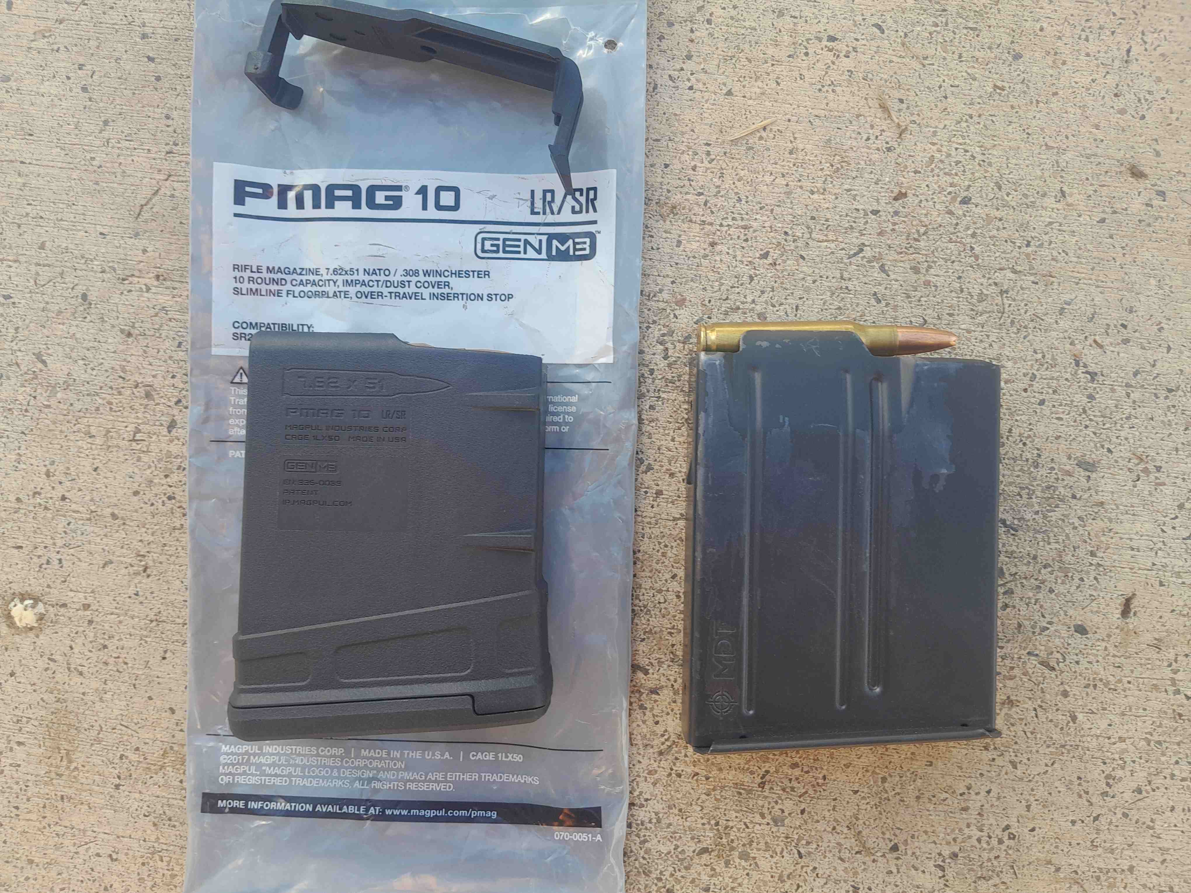

Pmag vs latest MDT AICS versions. The fact they've got these single-feed mags virtually as short as the P-mag for the SR25-type rifles is just a great advancement.
Check out the Cerakote on the MDT all scratching off from use. This coating is just hyped up spraypaint, doesn't last out here very well.
