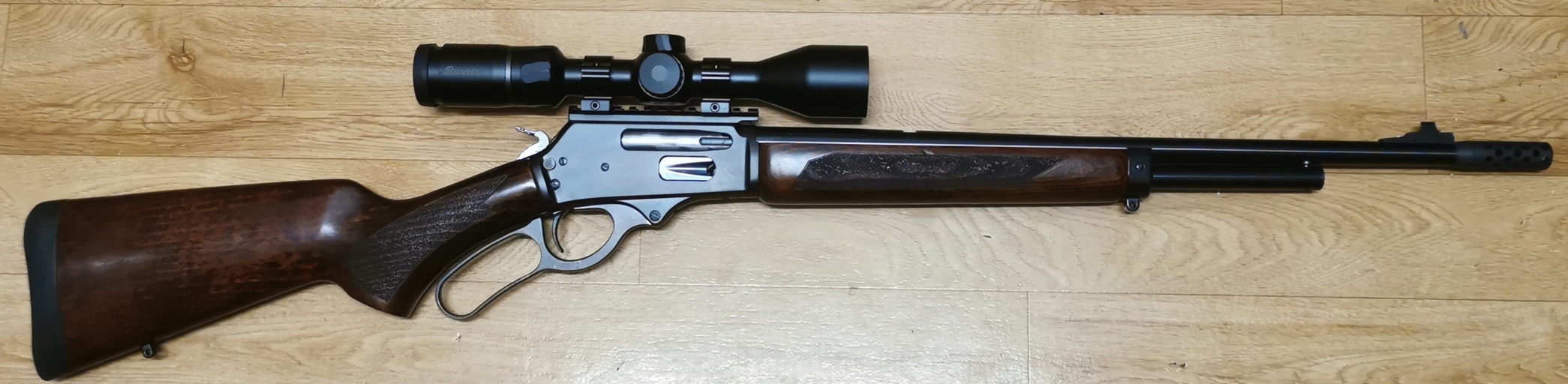

Been playing with some loads for my Rossi R95 lever over the last few months.
It's the classic 20inch version.
5 shot mag + 1.
It's fun to shoot, but it groups like buck shot would at 100yds, so not really something to chase deer with.
Lucky to have 5 on over an 8 inch target.
I nearly sold it, but thought I'd just modify it to look like some Armageddon gun.

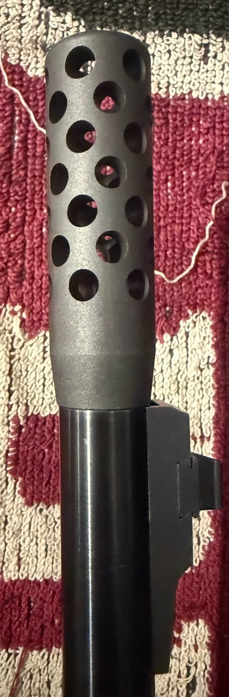

I had the barrel threaded and fitted a grizzly radial brake.
When the brake arrive i saw that it wasn't shiny bluing and I thought I'd stuffed up. Instead the bluing is a matt finish, which when fitted to the rifle actually matches the action, so while the bluing on the barrel is shiny the brake and action are matt.
I stopped the mods there because I like the look of it. Gives it a modern touch to a western looking classic.
