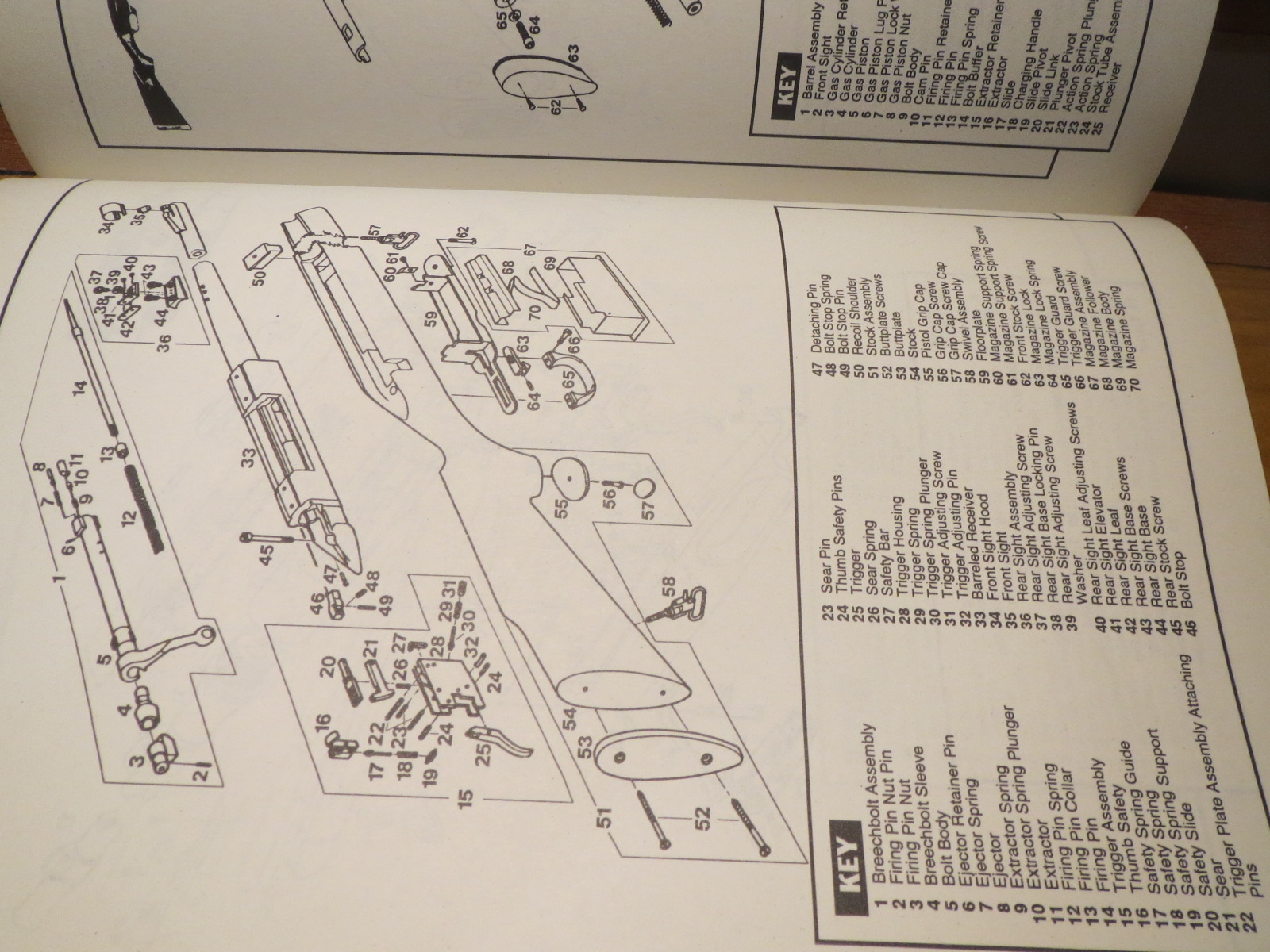

Do you really NEED to? Or is this just a fancy to see and clean? I ask because it is easy to disassemble but not so easy to reassemble, requiring the firing pin spring to be compressed and then turned after compression. If you actually need to do this then look up Ithaca LSA 65 bolt disassembly, the tool to reassemble can be made simply from a block of hardwood with a hole for the cocking piece and a slot for the sear (looks like a keyhole) and you assemble the bolt upside down ie: cocking piece in the hole with firing pin pointing up, push body down over the assembly and twist. There were instructions on the sakocollectors forum a few years back. I will post an exploded view of the rifle shortly, take me a few minutes to find it.

Ithaca, and book it came from.
