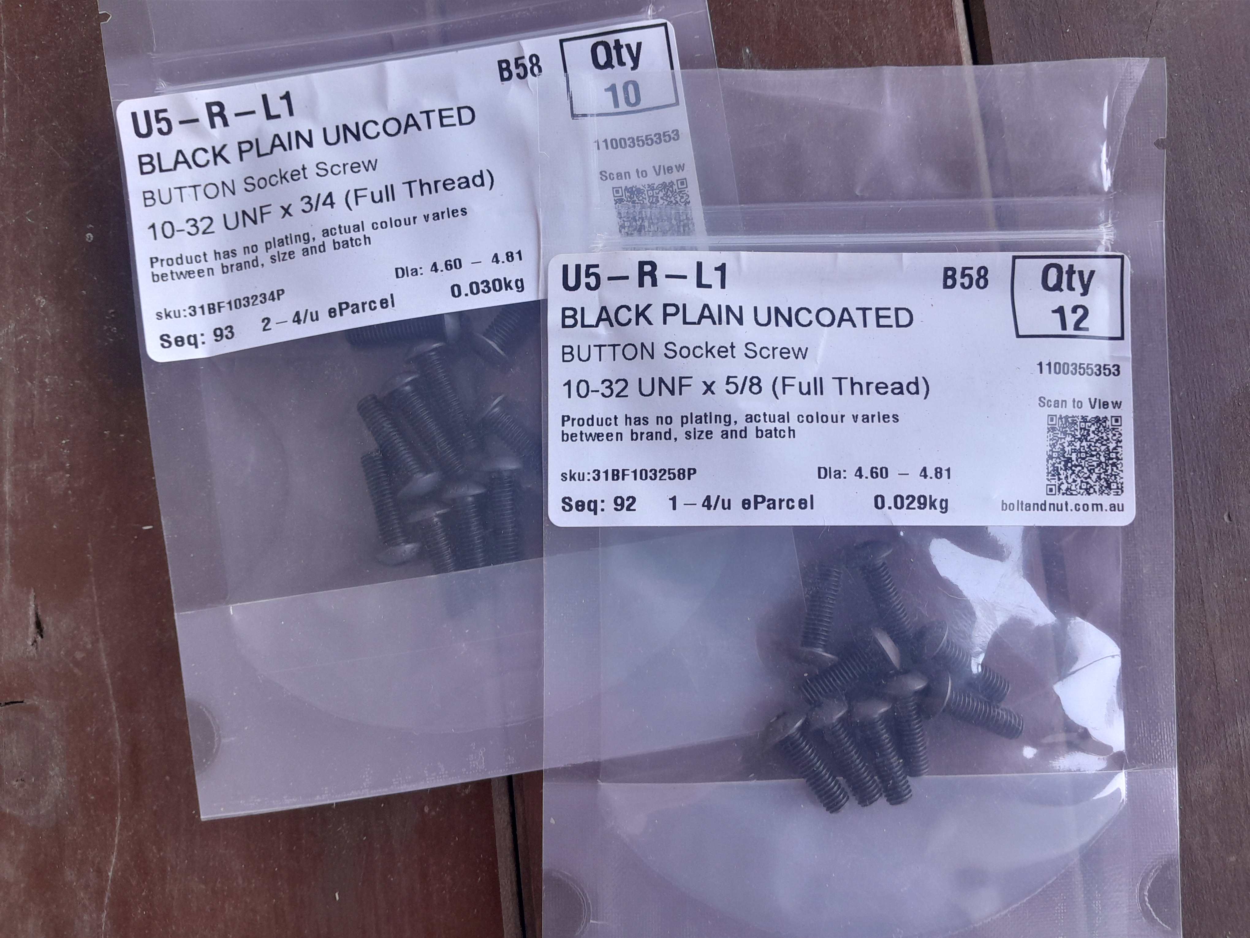

I was buying some strange fasteners from an industrial bolt supplier I used to use in the workshops, for weird stuff nobody else carried. Strange US threads, gunsmiths would know what I mean.
https://www.boltandnut.com.au/

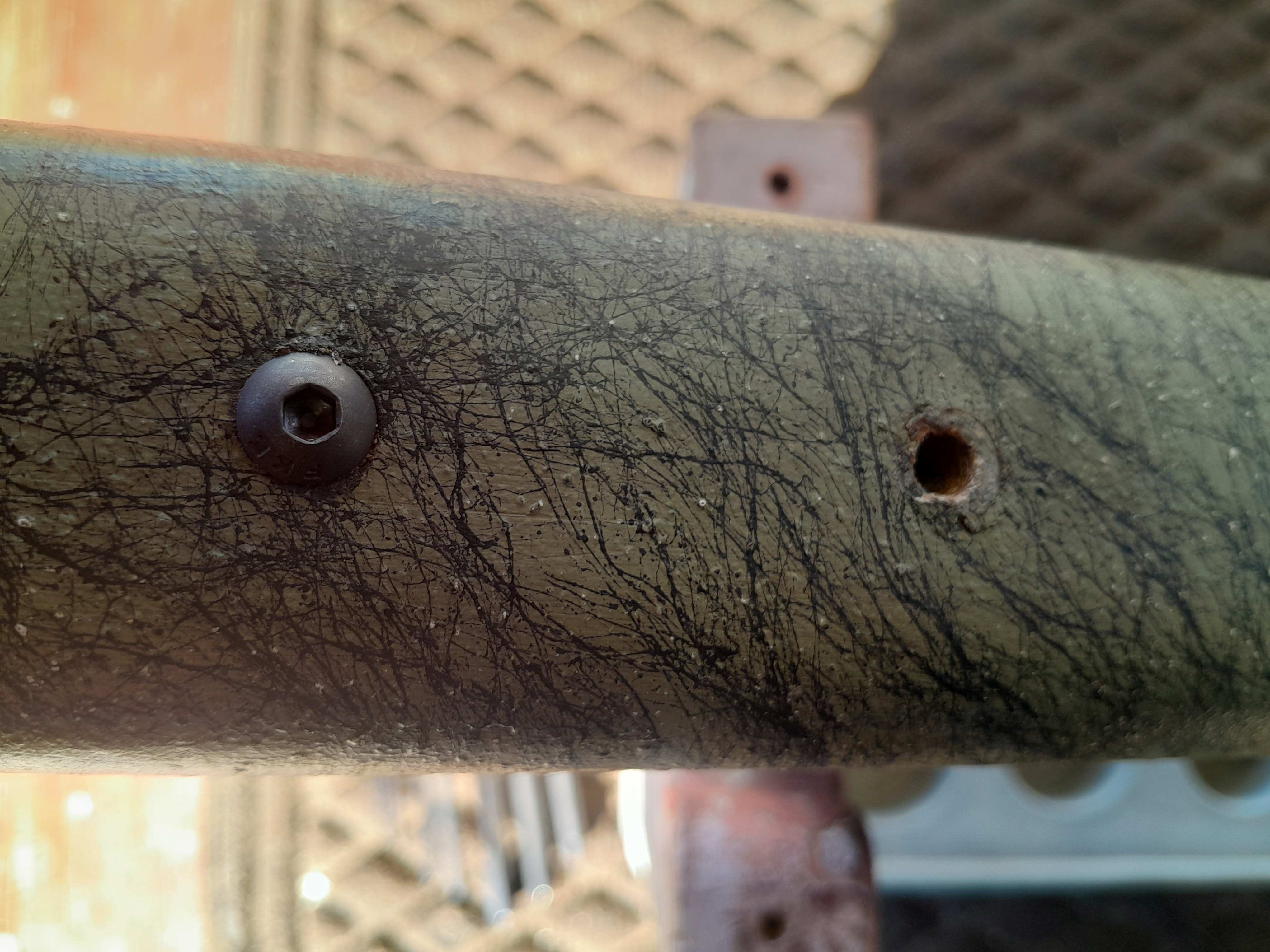

Anyway I bought some button-head high-tensile screws to fill the holes, to keep the crap out. And secondarily, these hard screws clean out the loctite that the originals had to stop them spinning - a fault in that design.
Came out quite good, and clears the slots in bags and glides over padded rests from the buggy or ute.
Sure, I could've done nothing, but I can't stand unfinished looks, it's lazy.
A screw in place, and the second hole the way it looked after the swivel stud came out. Looked unfinished and unprofessional.
The screws as they come.jpg (682.8 KiB) Viewed 47 times

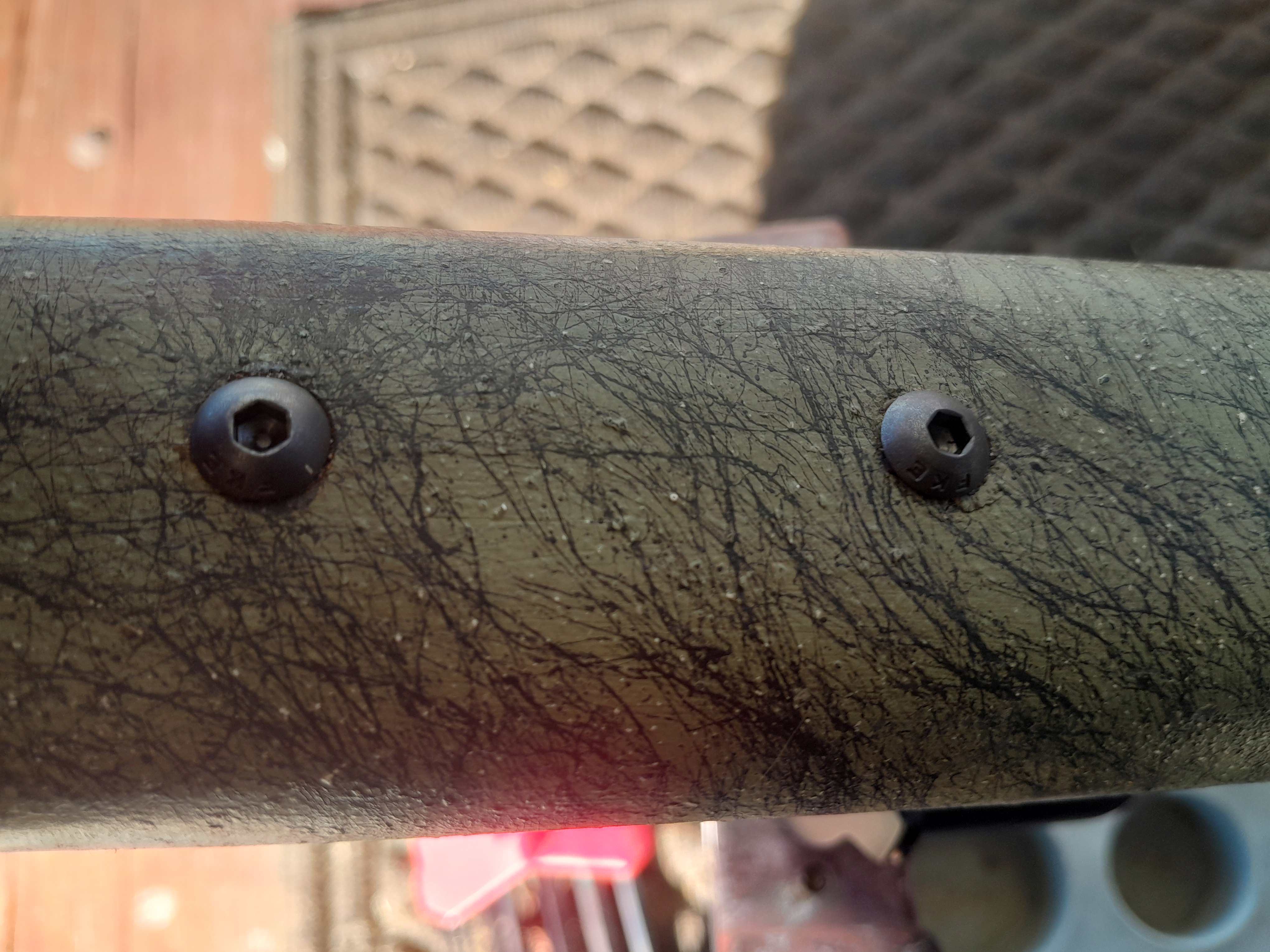

Both fitted. I also did the one at the butt.
fitted forend studs.jpg (680.54 KiB) Viewed 46 times

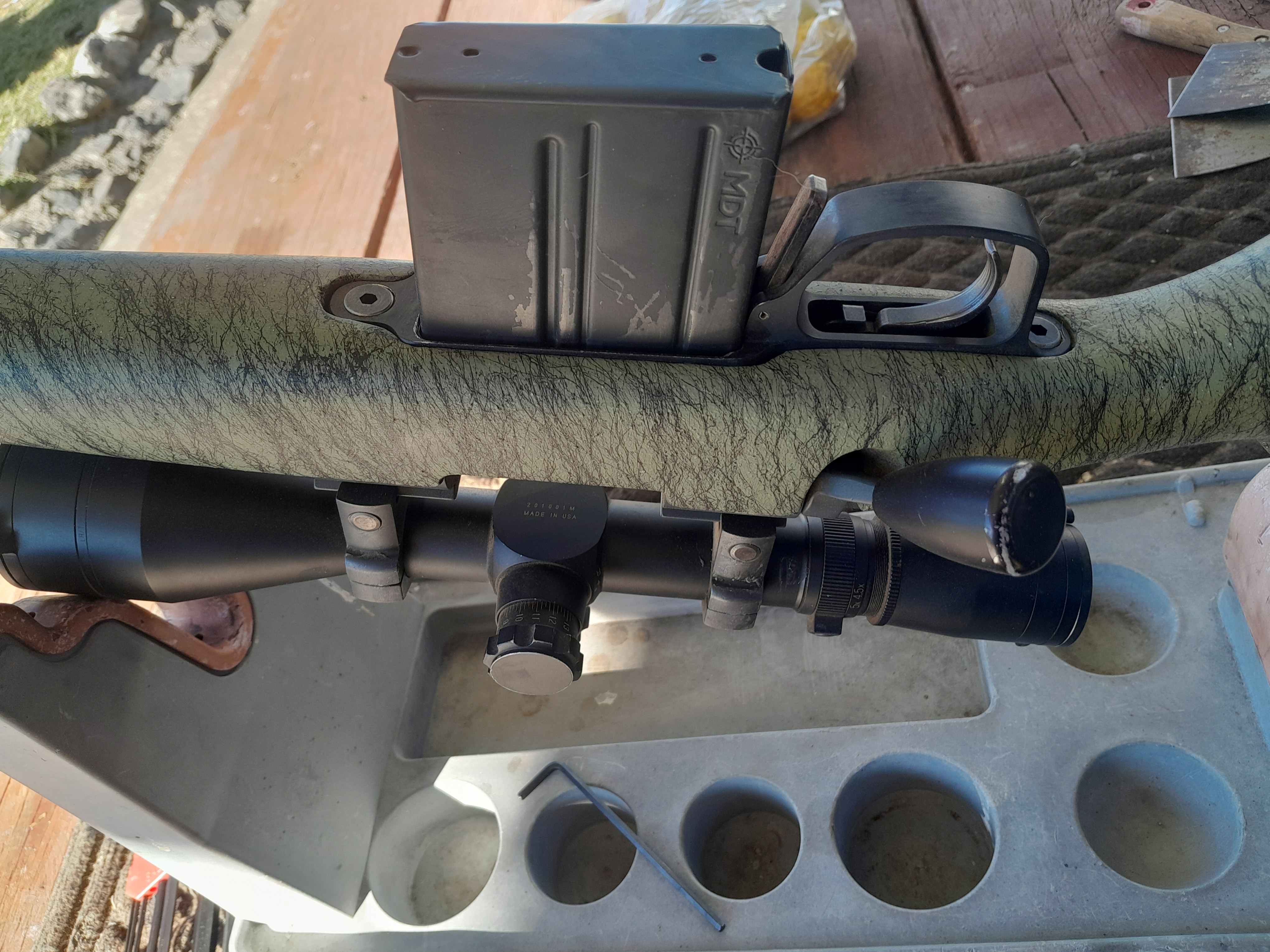

While I was at it, I got two 1/4" UNF countersunk grade-12 screws to replace the mashed ones that hold the M5-pattern old floorplate in.
If you had a Howa, or a European rifle, it would be M6x1.
I had to spin them in the lathe tom make them a smidgeon smaller to fit the countersink in the floorplate, but a handy dude could use a drill to chuck them in and a file a they spin.
I didn't bother blueing the edges.
Action screws1-4UNF-CS.jpg (691.49 KiB) Viewed 46 times

Now, the threads that swing swivel studs use is 10-32 UNF. I ended up using the 5/8" long ones and they go into the forend aluminium bedding block as it is tapped for them. A very strong set-up.
The aluminium goes from up at the forend, the action beds in the V-block machined section, and continues to the rear sling stud, permanently moulded into the HS-Precision stock.
Even though this one is marked "Remington" on the recoil pad, because this stock was fitted from the factory. But any conventional stock, as long as it is a machine-screw and not a wood-screw type threaded stud (eeeech) uses the 10-32 threads.
A good time to maybe stock up on the awful 6-48 and 8-40 screws used to hold scope bases down in that afterthought piece of engineering design.
Check that place out for strange fasteners, there's even a fastener finder there to work out weird threads - it works great
AND - I placed this order on Wednesday morning out here at the farm 400km from Brisbane, and they were in my letterbox Friday, post is included in the price. They post EVERY afternoon.
