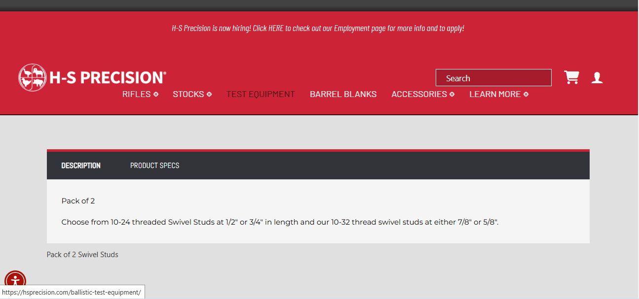

Post by straightshooter » 02 Aug 2026, 8:02 pm
https://hsprecision.com/product/swivel-studs-pack-of-2/
HS Precision.png (44.52 KiB) Viewed 17 times
I notice reading and comprehension isn't one of your premier skills but at least look at the screen grab, HS Precision being the supplier of the stock to Remington.
