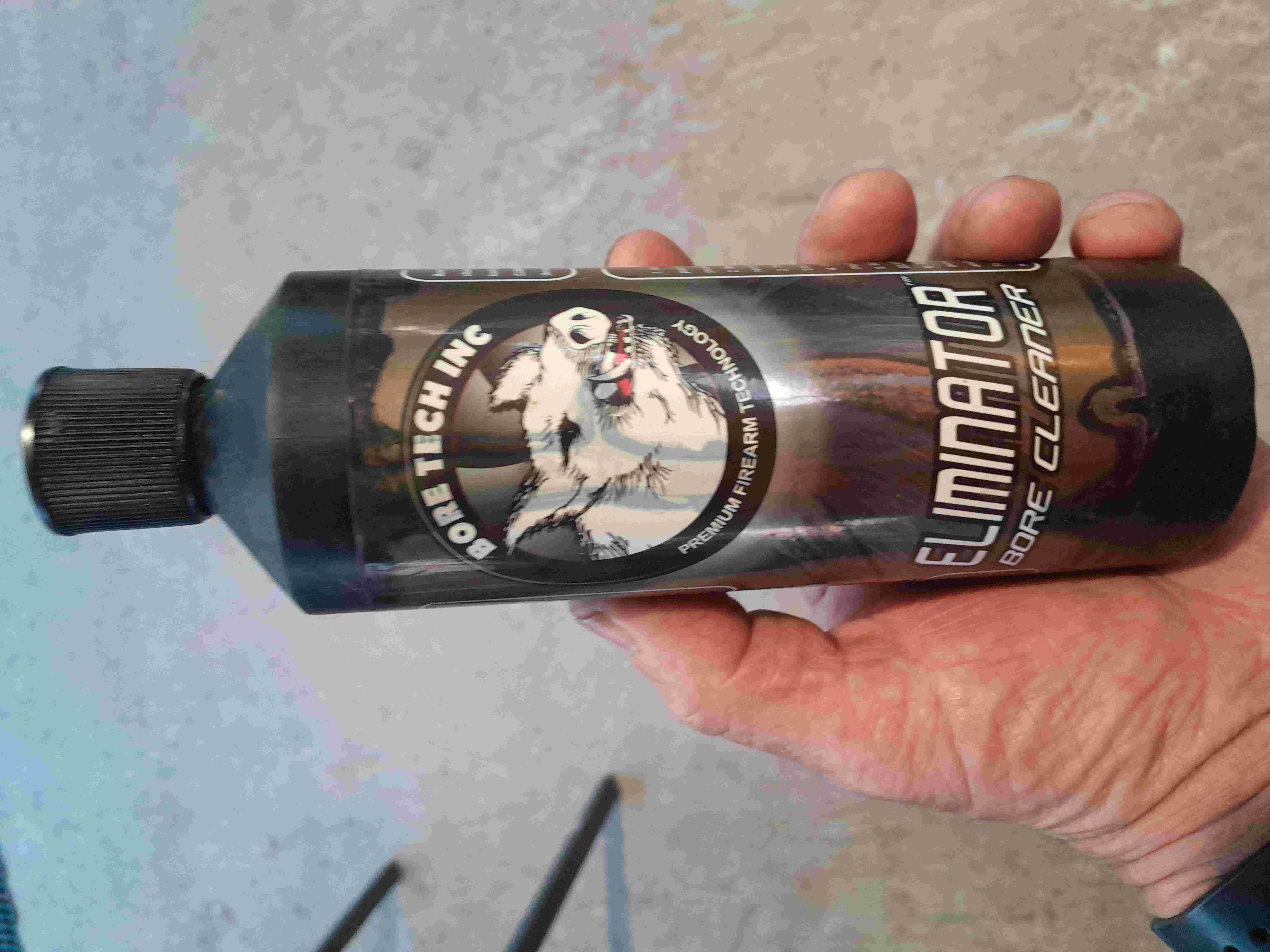

Is that the Eliminator with the pigs head on the label?
I bought a bottle of that sh*t after listening to a gunshop bloke who probably never used it, and did my own trick with the Hoppes I always use, and left some in the bore to work overnight as the instructions said.
On the steel 6mm plate-topped workbench, there were a few drips, next morning they were orange rust patches !!!!
The bottle said I could use it to protect the bore!
If you're using that, I know why your chamber rusted.
Re: how to remove rust from chamber shoulder
Post by Wapiti » 09 Oct 2026, 6:13 pm
This sh*t
I freaked and immediately patched out the rifle I'd used it on, a $10K DTA SRS - and it had already started turning to rust in the bore. Luckily, no damage but if I left that Devils p*ss in there, the rifle would've been f**ked.
I'm sure there will be some that say "I've used that since my first born and nothing's happened like that" well I will never use that sh*t again. In fact, what a wanker I am for not chucking it already. It's kept for times like this.

Post by Wapiti » 10 Oct 2026, 7:31 am
Hopefully the others reading this take something from the discussions above, that is
I have used that Eliminator, posted a pic as proof that I have the sh*t, and on guns I use quite a lot it does not work any better than the good old Hoppes9, and in fact Hoppes Black is way faster.
People do have to justify their purchases with whatever they need to use personally, I will look at the plus/minus and effectiveness.
Eliminator can destroy your rifle if you don't remove all traces of it - to me that's ridiculous, because on high round use semi-autos this stuff isn't any better for fouling removal- for my humble guns it's 2nd class. That's where the real good stuff shines.
None of those need to be white spirited out as precaution to rust, to me that's insane as the stuff aint that great. PLUS you can leave the Hoppes in as a preservative and it keeps working to remove the last stubborn deposits as you get on with life. If you have that time to do all those extra steps with the Boretech great but don't miss a bit in the corner of a chamber shoulder!
I don't deliberately set out to be hang my arse out and be different as an argument, I just don't want to see people wreck their gear because they believe the lies on a label and think they have the latest greatest when they do not - that's a tragedy to me. Good luck with your rifles fellas.

Post by Damo300 » 10 Oct 2026, 8:03 am
Wapiti wrote:Is that the Eliminator with the pigs head on the label?
A quick check of the SDS reveals that is just glycine and water.
The water would be the cause of you're rusting.
