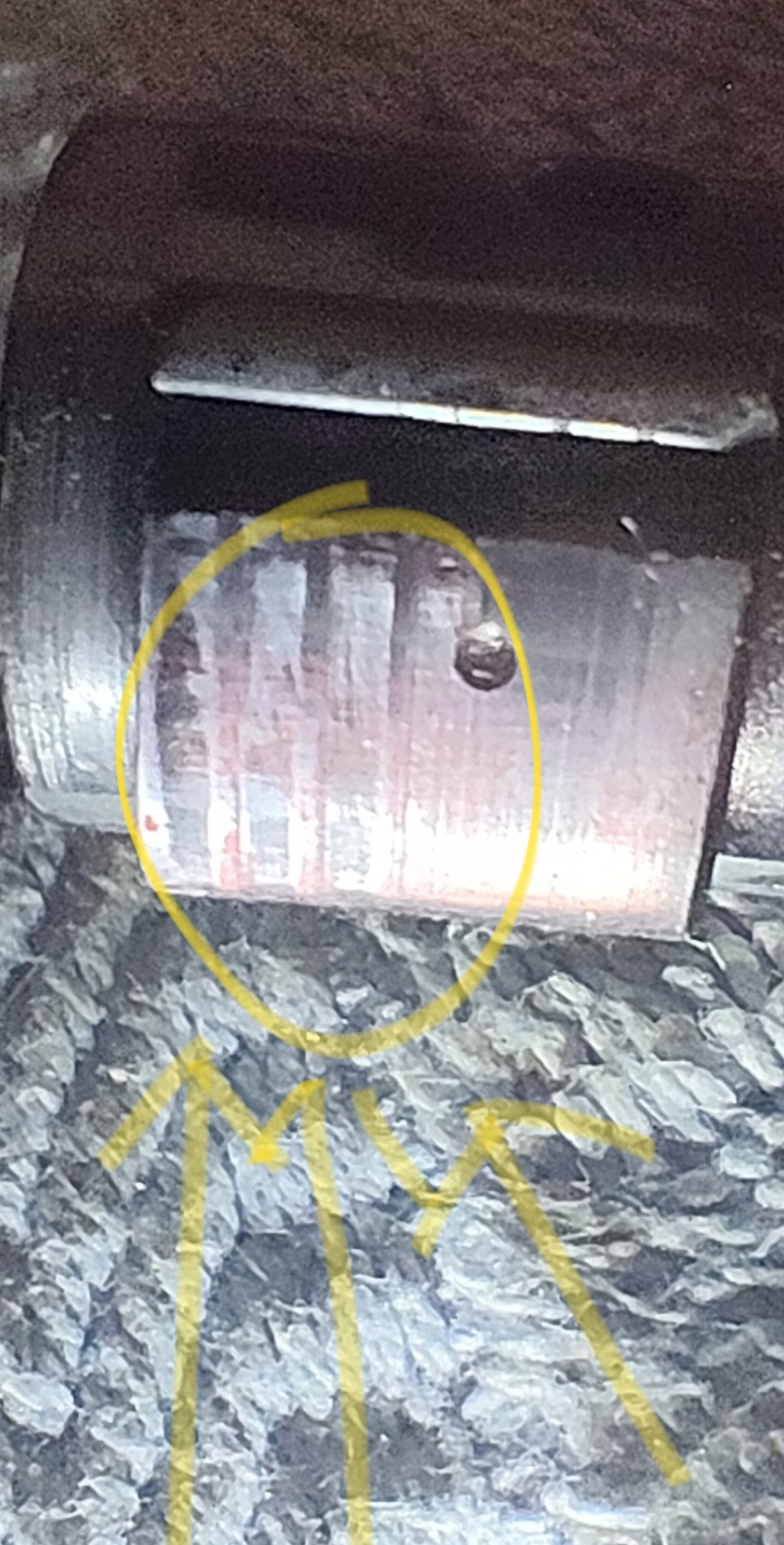

Post by FoxSpotter » 17 Jan 2026, 7:12 pm
I finally investigated contact wear marks of the right Lug of a rem700 b series that was supposed to be trued.
Most notable are three lines.
Can be seen on both the bolt and 3 threads in the action .
See pics.
I humbly assume...
A.
The action threads are point downwards...making the rear of the threads...bolt side, high.
B.
This may prevent the nose of the bolt from lowering when the rear of the bolt is pushed up by the trigger sear etc..
So.
Maybe this all works out for the best?
However... I suspect this might be costing me a bit of accuracy
A slight wearing can be felt on the lug...little grooves where it's contacting.

Re: R700 Lug Rub (outer)
Post by Wapiti » 17 Jan 2026, 8:22 pm
Trued?
I assume that the outside surface of one locking lug is contacting the inside of the action threads. Or am I looking at the pics wrong? Or why in the vid, you concentrated so much on those threads with your mirror?
Was another barrel fitted, or is this a "cleaned up" stock barrel?
Posts: 3024
Post by FoxSpotter » 17 Jan 2026, 10:16 pm
Yes...out lug has marks...and the pic inside shows the threads of the action where the lugs rubs on them.
It's a custom barrel...and..the action was paid to be trued.
The barrel itself should not be an issue..unless perhaps the nose of the bolt is contacting the barrel...I hadn't considered this...and don't think it's an issue.
I just wonder how unconcentric the bolt raceway and or the action threads are for this to happen.
And wonder what the effect of this contact might be..
Thanks for your interest.

Post by Wapiti » 18 Jan 2026, 10:22 am
OK mate, I'm NOT a gunsmith, but I've seen some TERRIBLE work from gunsmiths down on the coast...
My trade and my own stubborn demand that I do the best I can in my own expectation makes me quite keen in the eye though.
Chambering a rifle barrel and cutting the action thread is not a challenging task for a skilled machinist... scary first time though I'll admit.
OK, with that, I've dismantled and rebarrelled Rem 700's of my own, and used barrel blanks from MAB then TSE up here, and from the clearances inbuilt into that design, the ONLY way I can see that a locking lug on a Rem 700 bolt could ever touch the interior action threads is if the "trued" action threads, meaning supposedly cleaned up to the true centreline of the action, were done offset to the bolt raceway centreline.
Now that is only going to happen from a bodgy machinist job set-up. Or the apprentice. If there is such a thing in Australia anymore.
If some goose was to thread a new barrel offset, forcing the nose of the bolt sideways into the side of the action, that may also be the case but when closing the bolt it would really "feel" this happening.
The nose of the bolt would then also show wear on it, but I can't see that being the issue myself.
Post by Wapiti » 19 Jan 2026, 6:59 am
I actually think that, if my explanation is what's happened, that action is now buggered.
But hey, I can't see the rifle so I may be wrong for sure.
As I said, if the barrel could be removed, the action stripped and both set up, clocked completely on centreline, the real culprit will be obvious by running dial indicators over both individually and the action thread pitch be accurately measured and also checked for on-centre.
I think the contact with the threads needs to be addressed though, it won't help with a nice, straight recoil path and therefore the most consistency in the rifle's performance.
If the rifle shoots OK, and it will be completely safe anyway, the only way to stop the contact from the lug against the action threads would be to disassemble the bolt, put it in a 4-jaw and skim a few thou off the outside of the lugs to stop the contact. And re-blue.
This will not in any way, take material off that makes the lock-up any weaker.

Post by Wapiti » 02 Feb 2026, 9:53 am
FoxSpotter wrote:...and ...skim a bit off...problem solved... maybe..but...not the source of the problem.
I noticed on another r700 both a slight wear marl onnoutosee of lug...I dared not further investigate
Mate, I'm a R700 fan, and have had many of these rifles, and still do. As have mates of mine who'll pay that little bit extra for a great working rifle.
I've never seen locking lugs or a bolt nose that misaligned to rub on the inside of the action, on anything.
You gotta PM me who's done that work.

Post by straightshooter » 03 Feb 2026, 8:26 am
Despite the poor photography it seems fairly apparent that the bore in the barrel is offset in relation to the central axis of the barrel.
I come to that conclusion because I doubt whether a receiver with that amount of offset would have left the factory
From the rub marks on the bolt nose one can see that the chamber counterbore is forcing the bolt into alignment far enough to cause the rub marks on the lug.
If the rifle shoots acceptably then stop whingeing.
If it doesn't then a new barrel is required, fitted and chambered by somebody who is a bit more diligent than whoever did your current barrel.
How about giving the receiver internals a good clean. Looks pretty grubby to me.

Post by FoxSpotter » 11 Oct 2026, 9:51 pm
It's a custom barrel and action should be trued.
It's shoots "ok"...I am a bit whinging...but I've had a custom barrel on an untrued 788 that shoots much much better, ...and seems apparent to me it hasn't been trued.
I do expect and require fine longer range a curacy for work...so...I like to maximise rifle accuracy

Post by FoxSpotter » 11 Oct 2026, 9:59 pm
@straightshooter, I'm more inclined to think that the bolt is poorly aligned to the action threads/action face and is rubbing on the internal action threads.
Sorry for the poor photography.
May make a clearer video and post on YouTube.
I'm surprised it could leave the factory in that way too. B series rem 700.

Post by FoxSpotter » 11 Oct 2026, 10:14 pm
Hopefully this pic shows the rub lines.
They can be felt with a finger.
Lower / rhs lug.
Thread rubbing on outer bolt lug the/lower

Post by bigrich » 12 Oct 2026, 4:38 am
hmmm, there's a few things looking not right with this rifle . i'd find another gunsmith . i had some really poor, dodgy, dangerous work from a smith/barrel maker up my way . i won't touch anything they've worked on or a rifle with one of their barrels . i have a 1980 build rem 700 i had rebarreled with a madco barrel in 222 that's fantastic . i also ordered a new rem 700 in 270 a few years ago . supposed to be built under the new ruger management, but i suspect it was old stock from the previous company . it had a very obvious line in the stock where the machine spraying the stock stain had run out . fair enough, that's cosmetic , but still, you pay for a new CDL rem you expect a quality gun . the gun shot just okay , had slight marking like your bolt lugs but not as bad . the big telling mark was the "half moon" on the bolt face . only half of the cartridge contacted the bolt face . barrel and chamber weren't true to the receiver and bolt face , I wasn't happy . tried to get it fixed under warranty, but the supplier to the gun shop wasn't interested . sold it and swore i wouldn't buy a new remington again . i'd happily buy a older one and build what i want though . i'd get another smith to check your rifle , as it seems things aren't true and aligned as they should be
Posts: 6616
Post by FoxSpotter » 12 Oct 2026, 6:04 am
I am planning on sending back when I receive another rem 700 from them that is to be trued and all from them. And perhaps once I've finished shooting loaded ammo. What will happen then is a mystery. I may well pull the barrel and measure the tenon for indication that it has been trued...I suspect they haven't touched it.

Post by Wapiti » 12 Oct 2026, 6:48 am
If you can pull the barrel FoxSpotter, can you set both up in a lathe individually? 4-jaw chuck, no 3-jaw. Clocked dead straight off centre and then run an indicator inside the chamber to check centre is .0000? At the same time, check the barrel shoulder is also square to centreline?
I would also get the muzzle end true sticking out of the headstock with a spider and a ground stud slipped in the bore to run the indicator on back there as well.
You might not see any indication of machining prior, because the barrel bottoming on the receiver will make it's own contact marks from bottoming against the receiver.
Hopefully they used neverseize paste or similar on the threads to minimise contact marks.
The receiver too, although to check square it must be set up on the inner bolt raceway, not from the external.
You will find something is nasty here, a bolt lug touching one side only is an error somewhere. The numbers won't lie.

Post by FoxSpotter » 12 Oct 2026, 7:56 am
https://youtu.be/aBgBVo7JMB4?si=HxcgBzGva4x3l-L3
My new video ... hopefully of better quality than previous...but still...my action has not been sanitised...even saw a hair in there .
Red texta can be seen on the receiver threads.
Uneven bolt lug contact was found...upper lug well shiny, lower lug hardly touching.
May further investigate outer/side bolt nose rubbing..perhaps on the barrel...
Thanks for ideas.

Post by Fester » 12 Oct 2026, 8:44 am
Not good enough, is it.
A bloke can just buy a Howa and get a shooter, despite the slightly uneven wear marks on bolt lugs and stuff.
If you pay big money to get re-barrel jobs done, you expect top toolmaker-type machining quality; it's why you paid the big bucks. You could have just bought a Howa otherwise.
