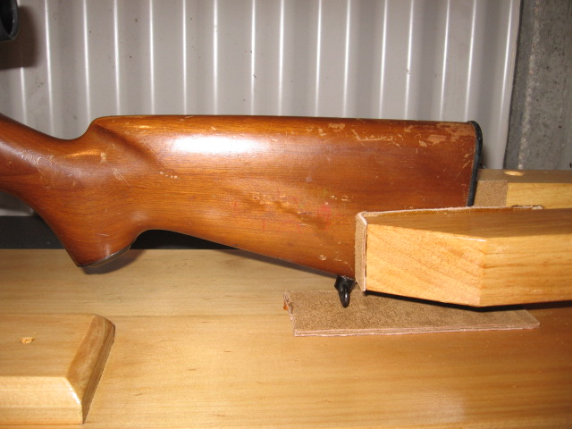

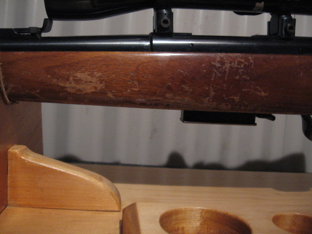

Hello all,
I have been getting back into shooting this year, and have just joined the Forum. I was hoping to receive advice from members on refurbishing the timber stock of a Sportco 33S .222 Rem.
The rifle belonged to my late uncle, and the stock is a bit beaten up. I am unsure of the type of timber the stock is made of, and it appears to have a hard varnish/polyurethane coating that is failing (my father believes his brother acquired the rifle in the early/mid '70s). FWIW, I've attached a couple of images of the rifle.
I plan to strip the coating off the timber stock and finish with oil. I was thinking of using boiled linseed oil (many coats), pure tung oil or something like Tru-Oil. Does anyone have any experience with these? Also, it seems difficult to find "pure" boiled linseed oil that doesn't have thinners, heavy metals, hardening agents or other oils added to it.
Any advice would be appreciated.

Try oven cleaner to loosen the old coating and leach out oil and crud. Wash off under running warm water while scrubbing with steel wool. Re oil with Birchwood Casey's Tru Oil system. That stuff is GREAT!

Looks like a polyurethane coat. So just sand back and progress to a finer grit. Then a couple of coats of boiled linseed oil and using oooo steel wool between coats. Then follow up with tru-oil and again oooo steel wool between coats use a lint free cloth with tru-oil and take your time. Good thing with tru-oil it wont yellow over time and is easy to repair if dinged or scratched.

G'day Dazey. +1 for oven cleaner to remove the old finish. Another option for the new finish I recommend is staining the wood with walnut finish and sealing it with a bee's wax furniture polish. Comes up a treat.

Coincidentaly, I am in the throes of re-finishing a stock too. I am using:-
Citristrip Stripping Gel to remove the old finish
CCL Gunstock Grain Sealer to fill the pores
Feast Watson Prooftint Walnut Stain in a 10% mix with Feast Watson Prooftint Colour Reducer. That stain is Very Strong.
CCL Conditioning Oil and a lambswool buffing pad on an electric drill clamped in a vice.
Only buffed in the first coat of oil so far and it is a bit patchy but there is plenty in the bottle. I followed CCL's instructions to the letter. You might want to lift the butt plate and seal the end grain before wet sanding the filler.
Never used oven cleaner but I would consider it for next time.

I have not long ago completely rejuvenated a 1960s .22 rifle, and used "Birchwood Casey Tru Oil" as the other members have also recommended.
If you want to see what sort of finish that can be achieved with Tru Oil, have a gander at the block of timber I am currently working on.

Post by COLLECTOR 1 » 12 Nov 2015, 8:37 am
Ok.........a bit about the rifle, the stock and what to do....
Sportco Mod 33, 222 rem, built in the 70's, front locking, box mag,,, they shoot well, what ever you do, don't loss the mag, ..lol... yours is the basic model, the "deluxe" had different timber, and chequering. Your timber will be probably be Australian coachwood, with a walnut type stain, and a varnish finish.
Best way to get it all clean is Selleys paint stripper, or the oven cleaner trick, WEAR GLOVES.....I normally take to the stock with fine steel wool at this stage to get rid of all the old finish whilst stripper applied... WEAR GLOVES... then wash it clean with warm soapy water. did I tell you to wear WEAR GLOVES,,,,,Leave it in a cool shady spot for a day or to, Not in the sun as you run the risk of stock warp. When dry dings can be steamed out quiet easily with a wet rag and hot iron, as the timber is not "hard wood" as such. Sand away any other imperfections, dents, scratches etc until everything looks nice and smooth.
You can put you a stain on it, like Cabot's or any of the other ones mentioned here, or products located at Bunning's., find the colour you like and follow the instructions. (I personally like Teak).....apply in sparingly amounts all over and leave it to soak in. I normally buff the timber after a day or so of the stain being applied with clean flannelette cloth. Repeat the process until desired depth of colour is reached. To easy......
Then Tru Oil, don't worry about any other sealant such as boiled linseed oil, very old school. This sounds silly but use your index finger to apply. If you use cloth it will leave lint fragments in the finish. Let it dry, lightly rub back with 0000 steel wool to fill the pours of the timber, and apply the Tru Oil again, I usually do 3 or 4 coats. If you want a "gloss finish" just leave it after the final coat and let it dry, If you want that "satin finish" rub ever so lightly with the steel wool on the final coat after the Tru Oil goes hard, Touch up using Tru Oil is so easy later on down the tracks if necessary.
Sit back and admire,,,, the old girl will look a million bucks.

You can also use products like Cabbotts deck clean on timber stocks. Give it a soak then scrub it with fine steel wool then a wash in hot, preferably boiling water and the timber comes up bright and clean.

Thanks for all the advice and information. It seems pretty straightforward to strip and clean: I'll use Citristrip and give the Tru-Oil system a go (and post an image of the finished product in the not-too-distant future).
