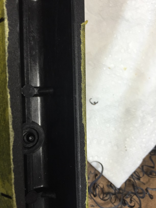

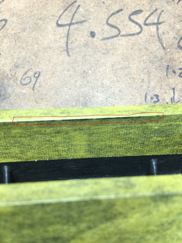

Funny enough after the earlier post I thought bugger it and headed into the workshop for some man therapy :) I used some very thin paper tape on the barrel and stock, coloured the barrel tape in with a black marker and refitted the action to the stock. A little pressure here and there and after removing the action I can now see exactly where contact is being made. Thankfully it's below the edge of the stock so I can massage the high spot with the Dremel and not worry about having any marks visible.

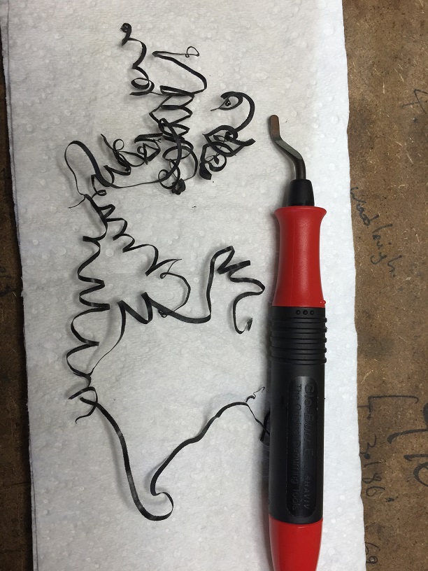

Post by brett1868 » 13 Jan 2016, 1:29 pm
Problem found, Solution identified and fix implemented :D
High Spot that was rubbing on barrel
A few passes to remove a little materiel and problem solved.
Sheet metal deburing tool = Perfect for this job
Disclaimer....No Gimp mask was worn or injured performing this work :)
