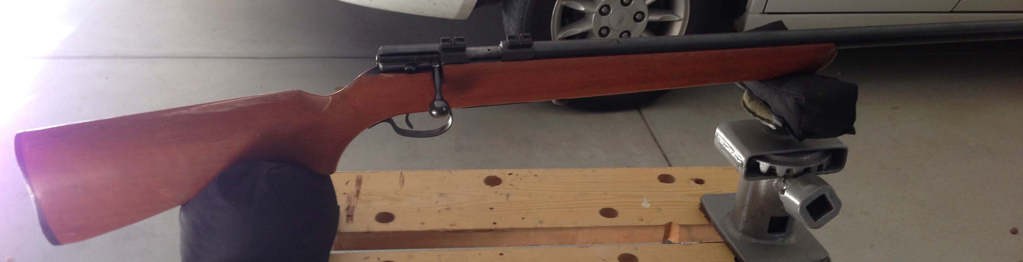

Post by DaleH » 06 Jan 2014, 10:20 am
Just an update guys,
I have inletted the stock and will test fir the coming weekend. I will bed the action after I have test fired the rifle as is.
Attached are the before and after photos prior to the stock being oiled.

Post by Humir » 06 Jan 2014, 10:42 am
Real nice mate.
Which boyds stock is that exactly?
Interesting looking grip and semi-heavy foregrip?

Post by reddog » 06 Jan 2014, 10:58 am
Good job mate , definitely looks a bit different to the Lithgow original.
Is that a modified Hills hoist you have for a front rest ? :D

Post by Tinked » 06 Jan 2014, 11:09 am
That's going to look awesome once it's oiled.

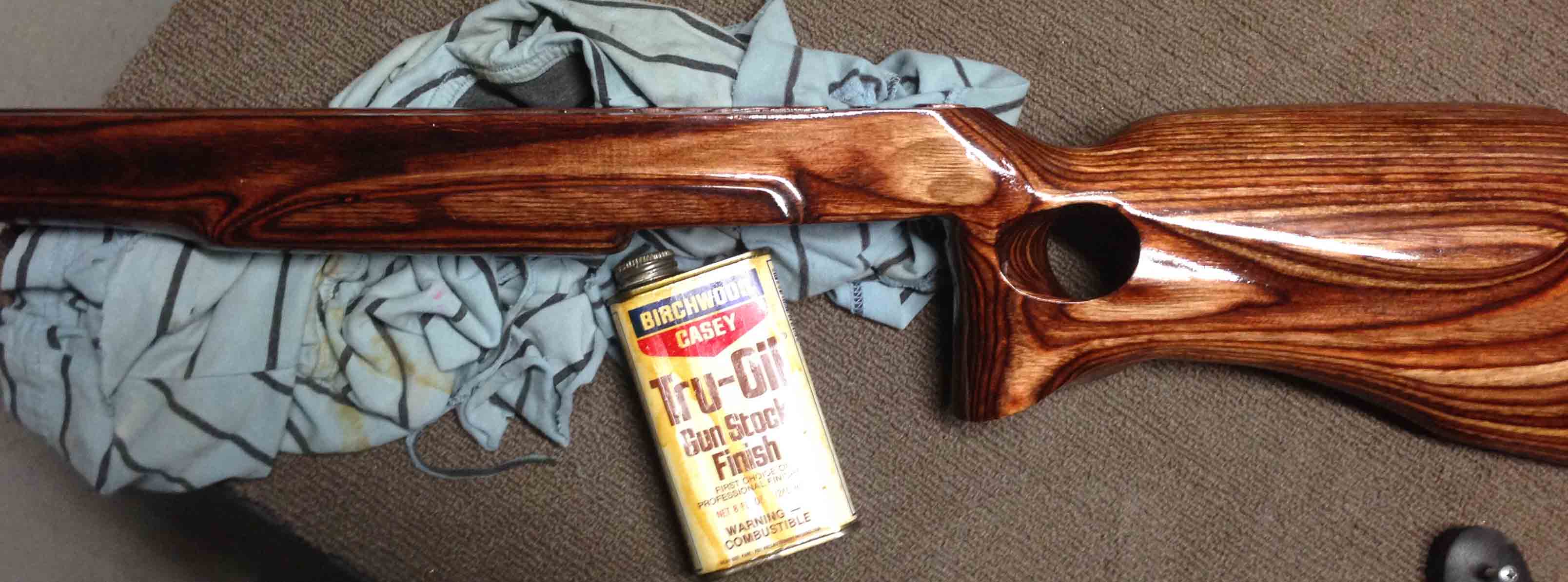

Post by DaleH » 06 Jan 2014, 12:55 pm
Hahaha - front rest is an old screw type car jack - nice and solid, adjustable and best of all - free.
The stock is a Boyds blaster - I purchased it as an unfinished stock so I could do the inletting for the lithgow - for some reason they don't do inletting for one......
Minor mods required to the stock was a removal of a hump at the rear of the receiver end (this is there to blend in with the receiver of the 10/22 they normally do these for i think ) and to cur out some of the meat around the trigger / magazine area as this area was very deep (~ 15 mm removed).
The trigger guard is a bit rough but will look better once painted black. The lithgow one wont fit so I made a two piece one out of some aluminium extrusion - actually some corrugated fins off a heat soak recovered from an old plasma TV - This will be a later day replacement job
Kids reckon it looks "like a real rifle" now.
Oiled stock half completed is below - another coat should do it - using Tru-oil which is easy to apply - only disappointment is that the timber came out a bit darker than I originally wanted but looks reasonable anyway.
oiled stock.jpg (188.69 KiB) Viewed 8415 times
DaleH

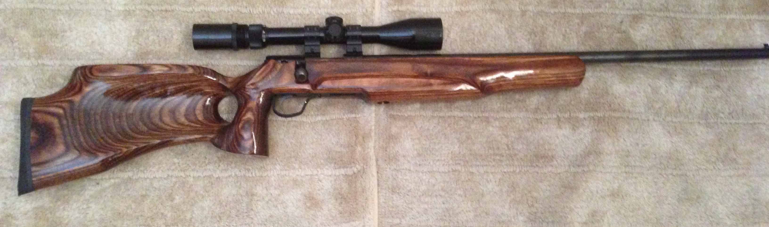

Post by DaleH » 07 Jan 2014, 10:06 am
Project update - I assembled the finished stock last night. Not bad for a 1950's rifle
finished 1.jpg (174.99 KiB) Viewed 8210 times
