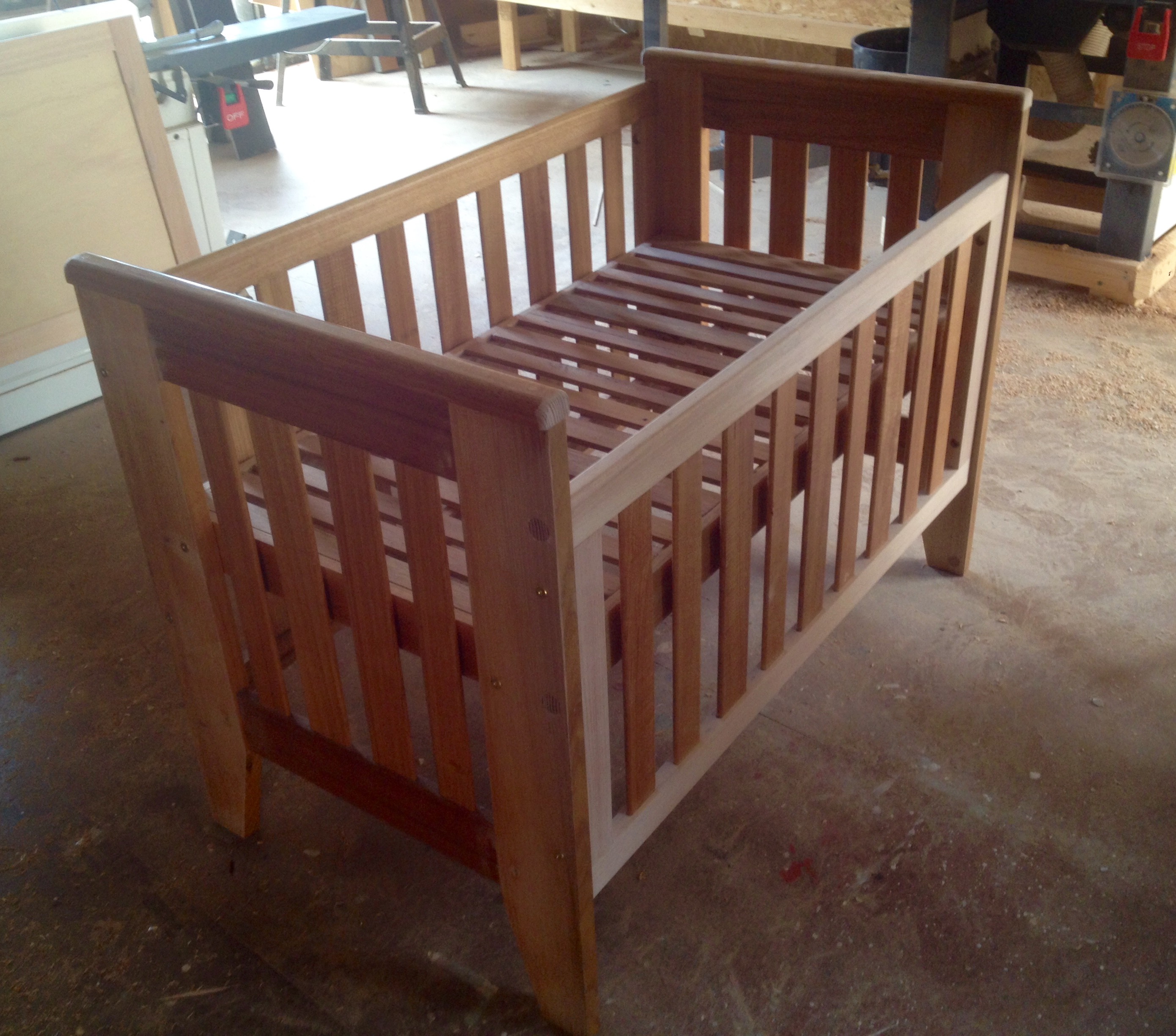

Here is a sample of my handy work in case you feel like I'm blowing smoke out of my butt.
I made this cot out of mesimate ( a type of eucalyptus) and recycled timber.
Let's share the knowledge gents
Ended up coating it in polyurethane instead of the usual shellac at the wife's insistence lol

Post by bigfellascott » 01 Jul 2016, 11:24 am
Supaduke wrote:That probably came across a bit passive aggressive.
Let's just call it
Option A: Sand it
Option B: Cut it, Sand it
Nice mate I've made a few beds out of bearers also made my kitchen cupboards and archways out of Ol floorboards came up a treat too - sliding compound saw router and biscuit joiner were the main tools used. :drinks:
Re: Change Boyd stock to suit Varmint barrell
Post by Supaduke » 01 Jul 2016, 11:44 am
Yeah, biscuit joiners are very nifty tools. Sure beats doing it by hand. All the rungs along the side of the cot are biscuit joins.
