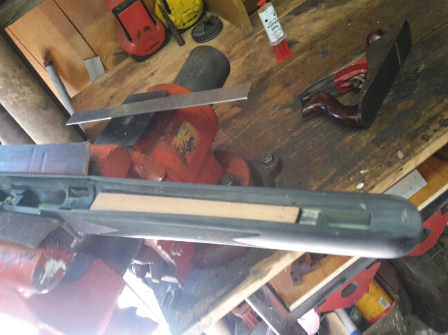

All shaped up
2016-04-28 13.58.42.jpg (256.96 KiB) Viewed 5518 times
Trial fit, snug but not tight. ( room for glue )

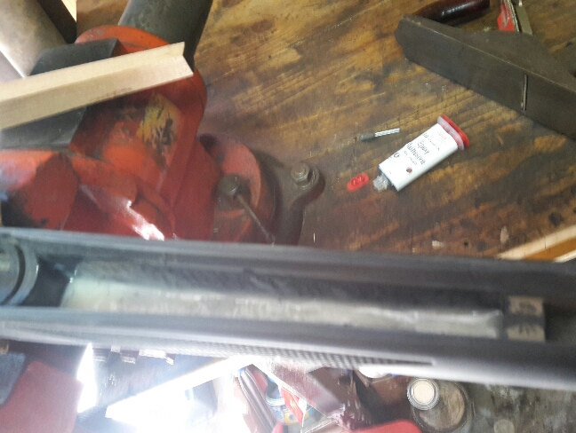

Squeezed into place, just pushed home and hekd there with clamps.
2016-04-28 14.00.50.jpg (365.21 KiB) Viewed 5518 times
