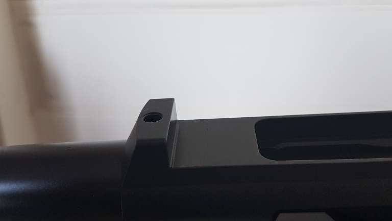

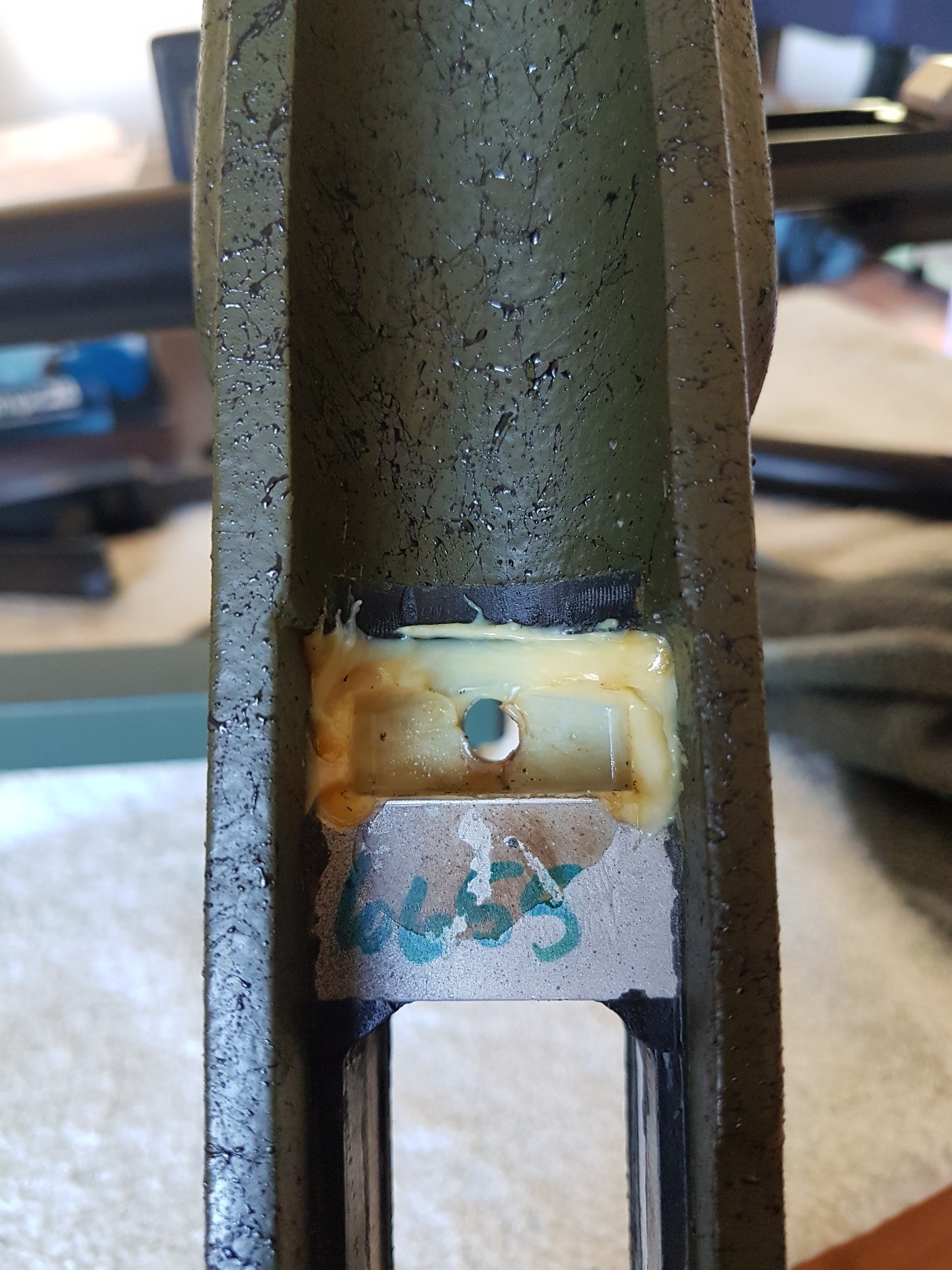

I purchased a bell and Carlson stock for my howa 308, on the weekend I attached it to the action and while doing that I noticed the compound used around the front screw is kind of soft and tacky. Is that normal?

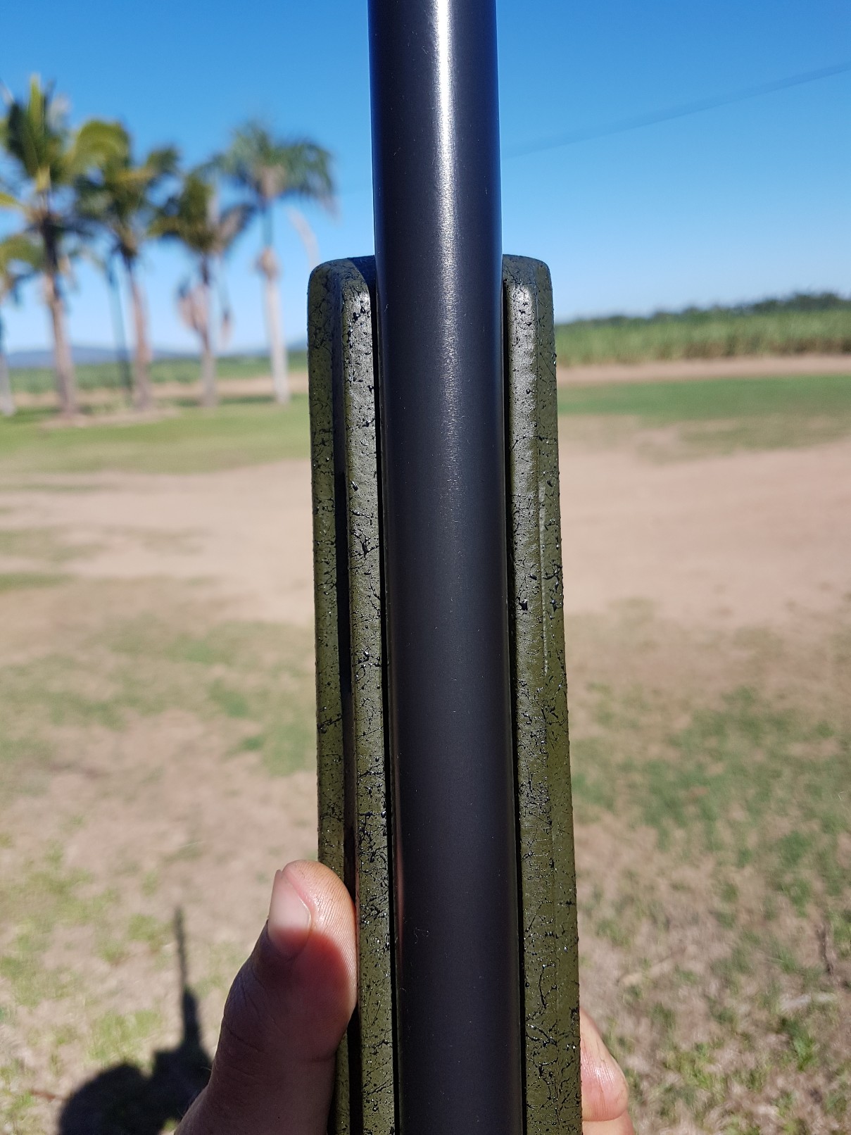

Also, the barrel is not perfectly in the center of the stock. Still plenty of clearance both sides, but thats the kind of thing I'm going to look at every time I pick up the rifle. Would rebedding be the only way to correct this?

Looks like the same stuff used in Weatherby vanguards. Comes out of a kind of hot glue gun and the action is bedded into it. If the action isn’t held straight it will set off Center
No, it should t be soft or tacky, is it new? If it’s used maybe it’s had some solvent on it that’s attacked the material
Yeah I was wondering if maybe something had attacked it. I bought it from a store down nsw that had a weatherby action in it, so while it is new, it has been played with

G'day Kelsey Cooter mate if it was me I would dig it out and do if again with Devcon or any of the other harder epoxies
Then you could possibly move the barrel to the center

Tonight I had another look at the bedding compound, poked the screw driver into it, and it felt just like poking something sharp into glue out of a hot glue gun, so now I'm doubting that it has been affected by something since that is how you blokes have been describing it, seems like its intended to be soft?
Either way seems like its going to be easy to remove being so soft.
