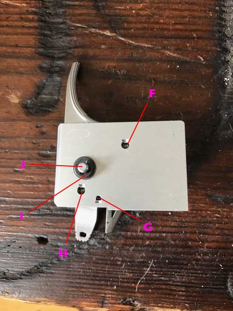

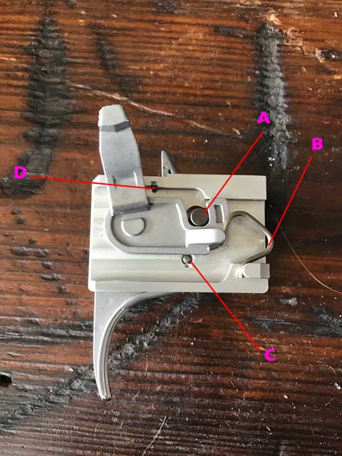

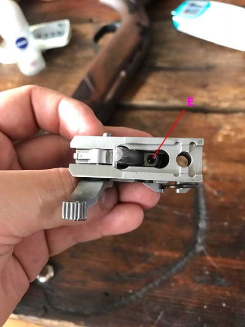

Hi guys,
I recently purchased a Lumley Arms Trigger and Sear Spring Kit for my LA101 22lr. I don't really know where to start with regard to installation. I could start ripping it apart and see how I go, however I'd prefer not to unnecessarily remove components. So I figured there'd be a few on here who'd done this job themselves and could provide a guide on how to do it. DISCLAIMER: I take full responsibility for my own actions, so feel free to make suggestions if you've done this yourself. I have an array of tools including:
- small nylon/brass hammer
- small pin punches of various sizes
- metric hex-key set going down to size 1.5mm
- small circlip pliers
+ your usual tools.
I've provided labelled photographs of my detached trigger assembly so we all clearly know exactly what components we are talking about:
Any advice would be greatly appreciated :thumbsup:

Hi guys, quick update; was able to install the spring kit myself just by having a go :thumbsup:

Wylie27 wrote:Love your work! I had a gun smith do it. After another gun smith stuffed up the action screw.
The trigger is bloody light isn't it - bit of a shock to the system TBH, I've plinked thousands of rounds through it (before the replacement), so it feels very different now. I'd be nervous about trekking around with it chambered and safety off that's for sure. Guess it's a good way of forcing you to never put yourself in such a situation.
The two action screws were a no brainers, dunno how he damaged them? - the trigger assembly screw on the other hand, it was covered in some kind of blue polymer. It was quite difficult to ascertain that you actually need a different 4mm key to remove it; I actually thought Id stripped it at first (which is when I lost a bit of confidence). But once I cleaned it up properly, I realised it was fine (just a different size).
The only thing I'm not completely sure of is if I need to somehow dent the assembly housing again to lock the pins in? Or will they basically never fall out due to being such snug fits?

Post by in2anity » 16 Jul 2021, 10:37 am
Removed circular clip. I on my picture
Remove trigger retaining pin. F on my picture, this is the only step that requires a punch+small hammer. Loctite/nailpolish the side the retaining bur was knocked away
Loosen grub screw. E on my picture
Remove safety pin. A on my picture
(remove trigger)

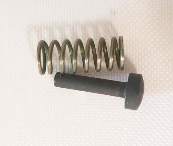

Remove trigger spring and bolt release plunger. From memory (it's been a while), I think the head of the bolt release plunger is obscured by the safety leaver in my photos. From memory I have a feeling the base of the plunger might be H but I'm not 100% sure. Whether it's H or not, once you lift the safety leaver out, you should easily be able to identify the head of the bolt release plunger akin to this image:
This last step will become clear, once you get to it.
Please correct me where I'm wrong, it's been a while since I've done one, or add another photo clarifying once completed. It'd be nice to put this guide to bed, once and for all.
In2.
