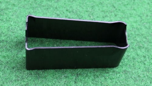

So does yours have a up rite plate that slots in the magazine or is it like the one in the image?
Mine has up rite plate, but older howa and know if its not in corect it wont work.

Post by FlyingStick » 06 May 2017, 9:57 pm
pete1 wrote:So does yours have a up rite plate that slots in the magazine or is it like the one in the image?
That one in the image (which was also replaced).

Re: Howa 1500 "Slow feed" issue
Post by pomemax » 06 May 2017, 10:13 pm
Like image had to look in safe
