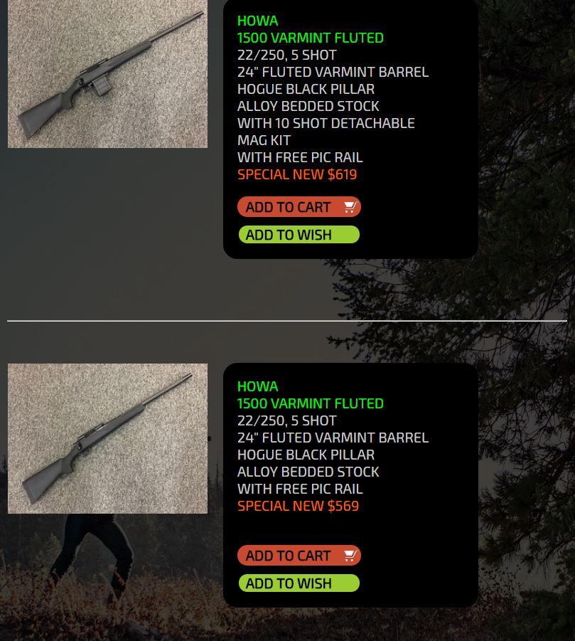

It's not at all difficult, but is it worth the messing around when you can buy a brand new Howa 22-250 for $600?
Howa 22-250.JPG (129.23 KiB) Viewed 11898 times
