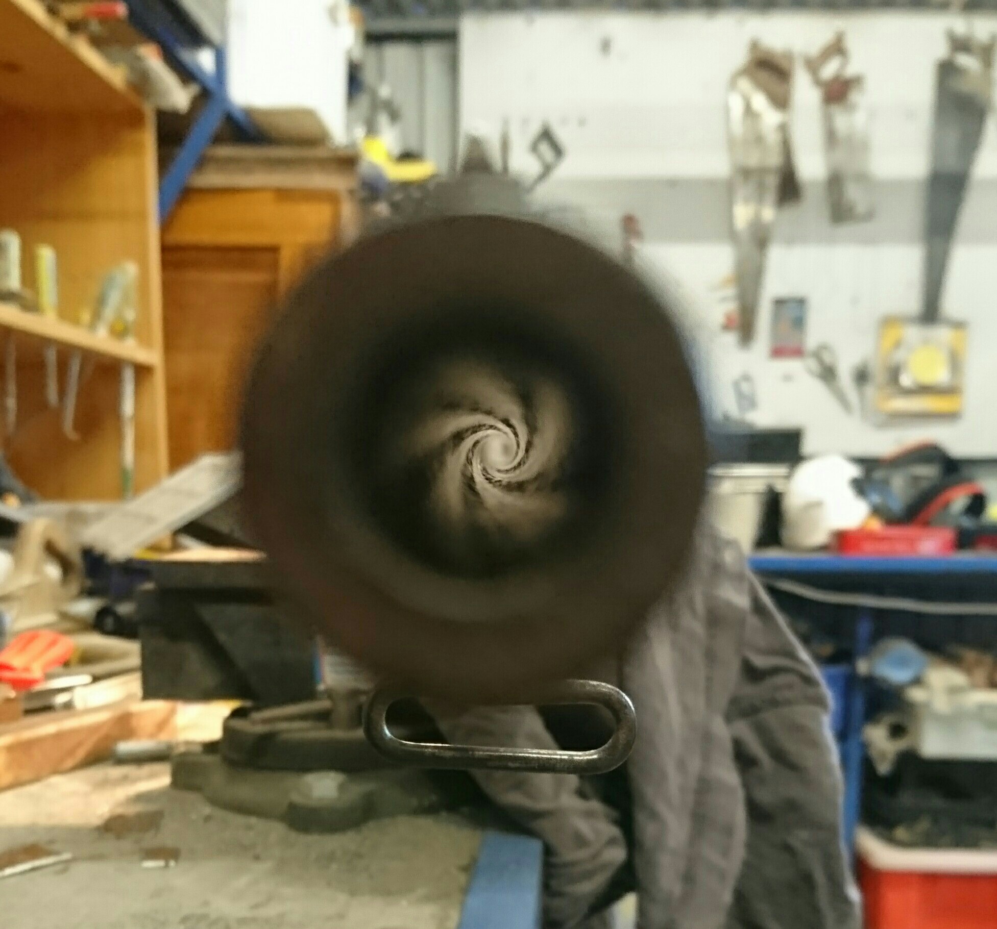

I'm trying to rescue a BSA cadet in. 310. The whole thing needs a damn good clean. The barrel is absolutely filthy. I don't think I've ever seen anything like it. Just looking for some suggestions on approaches to getting this thing cleaned up.
I ran a few patches with solvent down the barrel and a. 30 cal brush (what I had in the box) but it needs something with a bit more punch.
Also scored nearly 500 rounds of ammo with it. Like the rifle, it wasn't stored well. I cleaned a few up with a scouring pad and they came up OK. Cleaned up, the cases and projectiles might be useful but apparently many of the rounds don't discharge...... Im thinking it might be worth pulling the projectiles out, discarding the old powder and reloading with the original primers and projectiles. Is this a reasonable idea?

Can't tell if the streaks are on the tops of the lands or in the bottoms of the grooves. What treatment did you try this arvo? Heckler303's Autosol isn't a bad idea for abrasive.
Posts: 1816

Wm.Traynor wrote:Can't tell if the streaks are on the tops of the lands or in the bottoms of the grooves. What treatment did you try this arvo?.
Funny that, neither can I at this stage. I'm hoping it's gunk in the grooves not pitting on the lands. I just ran plugged the bore and filled it with turps, let it soak for 5 minutes and then flushed it a couple of times and then ran a .35 calibre bronze brush through it a few times. A lot of gunk came out already.

".........not pitting on the lands". Do not give up. The barrel of one of my rifles looked like the bore had been rifled with a pick and shovel but it still shoots extremely well. Not sure about turps. There is some discussion on ozfclass.com about Mercury 2 stroke outboard engine cleaner for carbon but I doubt that is the real problem. Might be worth a read for future reference. In the meantime give it what I described above.
Posts: 1816

Many of the suggestions so far are a waste of time and some are likely to cause damage.
Best approach is to obtain a stainless steel 30 cal bore brush. A number of strokes with a good solvent will get the barrel as clean as may be possible.
If the lands have rust pitting then nothing will fix that. Since you have to clean from the muzzle be very careful not to damage the crown.
In your case the picture shows an unusual situation in that usually the grooves are where the rust is, not the lands.

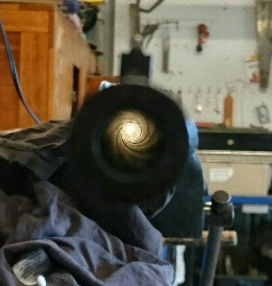

So I got the old girl apart today. The trigger assembly took some soaking in wd-40 to get it to loosen up and slide out. I plugged and soaked the barrel in turps for an hour and then flushed it with clean turps, then flushed it with a couple of litres of water straight off the boil from the kettle. That lifted a bit of gunk. Got back to it a few hours later and ran a few more kettle fulls of water through it. Then ran some patches soaked in solvent through it, let it sit for 5 minutes and then about 50 strokes with a bronze brush, then patched it out with clean solvent/swabs. It's getting there. I think it might actually come clean eventually.....
Posts: 747

Post by Bent Arrow » 13 Aug 2017, 5:54 pm
So a few hours in the shed, half a bottle of solvent, 3 brass brushes, half a roll of cotton cloth and a jar of elbow grease later I think this is about as good as this bore is going to get.
After a bit of a clean
After today's effort

great job on the bore by the way
