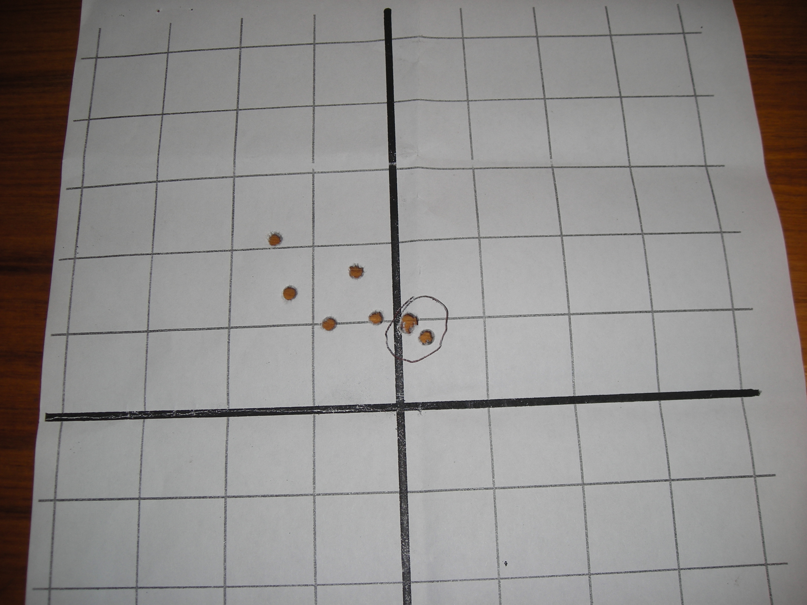

Post by GQshayne » 04 Oct 2019, 9:22 pm
Conditions for testing were rubbish - it was blowing a gale the whole time I was away. But I managed to find a bit of a track pushed into the scrub just good enough for a 100m target. I made up a portable shooting bench like many on here have done, and with the usual sandbags etc, I have a fairly good rest. Not benchrest, but pretty good.
I had three handloads to test behind the 25gn VMax, using W760. The 760 flowed into the tiny case really well - better than 2209 into my .243. I had 26gn, 26.3gn 7 26.6gn. The idea was to keep MV below 4000fps, and get some accuracy. Plenty of .17Rem owners reckon that running 4000fps plus is when you get higher barrel wear, and also increased copper fouling. Internet talk, but plenty seem to agree. 26gn of W760 came off a US forum, with the other two done to give some variation. All 3 loads are below max.
So I did a basic sighting in with not many shots (I forget), maybe 5 or so, and then decided to try a 3 shot group to see what it would do. The 26gn load was the tester. The first two shots cut the same hole, with the third shot maybe 10mm apart. I did not measure it, did not take a photo, and even fired more shots with a different load at the same target. Oops..... I am not a target shooter, but this is the best group I have ever shot with anything. Getting the trigger at 100% like my LSA55 will help too.
My alternate loads were not as good, opening the groups up to about 1 inch. So it looks like 26gn is the winner. Next job will be to see how the barrel cleans up after the 25 or shots that were fired. But it certainly does not need a new barrel, and the months of cleaning have obviously done it no harm either. So it can be stripped down and cleaned up and polished, cerakoted, and the new stock fitted and betted after re-finishing. Dunno how long that will take, but it is a project, and I have lots of other stuff to do.
So far so good.

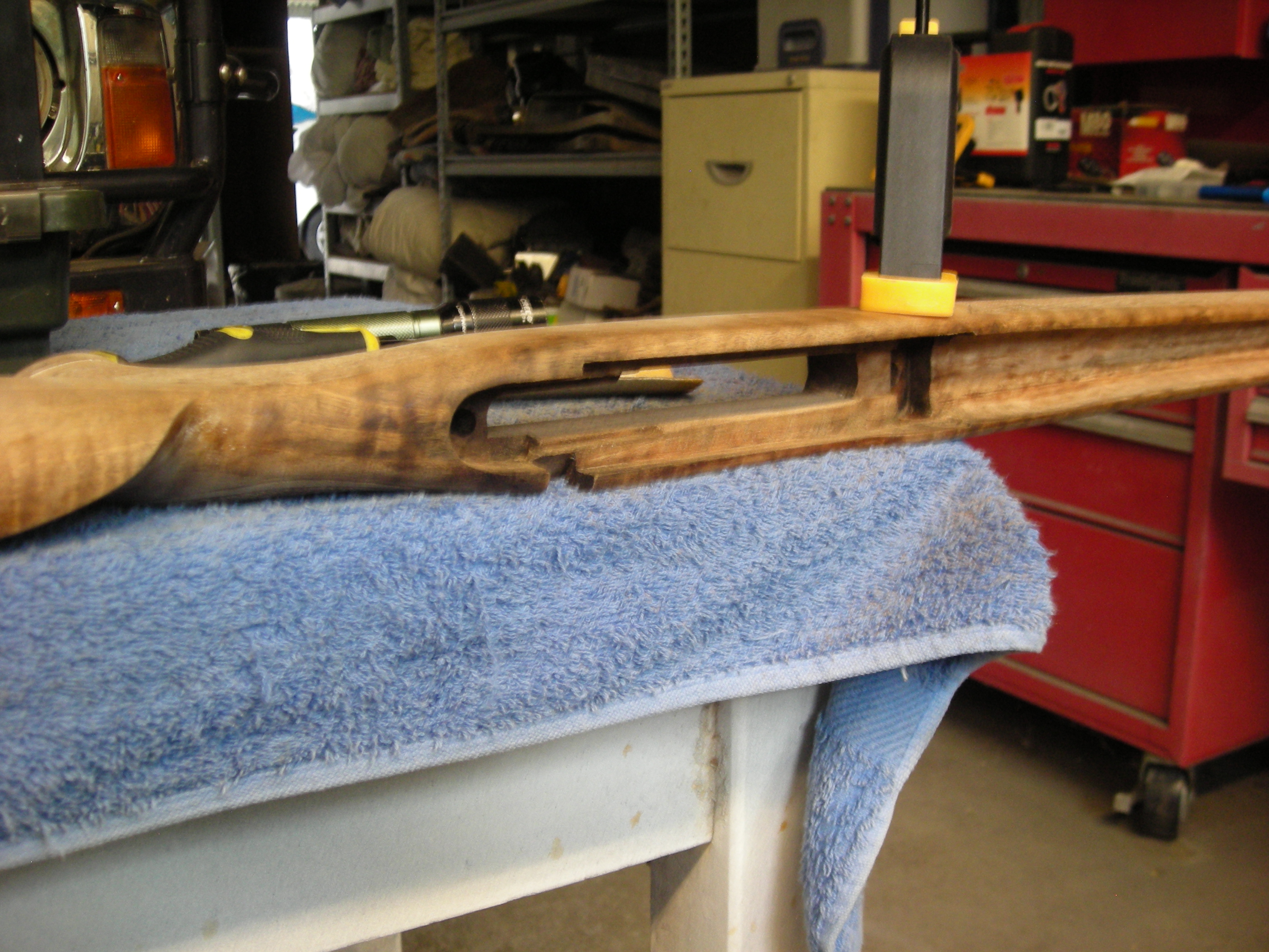

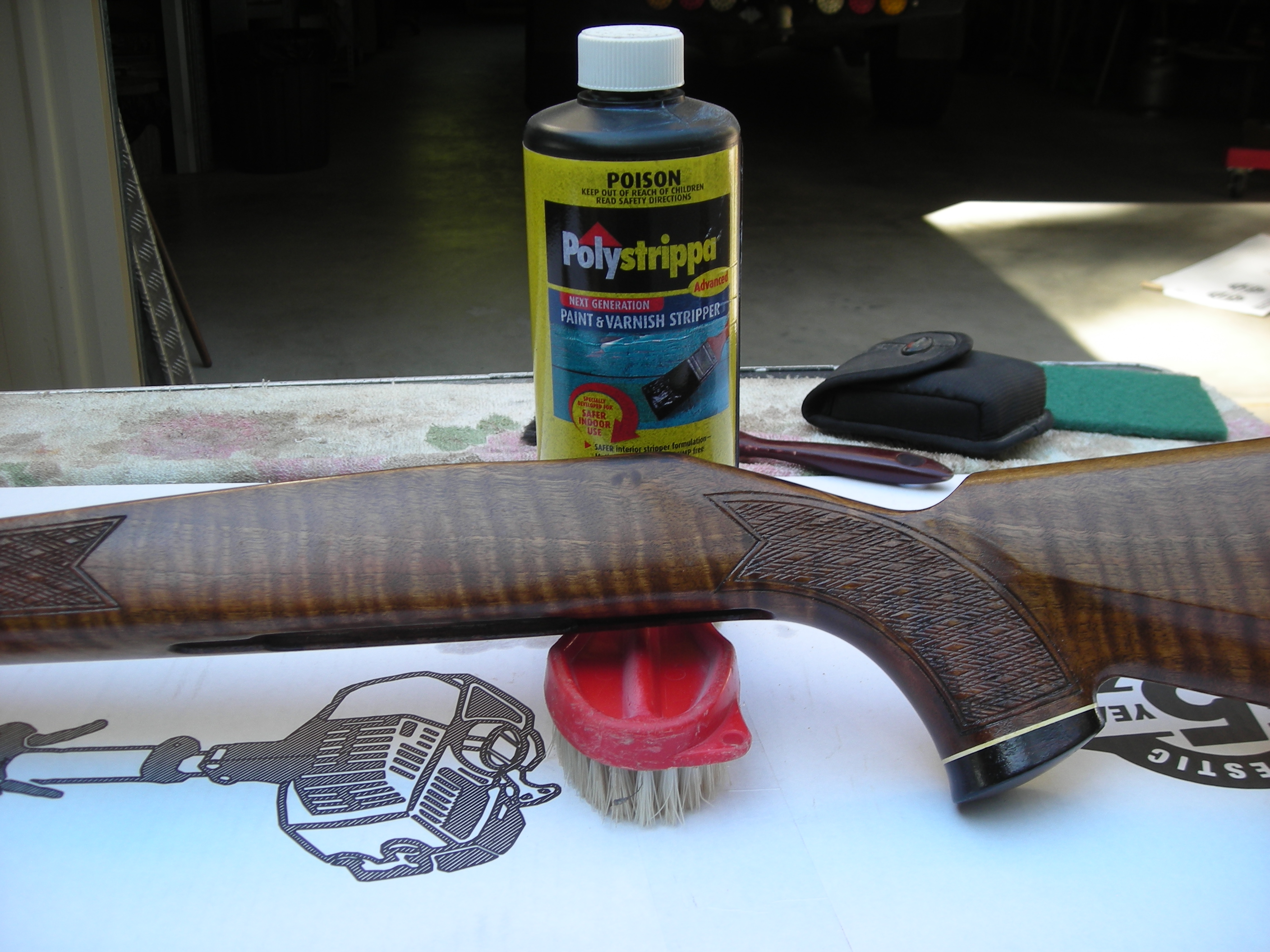

Well, plans change, as they always do. My main task at the moment has been put on the back burner for a week or so, as I have an injury that I need to look after. Working on my Patrol suspension with a sore elbow, which I got by working on it in the first place, has been delayed a week or so to help the recovery.
So, I decided to do some work on the rifle. Now that I know it shoots ok, it has been stripped down for refurbishment. I found that target by the way - dad rescued it. It has other holes in it, but you can still see the 3 shot group. So first job is to fit the new stock, with a bedding job and new recoil pad. Stock can then be refinished. Metal work can be cleaned up and polished, and then it will be Cerakoted before going back together.
I bought a linisher today, which I have not had previously to do these jobs, so that will help. And I am taking a few photos of things as I go, so I will be able to show some progress as things move along.

Here is the target that has the 3 shot group on it. The other holes were load variations, that were obviously not as good! Not bad for a sporter in less than ideal wind conditions. And I am not much of a target shooter either. So having achieved that group that is the job done for me. Hopefully when fitted to the new stock it will shoot the same.

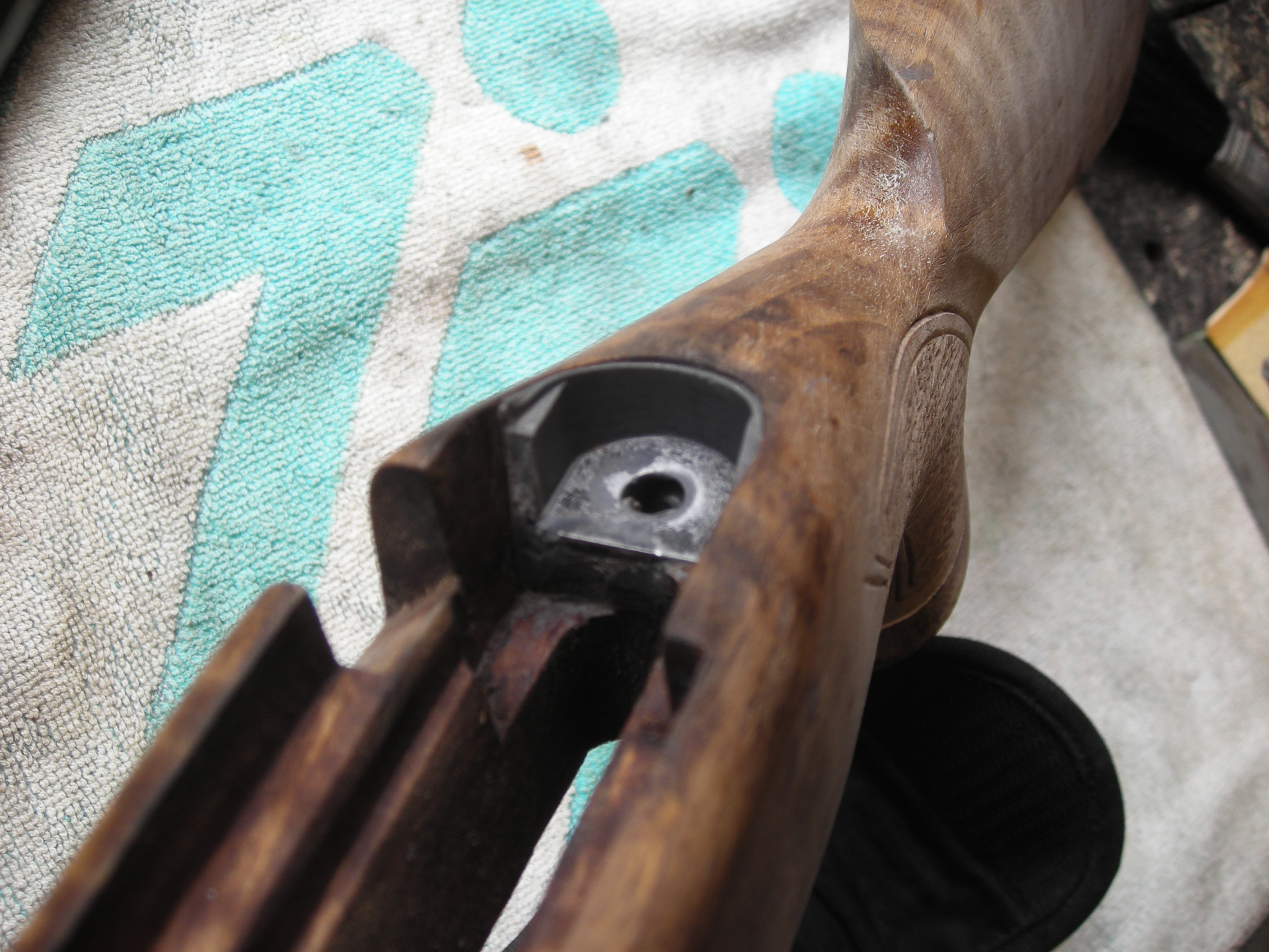

First job was to do a bit of inletting, and then bed the new stock to the barrel and action. But the previous stock owner had refinished it at some stage, and the inside had a good coat of what I suspect was Tru Oil. So I figured it had to go first, so I stripped the stock fully, which I was going to do eventually anyway. It was an ok job, but it could be better.
Given the stocks were bot short action stocks I expected them to be the same, and that it would fit straight away, but that was not the case. More work then I expected, but it the end it fits nicely.
This is my bedding method, using JB Weld. No doubt there are other opinions on how it should be done, but for a sporter I think this is ok.

Post by AZZA'S HJ47 » 13 Oct 2019, 1:17 pm
Have done the same thing with a howa 308 and the difference it made was amazing

Post by GQshayne » 13 Oct 2019, 7:07 pm
AZZA'S HJ47 wrote:Have done the same thing with a howa 308 and the difference it made was amazing
When I was researching how to DIY bedding for my last job, I saw a lot of guys doing BIG jobs - either pillars or the entire action filled with epoxy. And then I came across an older gent in his gunsmithing shop, who showed the above method, and explained why he did it this way. He said that if it is fixed at the front and fixed at the rear, then filling the middle with epoxy did not achieve anything. To illustrate his point, he showed a factory bedding job on a high grade rifle - this is how the factory did it. On a sporter rather than a benchrest rifle I reckoned that was good enough for me. The previous stock on this rifle was bedded the exact same way by a previous owner or gunsmith.
