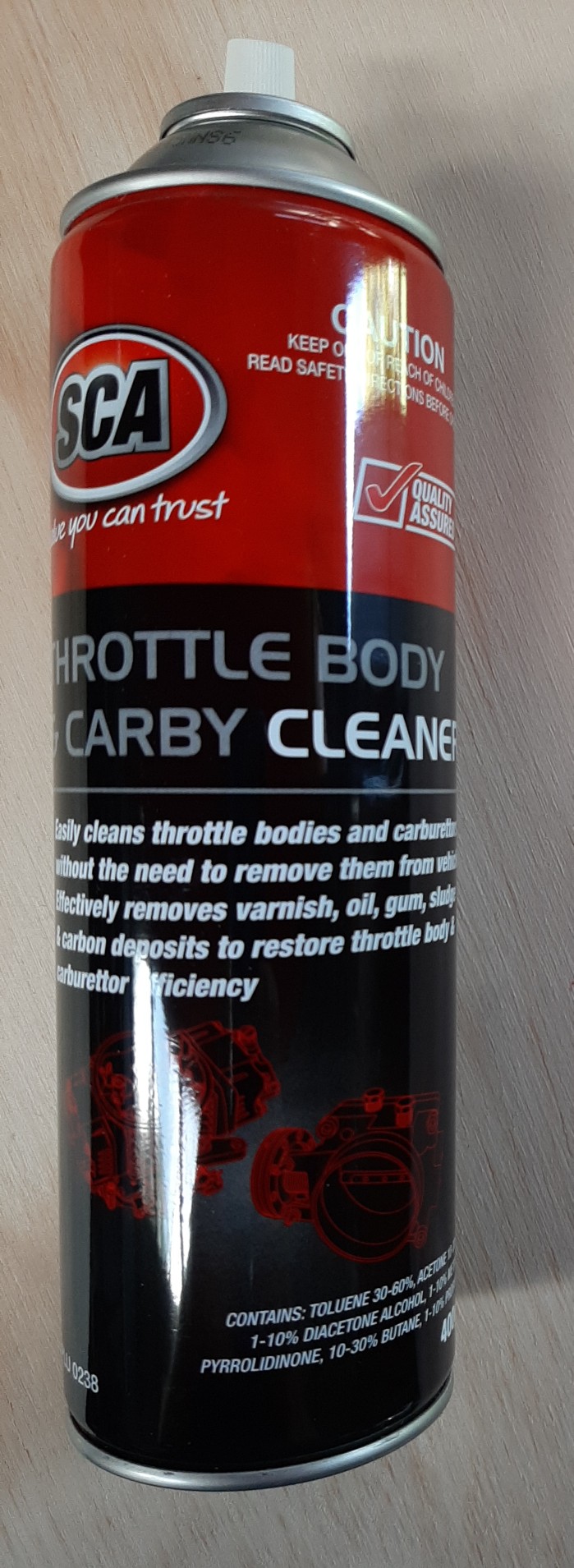

Post by Oldbloke » 09 Mar 2020, 9:38 am
Sooo... just thought i would regurgitate this thread. Normally for just cleaning carbon/soot out of my centre fires I just use eds red so I bought some of this carby cleaner from Supercheap Auto last week thought id give it a crack. Turns out the bores weren't as clean as I thought. Yesterday I spent 3 hours cleaning 2 and today I'm spent about another 2 hours cleaning out another. Plenty of carbon crap material is still coming out so give this stuff ago. Seems better than eds red can't speak much about other carbon cleaners.
Use sweets for copper once a year.
Carby cleaner.jpeg (288.07 KiB) Viewed 10808 times
P.S. I clean my rifles almost every time i use them so am assuming they were cleaned after last use.

Post by SCJ429 » 09 Mar 2020, 10:09 am
Carby cleaner is very effective on carbon. Good for cleaning throttle bodies too.

Post by Stix » 09 Mar 2020, 12:41 pm
Yep...interesting...
I bought same brand brake cleaner for same purpose.
I briefly tried to find out what the active ingredients are in carby & brake cleaner, but couldnt find anything.
Asking a few people in shops, it was suggested that brake cleaner would be better for baked on carbon, but the suggestion didnt come with any scientific backing....its just based on assuming brakes would get hotter than a carby.
I even asked a manufacturor & no one could tell me the active ingredients so i dont know which one is better for baked on carbon.
This SCA brake cleaner is no good for painted surfaces & rubber parts...so obviously cant do timber stocks any good...so being paranoid i walk out the room to spray the patch...lol
Is the carby cleaner also bad for paint & rubber OldBloke...?

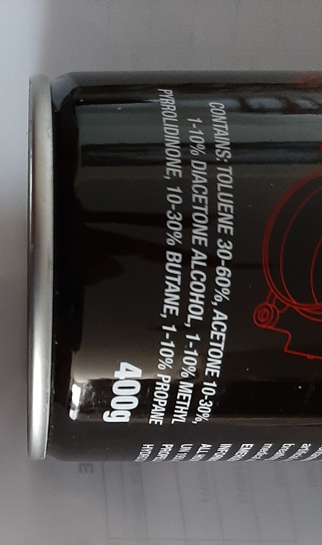

Post by Oldbloke » 09 Mar 2020, 5:24 pm
Contents, recipe.
Sca recipe.jpeg (259.86 KiB) Viewed 10776 times

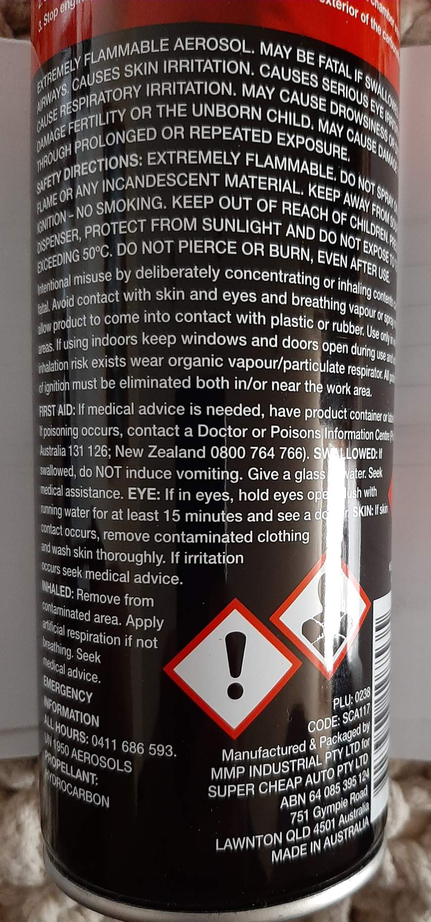

Post by Oldbloke » 09 Mar 2020, 5:26 pm
OHS Instructions.
Sca ohs instructions.jpeg (227.46 KiB) Viewed 10775 times

Post by Oldbloke » 09 Mar 2020, 5:36 pm
Stix, both toluene and acetone disolve various plastics. So be carefull with plastic stocks and magazine followers. I suspect same with paint and rubbers. I think acetone is ok with timber.
Regarding safety. Acetone us at the low end of toxicity scale. Pls understand not all carcinogenics are equal. . Everytime you fill up with petrol you are breathing at least some benzene.
We use very small quantities. Just ensure pleny of ventilation. Eg open a couple of windows or doors when in use.
Cant speak about the other substances.
EDIT My mistake. benzene and toluene are carcinogens. Have edited the above.

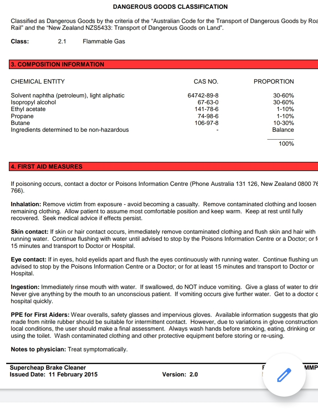

Post by Oldbloke » 14 Mar 2020, 9:27 am
Here is the SCA brake cleaner.
SCA Brake clean er.jpg (640.08 KiB) Viewed 10479 times
