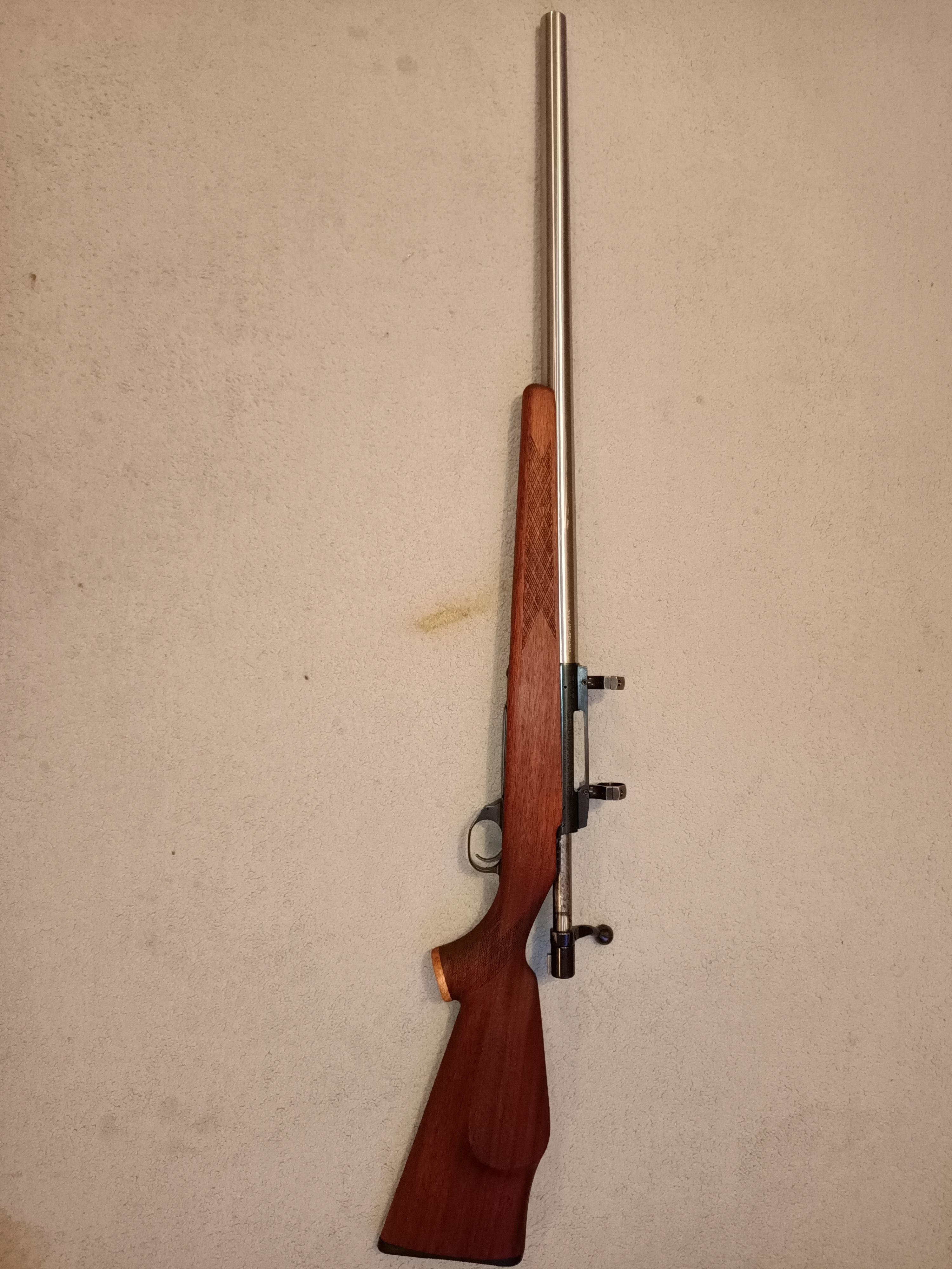

Post by Am88 » 07 Feb 2020, 10:06 am
Scope is fitted finally, she's ready to shoot. Unfortunately I am going away so this weekend it won't be happening. Its an old Leopold M8 fixed 8 power AO. Glass is in really good nick and fine duplex reticle is what I was after. Bit going on at the moment but later on I would like to upgrade the scope mounts possibly to a picatinny rail setup so I can swings torch off the side if needed. :drinks:

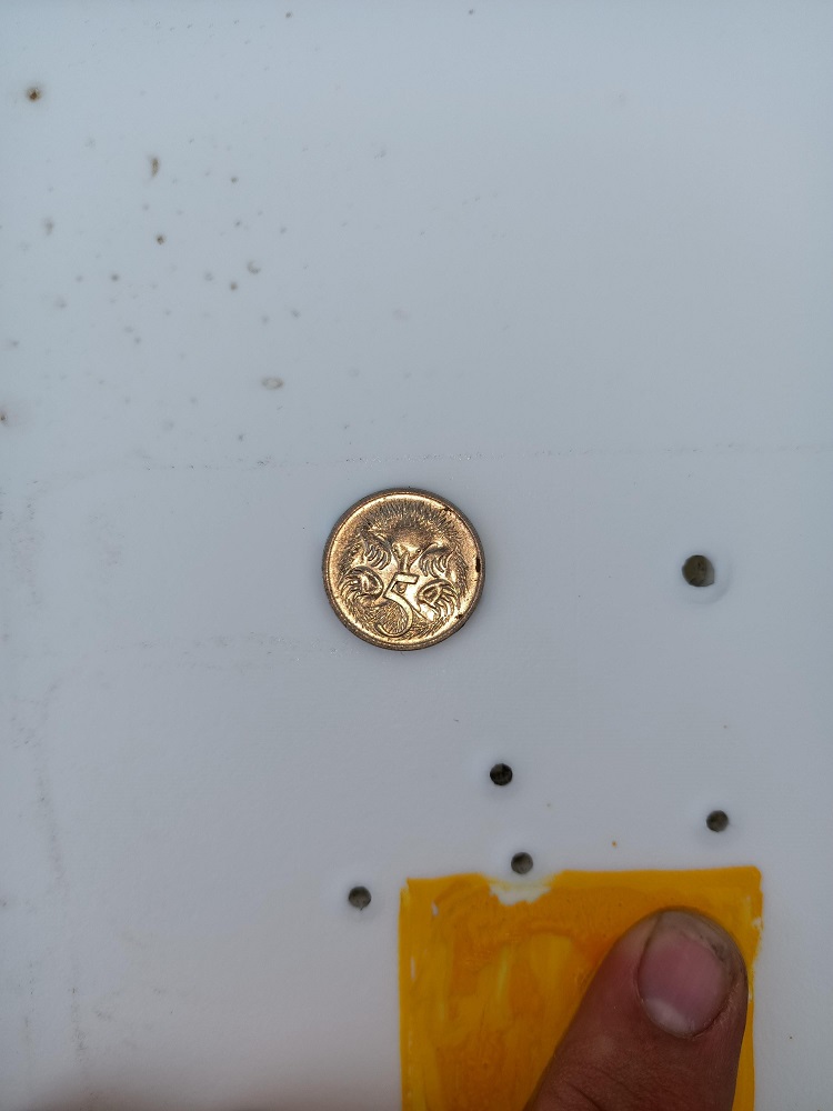

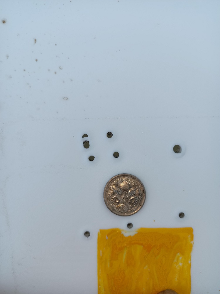

Finally got the barrel warm. Took long enough, I loaded some run in/sighting roands, 23gr of 8208 and 55gr vmaxs. Don't really know about run in processes, I like to think of it as conditioning, so I just shot 2, one pass with a brush and hoppe's #9 shot 2 etc. Until I had shot 8, then let a 6 shot group fly shooting every 20 seconds, the group is the top left. First shot cold and clean was top right, second shot was bottom right and the vertical string was the remaining 4 shots.
Pretty happy considering the loads were just a made up low weight thrown from the powder thrower so it probably varied up to .2 of a grain either way, and I shot it out of the Ute window, I did cheat but, I had a rear bag on the window sil :lol: let's see what happens when I get some decent bullets running through it.

Post by marksman » 18 Feb 2020, 12:04 pm
l think you will find its going to be a shooter :thumbsup:
