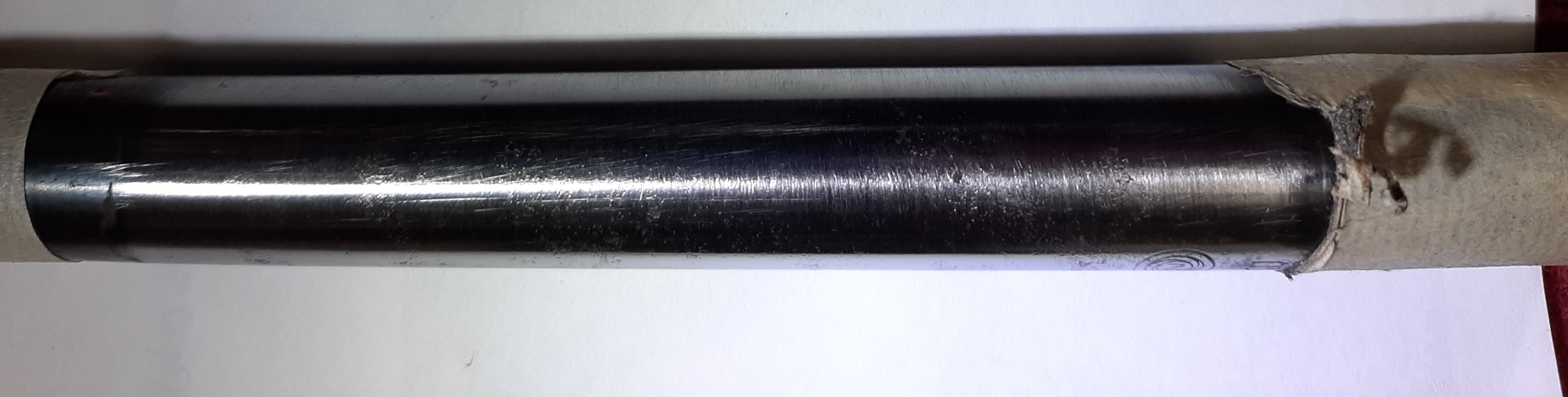

Put in about 20 minutes draw going the barrel and another 20 sanding. This is the really bad spot and needs more sanding but much improved. More Sanding for the young assistant.

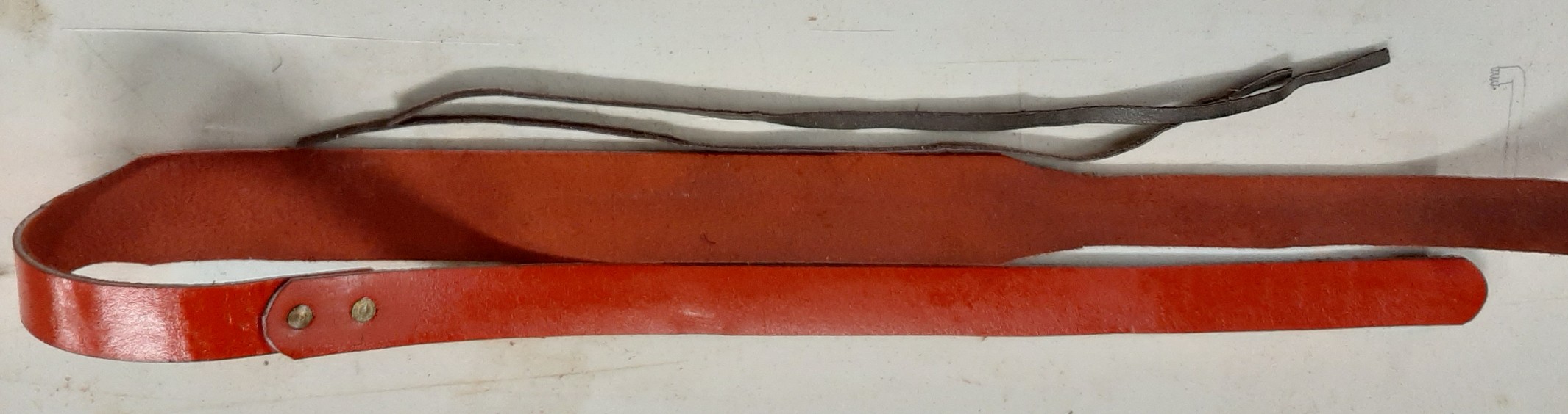

Also made a start on a leather sling using leather from a previous project. I'll let the grandson complete that.

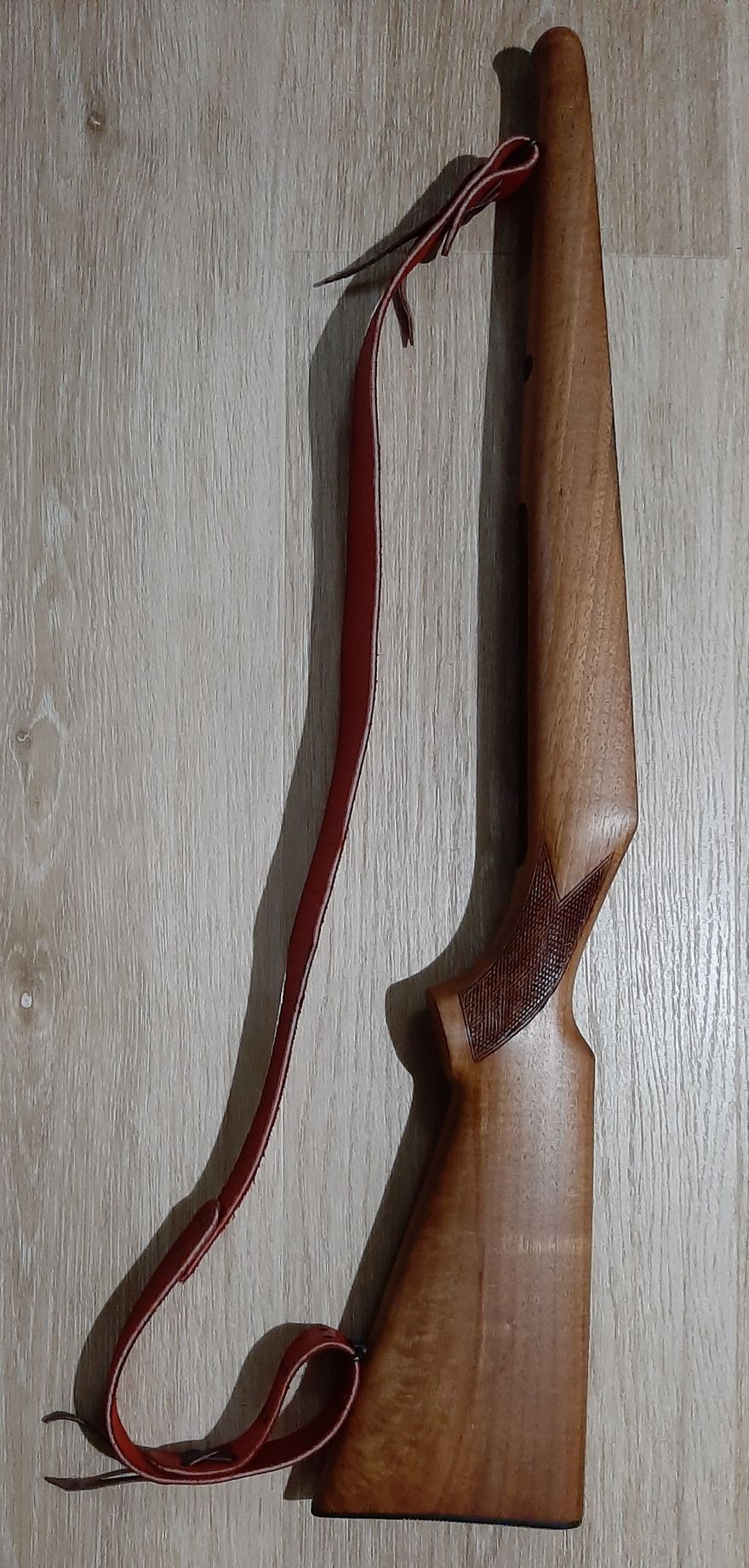

Update. Stock is very close to complete. Brushed some linseed oil into the checkering today after giving the stock some oil and a light sand with 400 wet and dry. I think that's 5 coats now. Another dose of oil for the checkering and some stock wax and done.
Also fitted the DIY sling today.
Next stage is the barrel. I have already filed and sanded out 95% of the rust. I have decided to give the pot belly stove paint a crack. Heaps easier than bluing.

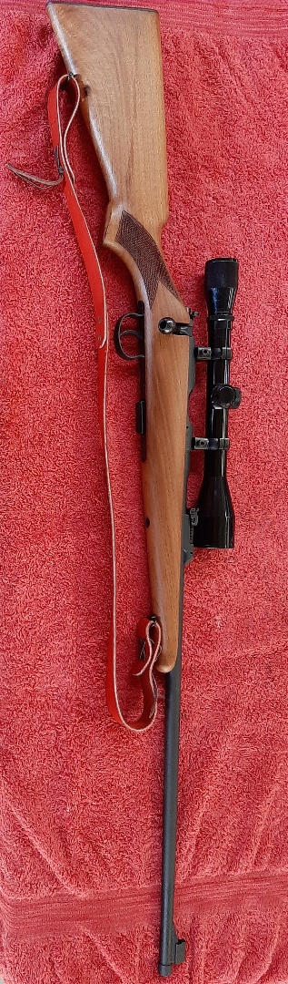

Post by Oldbloke » 04 Aug 2020, 2:09 pm
Well in the end it's got 5 coats of pot belly black which is a close match to the action and I'm very pleased with the finish. An old zenison 4 x 40 scope is mounted and bore sighted.
Will have to wait a few weeks to test fire and sight in.
Young Evan will be stoked.

Re: Brno Model 2 Restoration
Post by in2anity » 04 Aug 2020, 3:46 pm
Immaculate OB - well done! Looks like new at least in the snap. Now what?
Post by Oldbloke » 04 Aug 2020, 5:43 pm
The pic doesnt do it justice because it's zipped

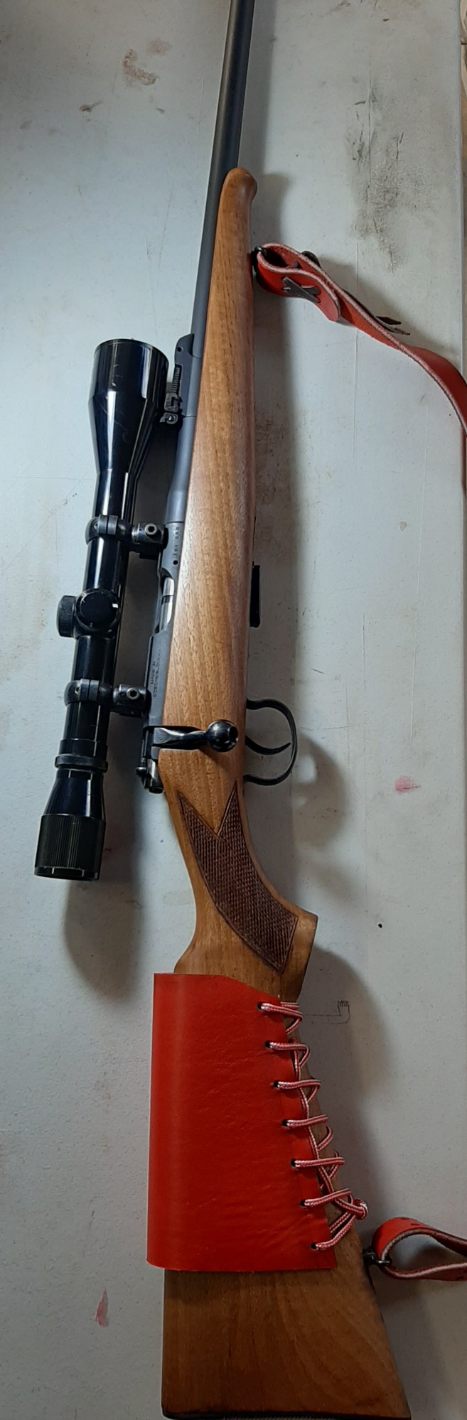

Post by Oldbloke » 28 Aug 2020, 5:28 pm
Decided to add a cheek riser. Just need to check POI now when I get around to it.
