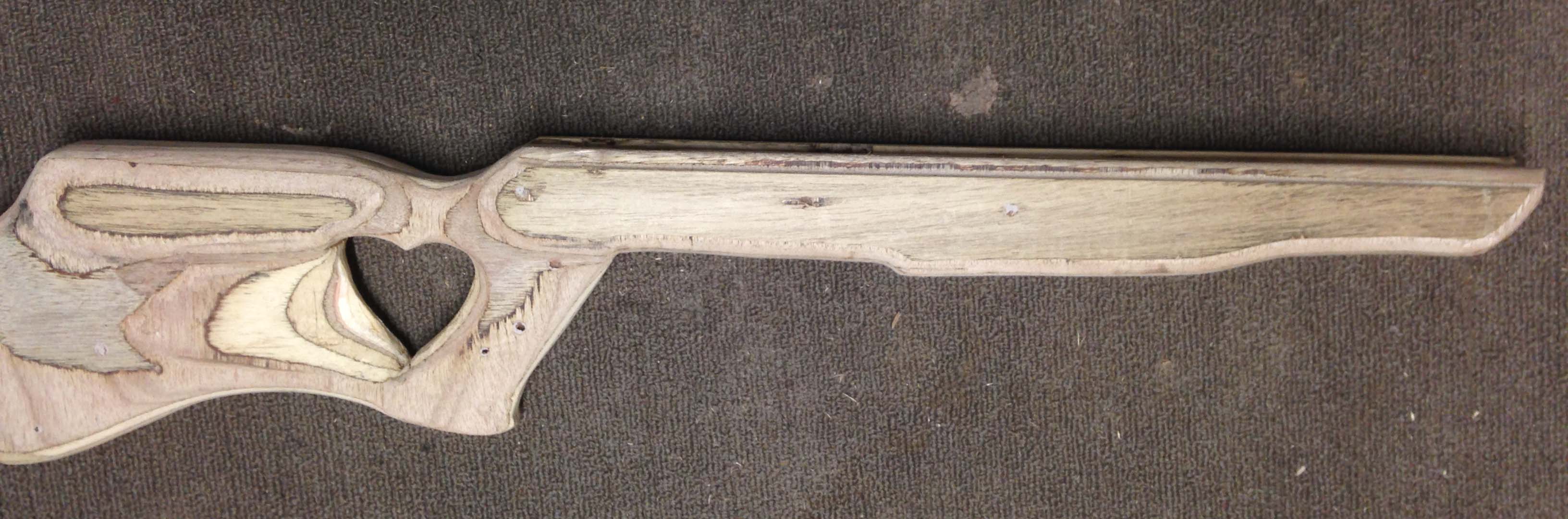

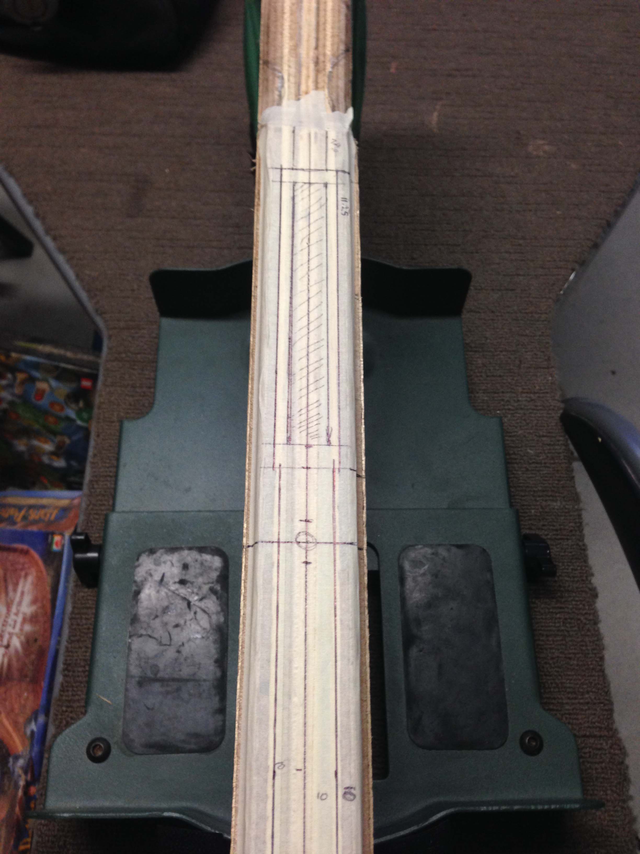

Just a quick update. Got to do some more work on the weekend (too wet and windy to be out shooting). I marked up the stock and completed the rough inletting utilising hand drill, router and dremel. Items of note:
1. Masking tape used on top of stock for marking out as it made it easier for me to see the lines - huge improvement over my past attempt
2. I would kill for a drill press - makes getting the holes for the action pillar and magazine and trigger relief much more accurate
The first photo is the marked up stock and the second is after the rough inletting. Once I am happy with the inletting I will use a flap disk for shaping and then I will be into the plastic filler to provide a nice surface for painting. More photos and info to follow when I am at that stage
rough inletting.jpg (409.39 KiB) Viewed 13676 times
marked up.jpg (392.53 KiB) Viewed 13676 times

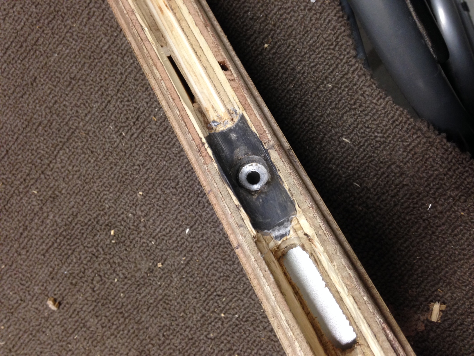

Post by DaleH » 28 Aug 2014, 11:10 pm
Following is a photo of the pillar bedding including the resin bedding of the hold down screw for the lithgow.
Aluminium pillar was from Atlas works in Perth and the bedding compound is Devcon steel epoxy.
The barrel / action was coated with neutral nugget shoe polish to stop the epoxy sticking to the barrel. PVC tape and plasticine was used to dam up the epoxy in certain areas. The overflow was trimmed using a dremel tool.
Next on the list is to make the bottom metal (trigger guard and magazine surround) and then putty the stock in preparation for sanding. For the bottom metal I am using aluminium extrusions and for the puttying, I will be using spray on automotive putty. This will make it easier to get the final shape and produce a smooth surface on the cheap plywood base.

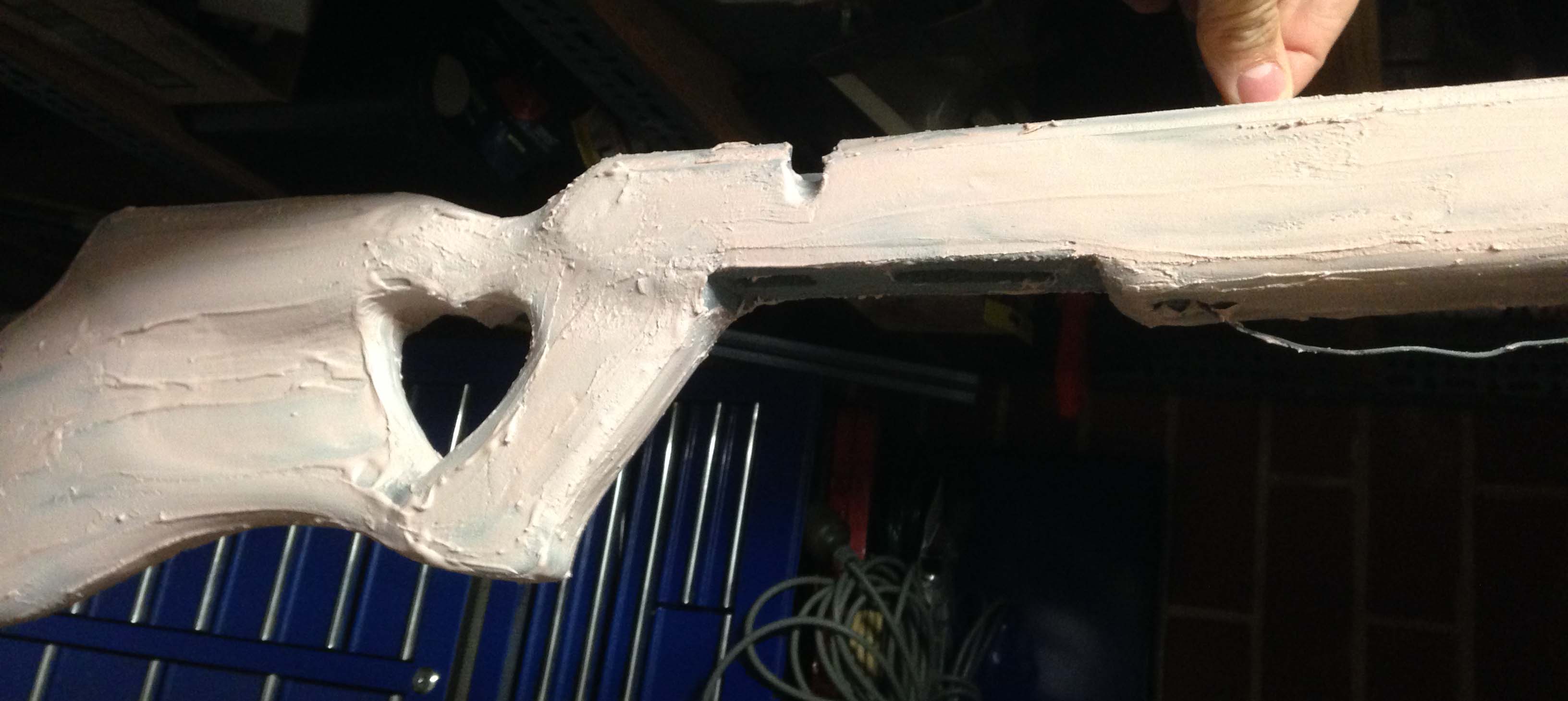

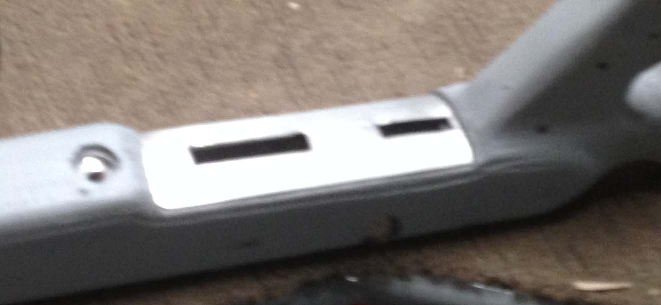

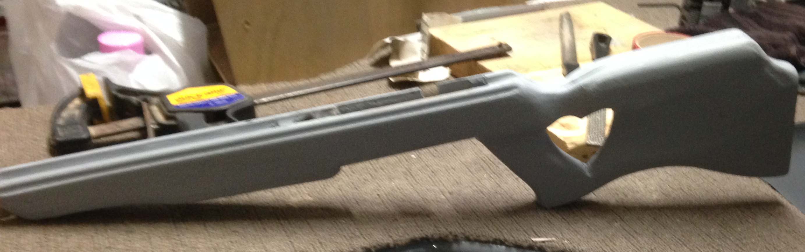

Spray putty sealed and bogged ready for final sanding before painting.
Making the bottom metal from aluminium and trigger guard will be integrated into the stock.
Photos following are:
- bogged ready to sand
- Bottom metal (will be painted to match stock)
- spray putty / undercoated stock

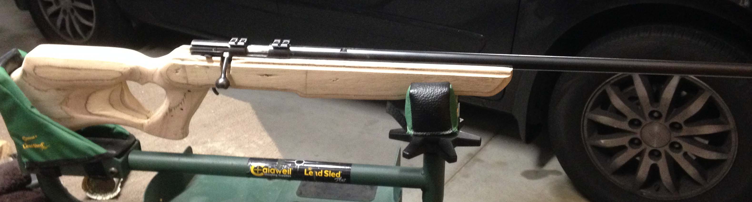

Post by DaleH » 05 Sep 2014, 5:46 pm
Thanks for the feedback guys - much appreciated.
More sanding and undercoating this weekend once i have made the trigger guard- will post more on Monday.
This is what the raw stock looks like with the action / barrel in place.
raw stock.jpg (176.85 KiB) Viewed 13768 times

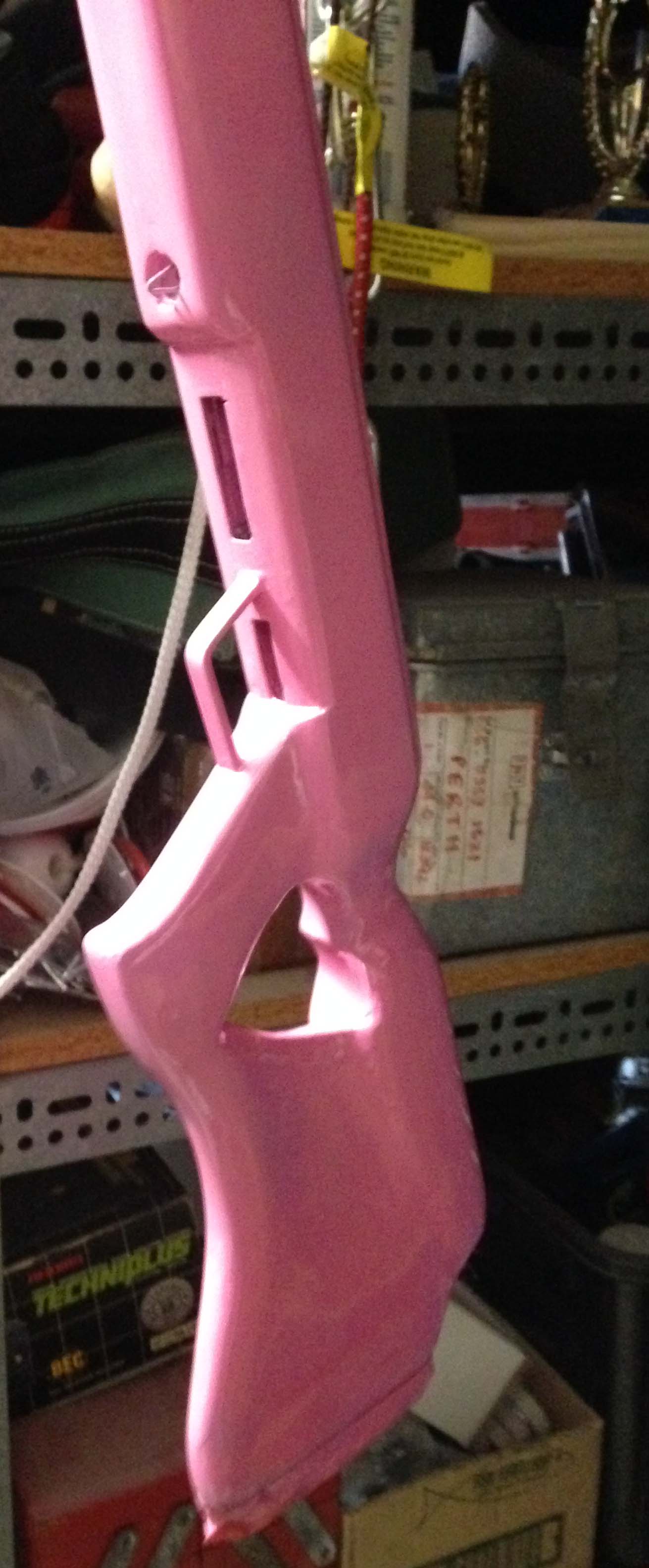

Post by DaleH » 06 Oct 2014, 11:08 am
last coat.jpg (243.62 KiB) Viewed 12531 times
Final colour coat - sparkle and clear coat required to finish the job. Daughter loves it - big brownie points for me.
