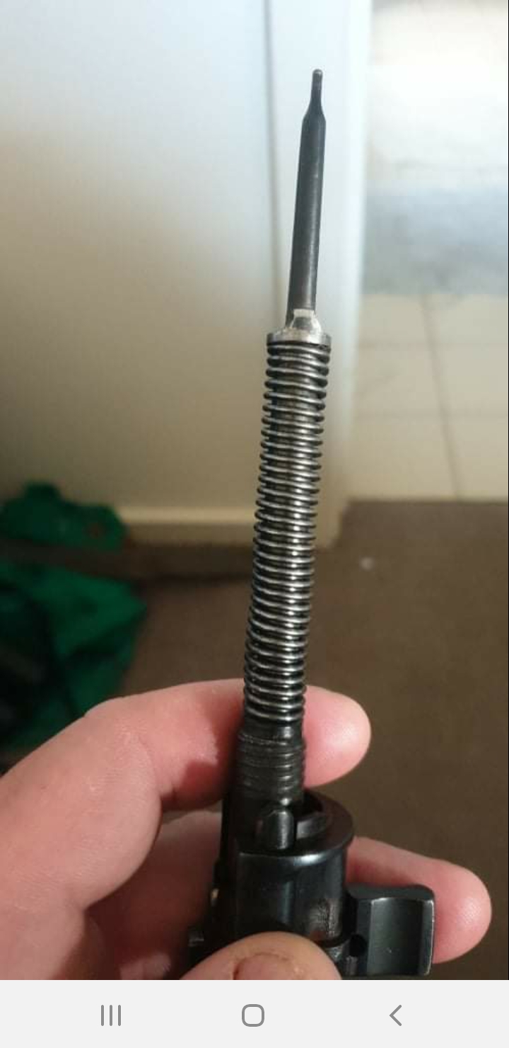

Re: Mauser 98 misfiring
Post by bigpete » 06 Jun 2022, 4:40 pm
northdude wrote:While its apart id check the firing pin to make sure its not slightly bent. See if theres any tell tale marks or burs that may suggest binding..
This is how it came out of the gun....

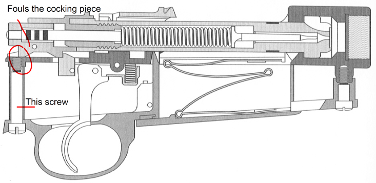

Post by No1_49er » 11 Jun 2022, 2:54 pm
I'm not at all familiar with the M98 action but I'll take a punt.
Many years ago I had a similar problem that evaded resolution until taking a very close look at the "tail end" of the rearmost action screw, where it protrudes into the raceway. A little bright spot revealed that the screw had been over-torqued and was protruding sufficiently into the raceway to, sometimes, cause a light strike / fail to fire by rubbing on the cocking-piece.
Cured it be fitting shim washer and re-torquing. End of problem.
Make sure that the screw is not protruding, even the smallest amount, into the raceway.

Post by No1_49er » 15 Jun 2022, 12:53 pm
No1_49er wrote:I'm not at all familiar with the M98 action but I'll take a punt.
Here's an image of what I had tried to describe.
Mauser M98 action showing fouling location_resize2.PNG (171.22 KiB) Viewed 18870 times
Post by JohnV » 15 Jun 2022, 1:13 pm
Yep that is correct the rear action screw can be too high in the tang and it interferes with the cocking piece moving forward . I forgot that one and I should not have because I had that problem on my Mauser when changing stocks .
Post by straightshooter » 16 Jun 2022, 6:53 am
All factory stocked M98's, both military and commercial, have a steel compression sleeve for the rear action screw. This is to prevent the effect of over tightening of the rear action screw that leads to compressed timber, a bowed action, poor bedding and the the screw protruding as described by others. This bush is sometimes missing from custom or aftermarket stocks.
Post by JohnV » 17 Jun 2022, 1:27 pm
Sounds like you are onto it , something is binding the firing pin travel .
