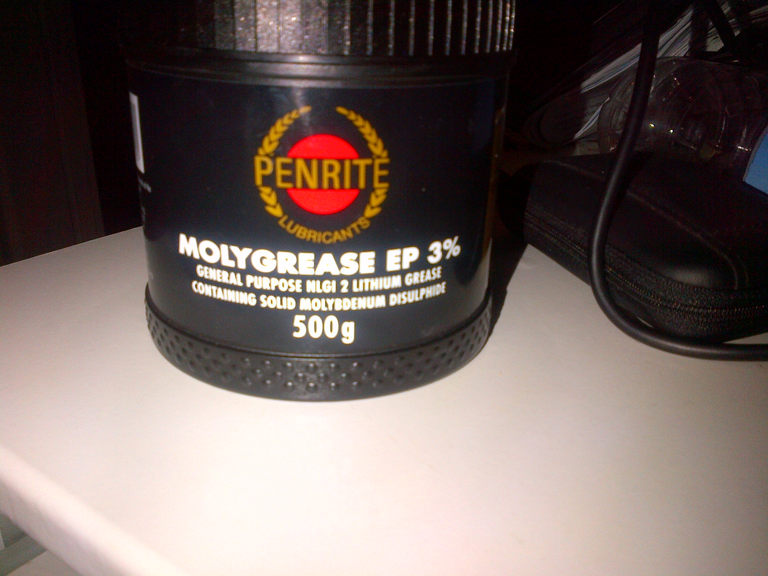

Post by petemacsydney » 10 Aug 2014, 8:51 pm
SendIt wrote:Castol Moly for me.
Any car supplies place. Super Cheap Auto, Bunnings maybe?
is this ok?
couldnt find castrol moly ;-(

Re: What grease?
Post by SendIt » 11 Aug 2014, 10:10 am
petemacsydney wrote:is this ok?
I haven't used the Penrite brand specifically but that's the right stuff.
Like I said, I only went with the Castrol because a mechanic mate gave me the tub, not because it's specifically better for any reason.
Should be fine ;)

Re: What grease for my rifle bolt?
Post by petemacsydney » 11 Aug 2014, 10:50 am
cool, thx mate
i reckon it will take me about 60 years to get through that tub!!!
