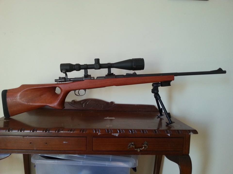

This is something I have been thinking about for a bit, I have made a couple of stocks before, my biggest concern would be, how would the laminated beam used in house construction hold up to recoil from large calibers like 25-06, 30-06, 308 etc, I have a 25-06 coming and want to make a stock for it, previously I have used Kapur, an Indonesian hardwood, it works well on my 6.5x55, I have a slab left to make another for the 25-06, but I do like the looks of the laminated stocks, here is a pic of my homemade stock on my 6.5x55
Baturb
Posts: 5

Nice work Baturb :thumbsup:
