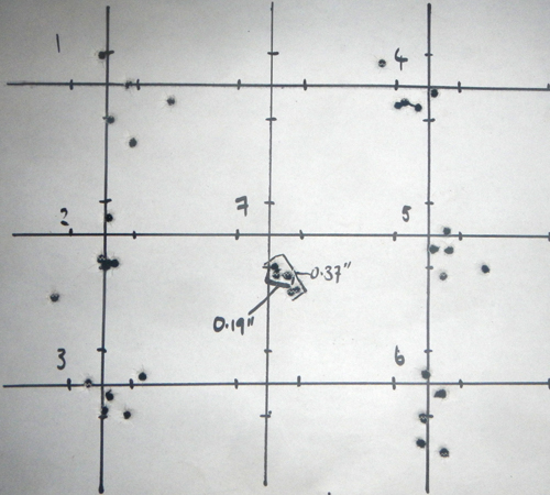

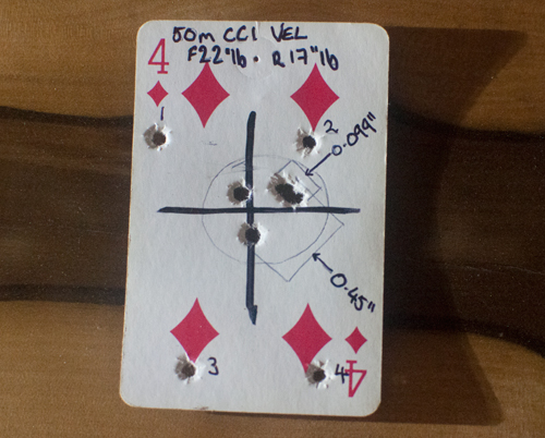

Post by Gwion » 18 Jan 2015, 7:09 pm
So i found a couple of test targets that i had saved that show the effect of action screw torque settings on 22lr accuracy.
Hopefully it demonstrated the effect well enough.
EDIT: Oh yeah, 0.224" has been removed from the measurements as per standard practice when measuring groups. I zero my calipers on a bullet first then measure outside to outside of widest point in the group.
From memory I started with around 15"lb (inch pounds) and changed one screw at a time by 5"lb (up) and then started tweeking bit by bit when it started looking ok. This was at 50m.
This one was just having a bit of fun once i had settled on a setting. 5 shot group center and then a single shot at each corner diamond. If you over lap the diamond shots it make quite a small group indeed. I can't do this every day but the rifle can. These groups are shot off home made sand (actually rice) bags.

" If you over lap the diamond shots it make quite a small group indeed. " As Harry Hoo would say " Ammazzing!

Gwion wrote:Its noticeable, Sally. Maybe made 1/4 inch at 50m on my T-bolt. Hard to say. I recently cleaned out all my test targets but will try to find an example when I get home from work.
Yeah that's quite a lot. Thought we might be talking 1/16th or something a bit pedantic like that to be honest :lol:
