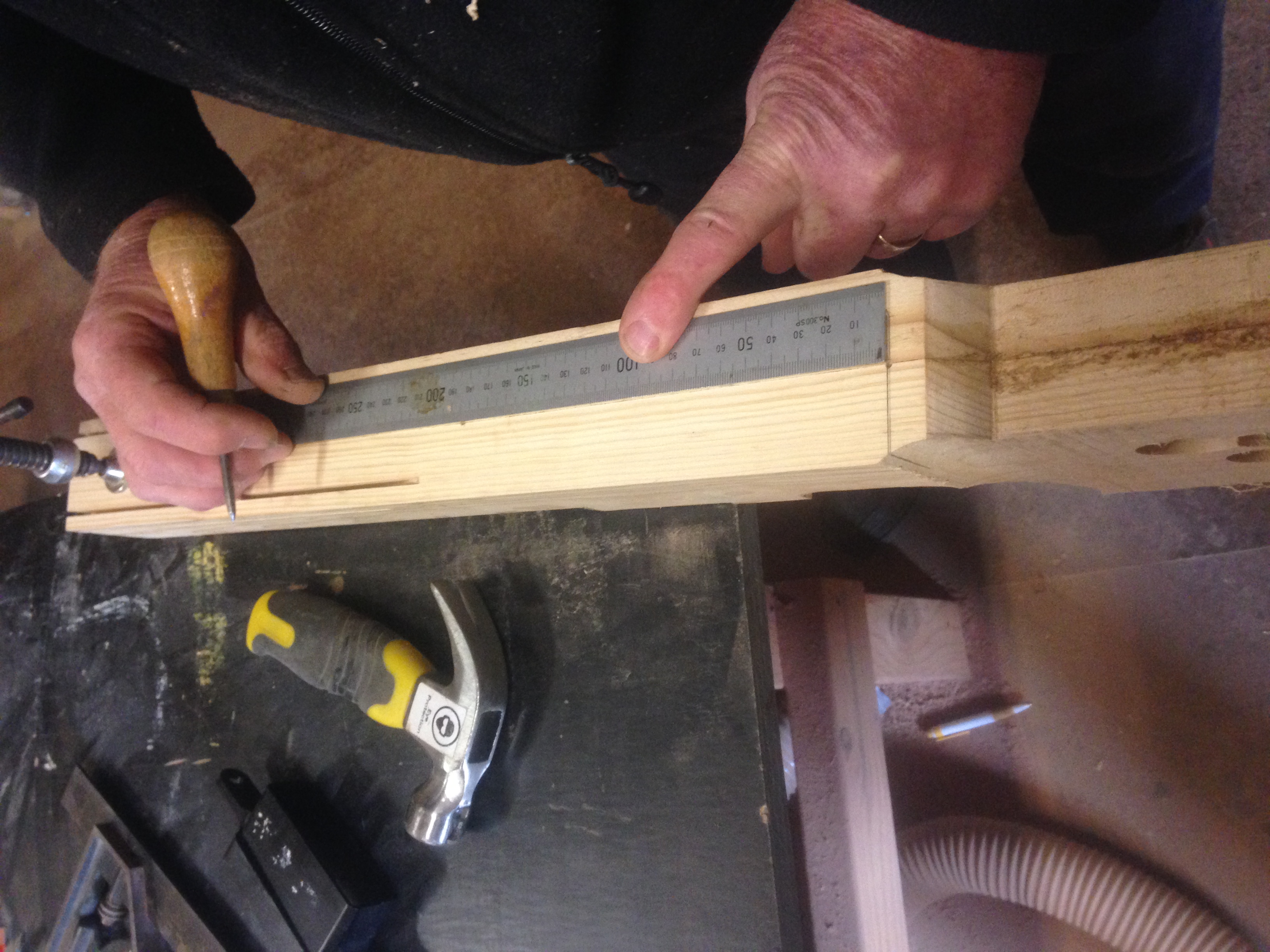

First step was drilling the action holes and making sure they were square. If you ever decide to make your own stock, this is without doubt the most critical step.
If you don't get them square and centered the rest is a waste of time.
Measure, measure and measure again
Bench drill for the win
Spade bits for angled drilling

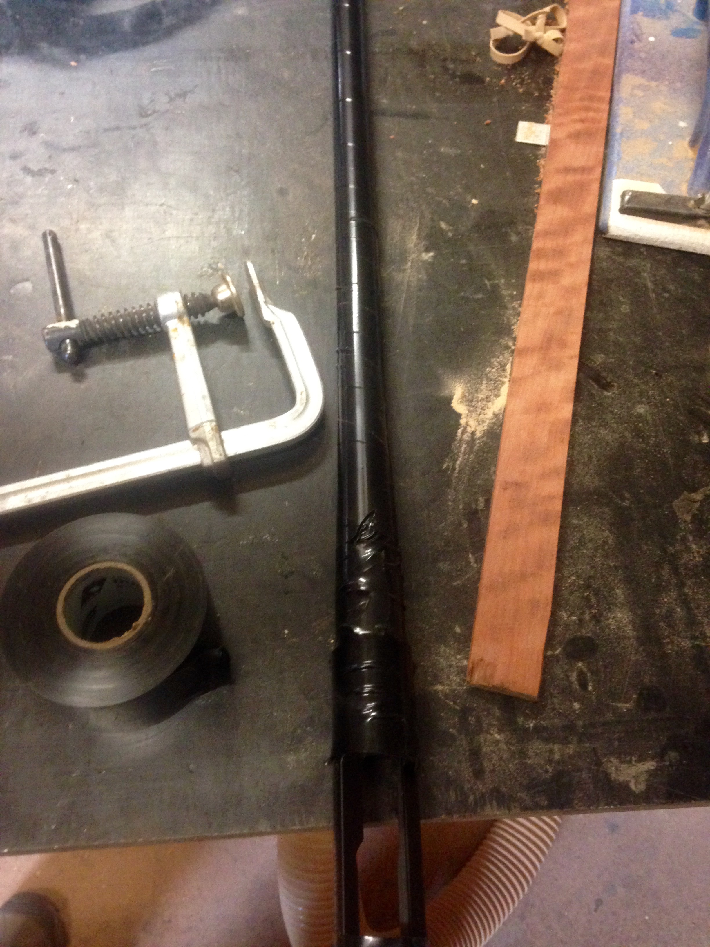

Holes done, next step was to wrap the barrelled action in electrical tape to protect it
Wrap it up

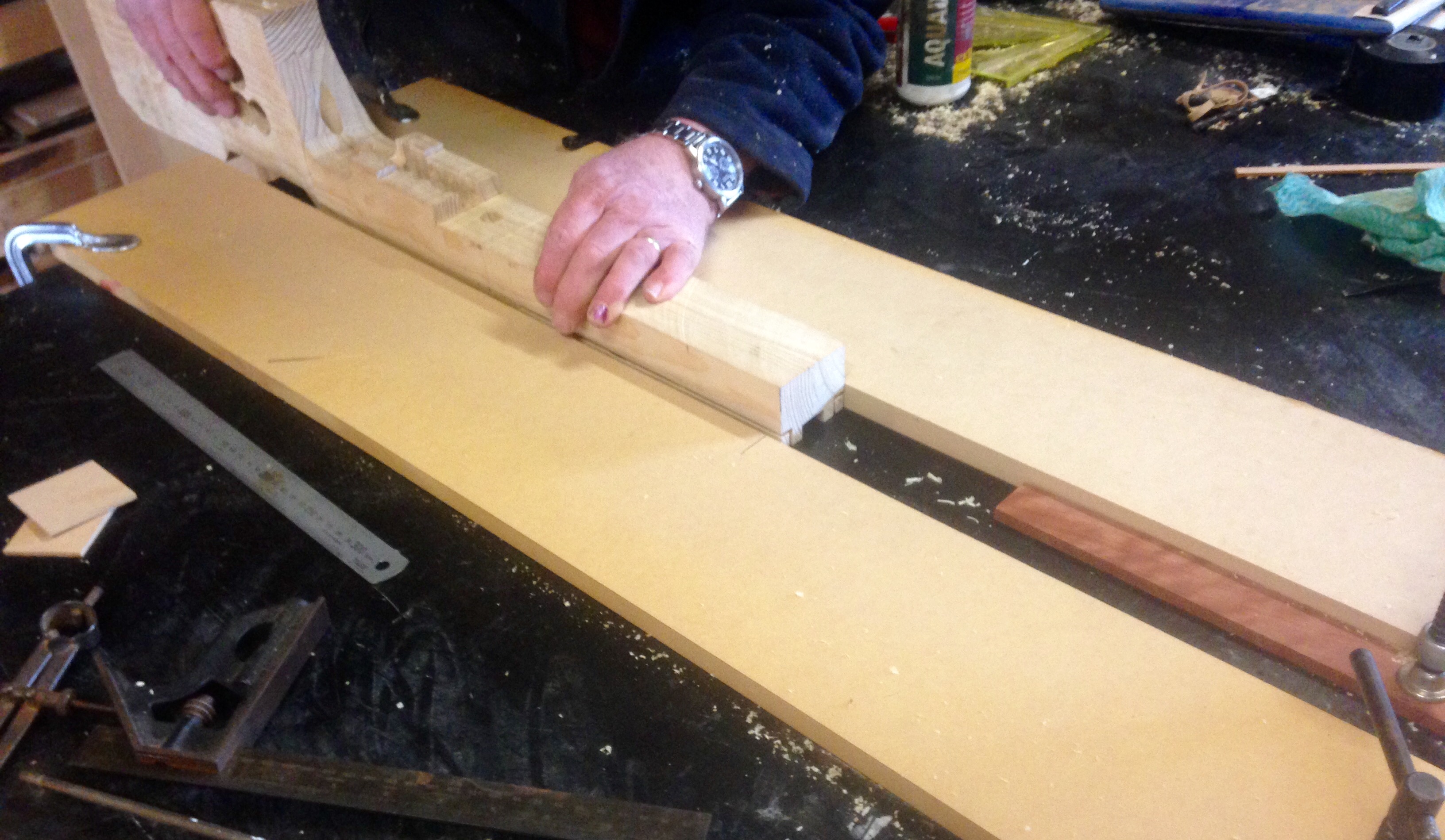

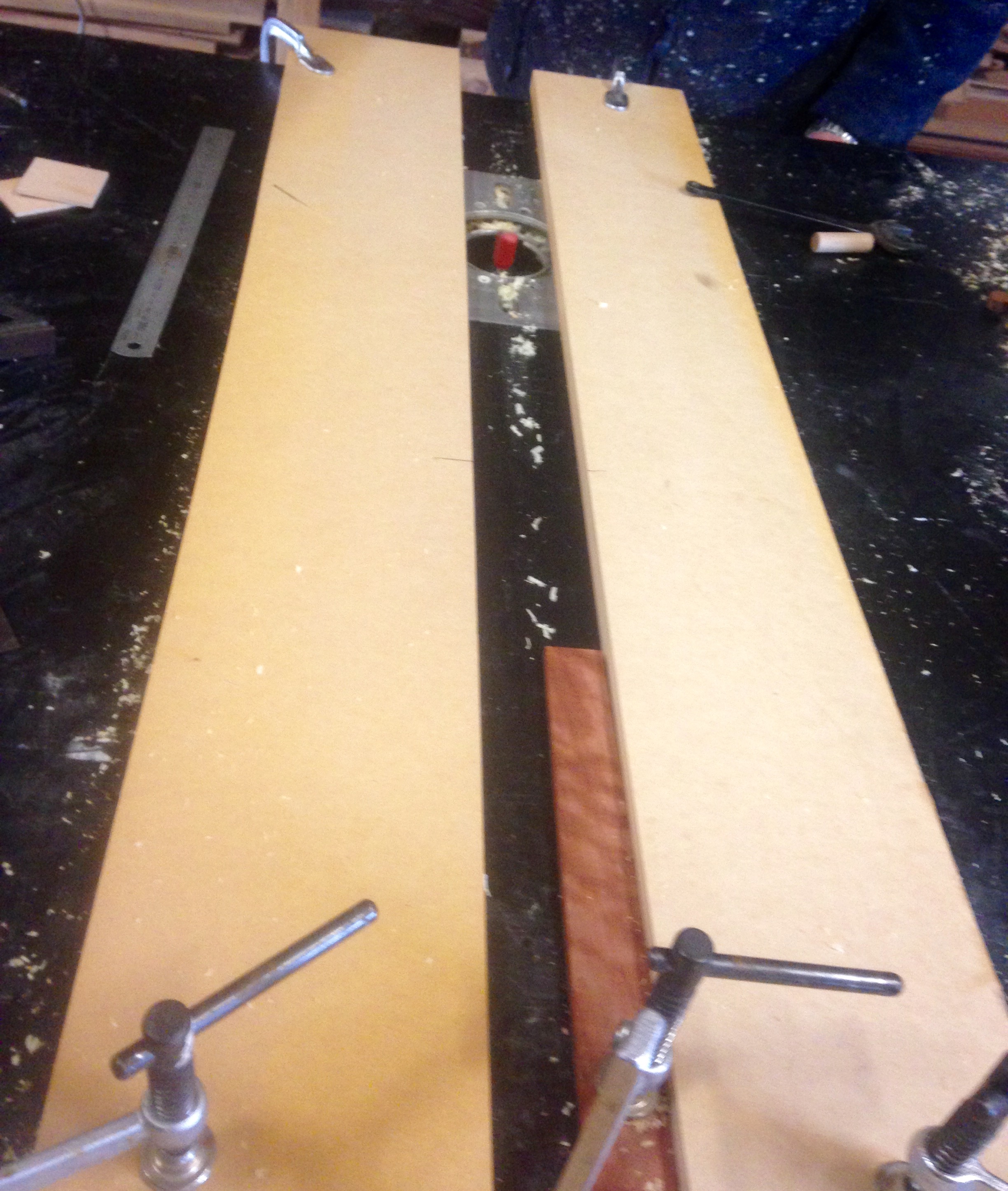

Having already marked out my centreline I set up a jig to use with a reverse table mounted router. I also set a stopper to ensure consistent lengths of cut.
Router jig
Inletting
I moved the jig in and out as required to make different width cuts. Starting at the narrowest cuts and then widening where needed.
Inletting taking shape

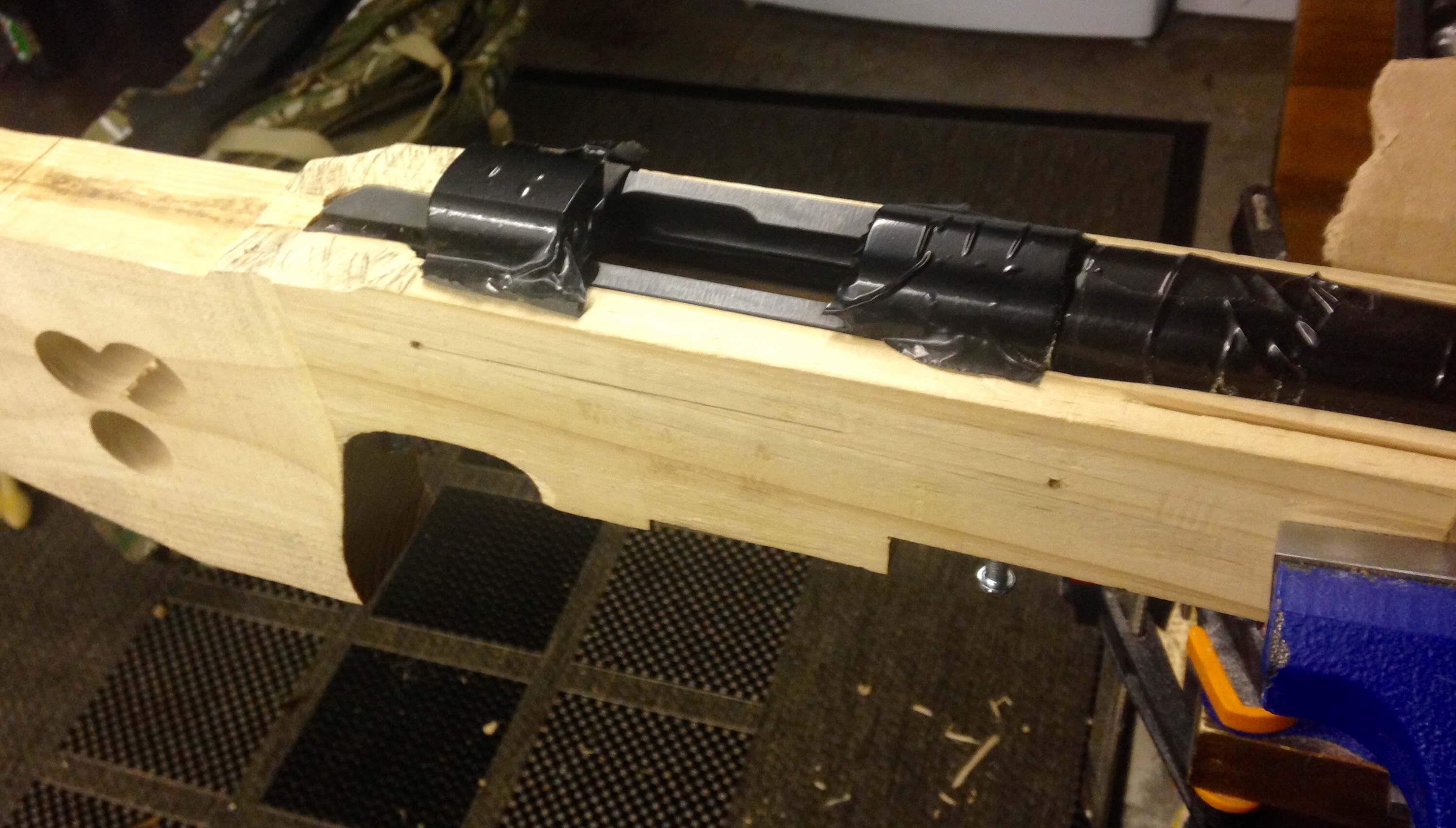

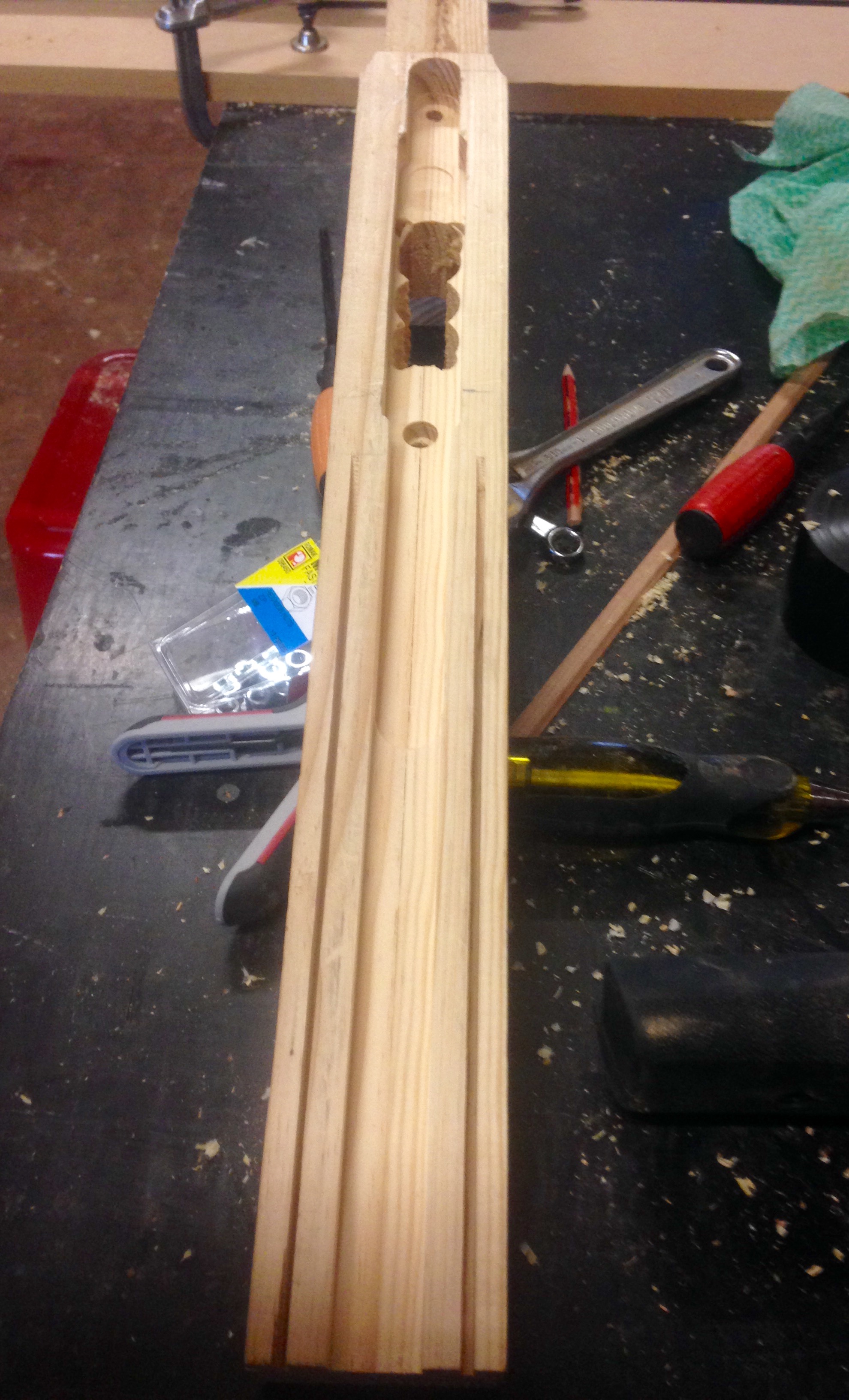

More tinkering tonight. Got the action fully seated and sitting nicely. Made a few minor errors along the way and learnt more about what order to do things in. Mainly to make sure you get all your measurements and lines done when the stock is basically untouched and square.
Opening the barrel channel
Seated

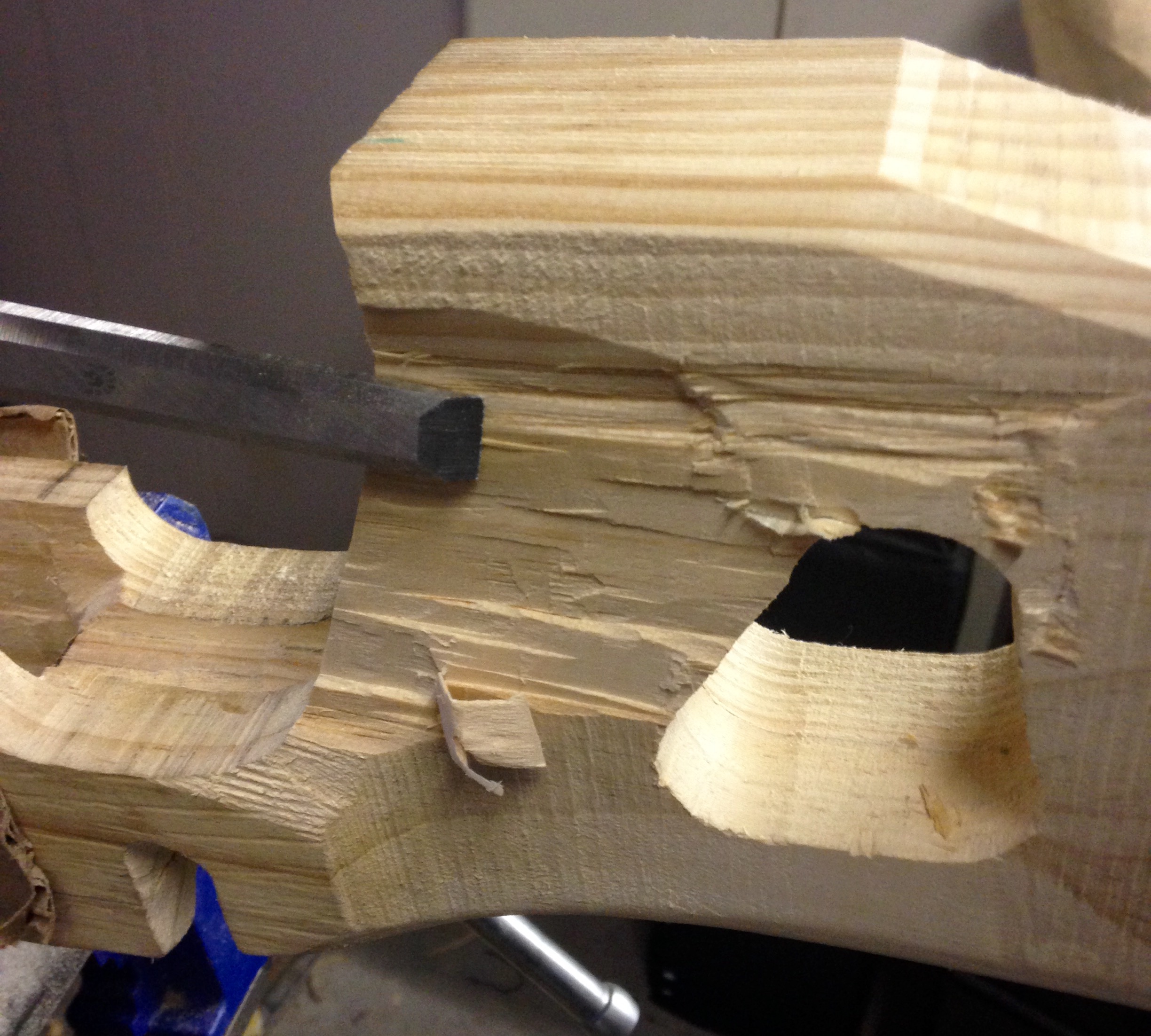

Pine ,being soft ,is also quite crumbly and unforgiving when being worked with chisels do I may need a few tiny spots of bog to touch up a few places.
I roughed out the tang area, made a bolt recess so I can work the action and have it in place when I seat the bottom metal

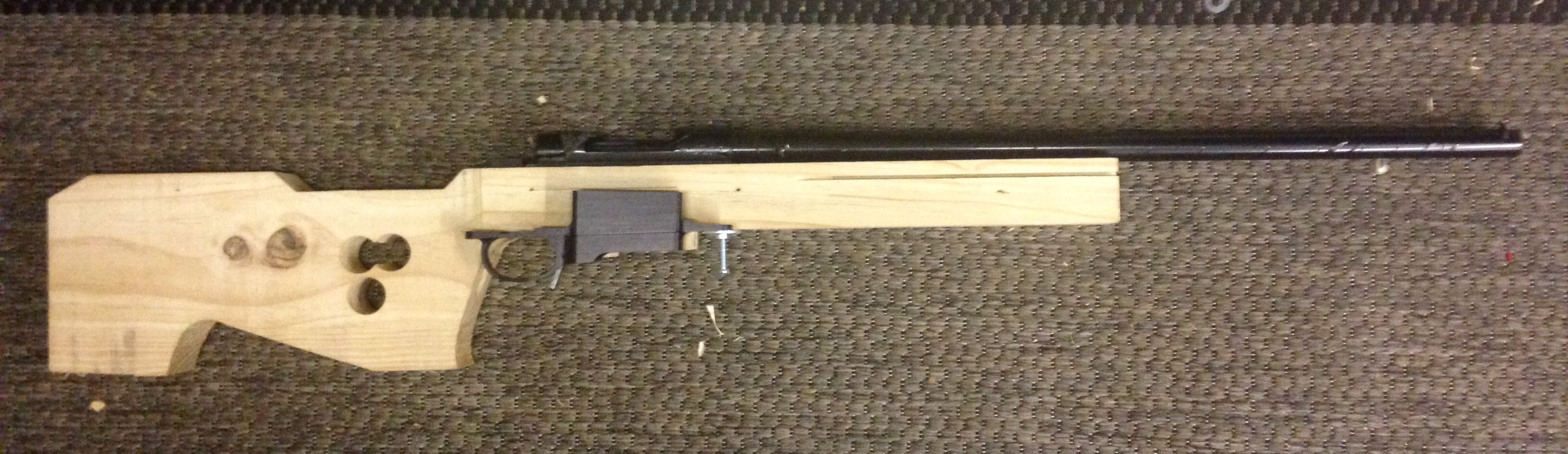

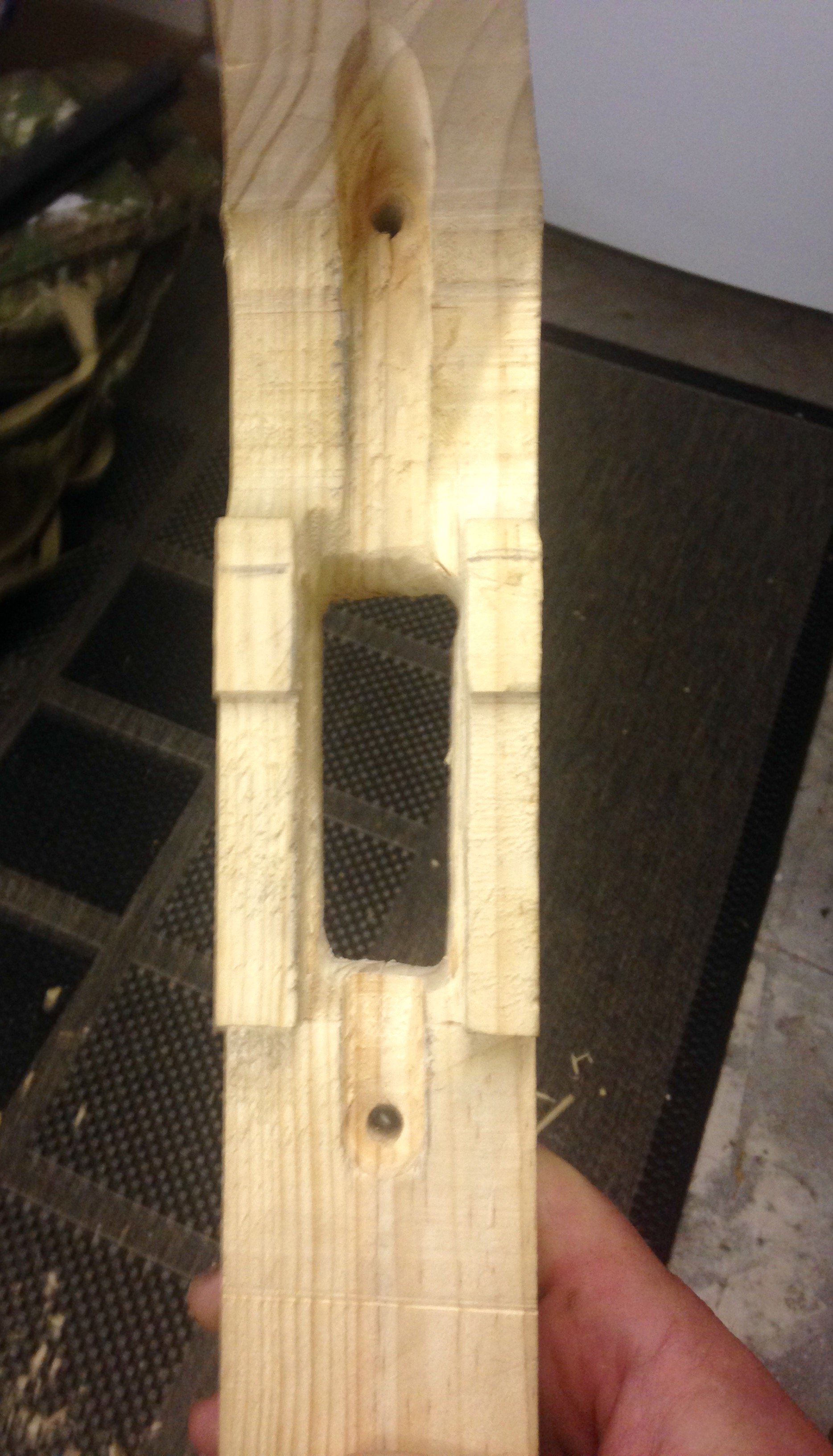

Bit more work tonight roughing out the bottom metal inletting. All done with chisels, rasps, files and sandpaper. Not 100% squared up yet but it will be in time. At the moment it's just about getting things to fit. The pine is soft and not overly suitable for chisel work but it will do.
Inletting
Bottom Metal inletting

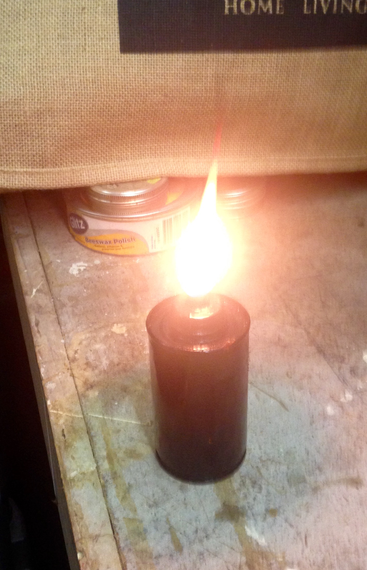

I got some lamp oil to use in a small burner so I can soot the action and fit it perfectly. As it stands, I have left the inletting purposely slightly undersized. This is so I can square it up and relieve it where needed with the help of soot.
Coming together
Action and DBM seated
The magazine is actually a .223 legacy 10 shot mag from another Howa. It will eventually be an AI steel mag when I get around to buying it.
I also attached a sling stud and bipod for visual reference.
Bipod attached.
It's still rough but I'm happy with the progress. Next step is to refine the inletting then I will begin shaping the stock.

Practised sooting the action and relieving the inletting where required. Those ol timer gunsmiths really were clever bastards. Such an effective way to do minute adjustments. I used the tin out of a tikki torch filled with lamp oil and citronella. Gives a nice steady adjustable flame and produces a lot of soot.
Tikki torch
So I got the action nicely seated and learned a few refinements along the way. Feeling confident now about inletting the final stock.

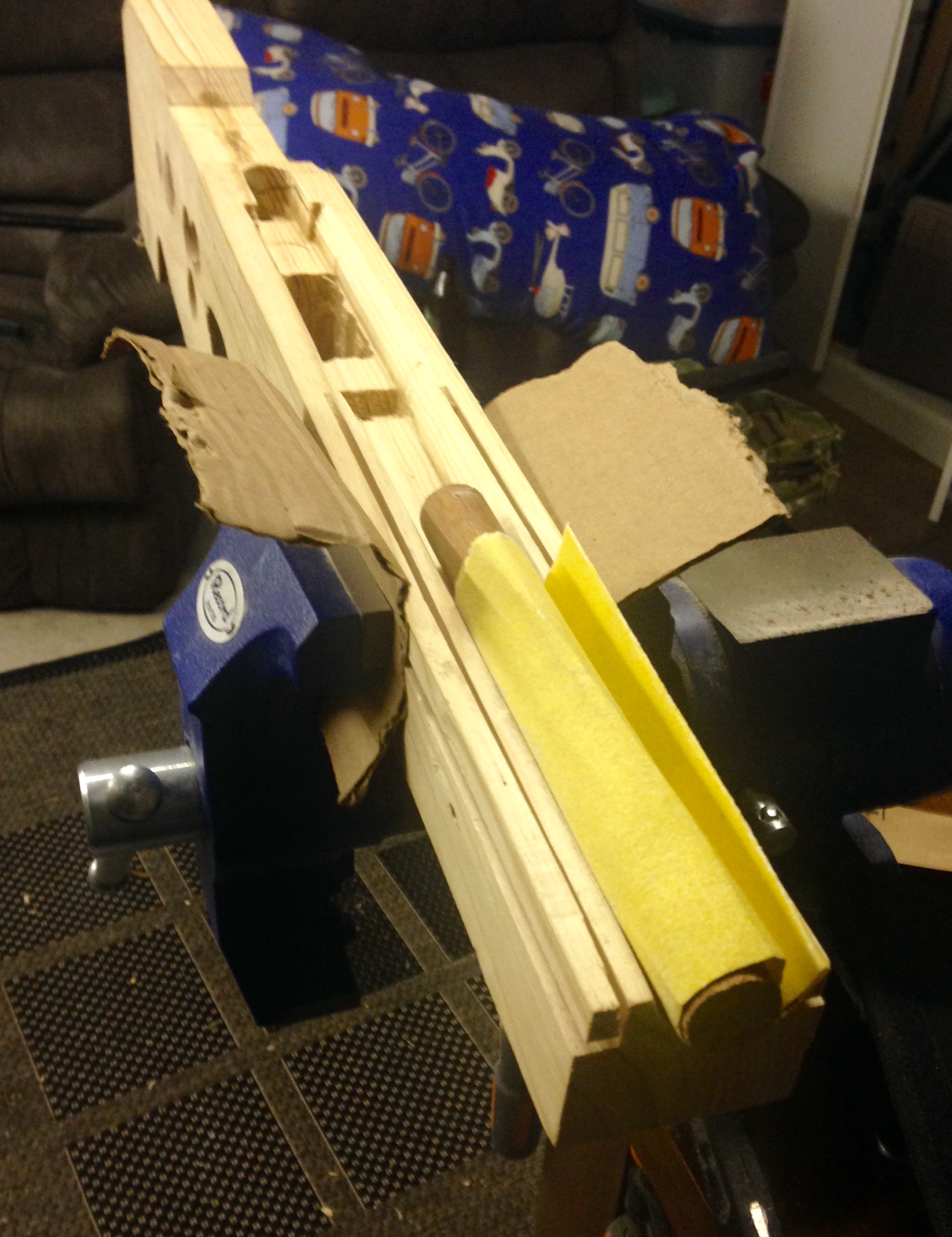

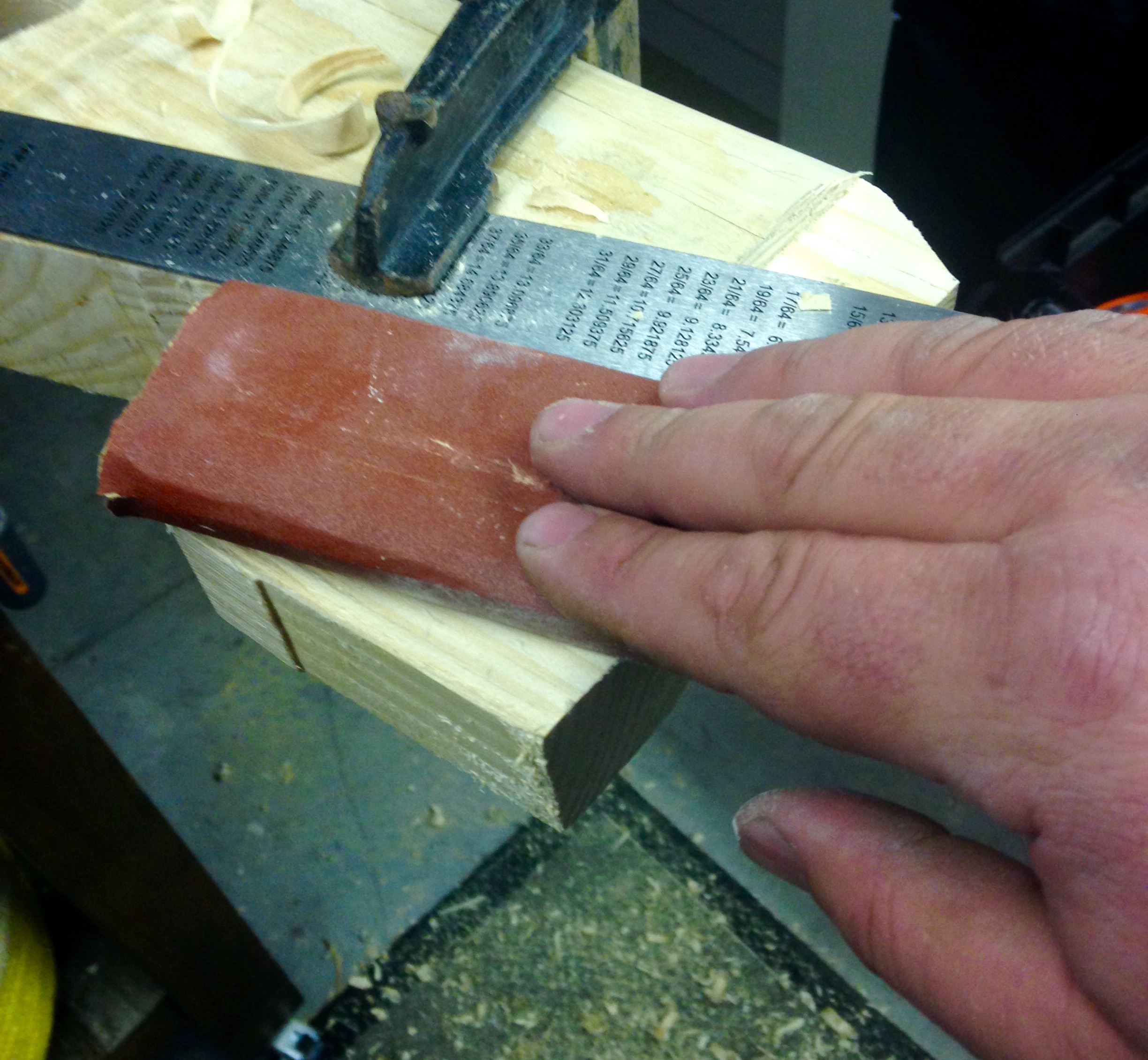

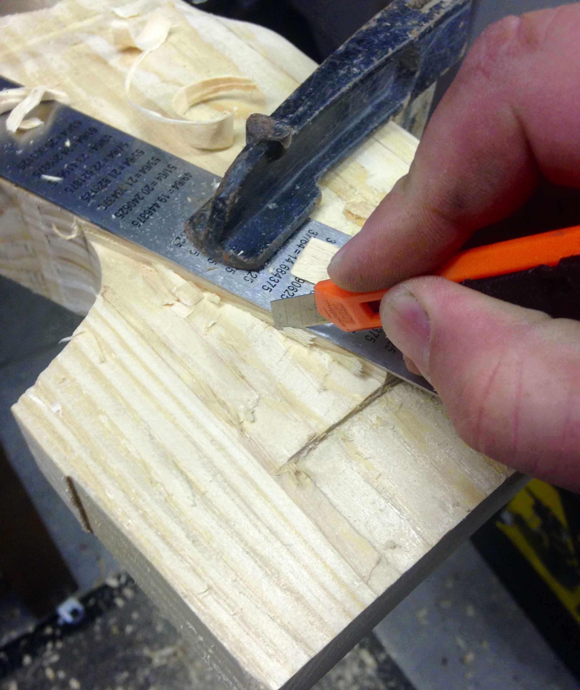

Next step was to begin put some contour and shape into the stock. Once again it's all about chisels, rasps and sand paper. I also used a sharp knife where I needed to cut across the grain. I also used a steel rule to give me straight edges and provide a buffer.
Chisel
Knife
Sandpaper
Can't complain, got a nice straight edge and recessed the buttstock nice and neat.

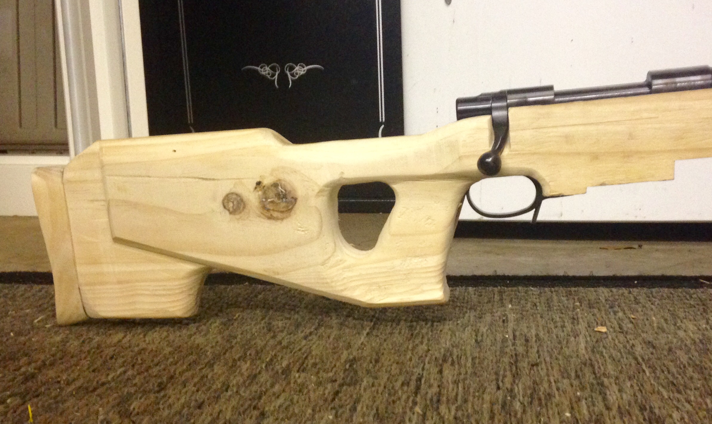

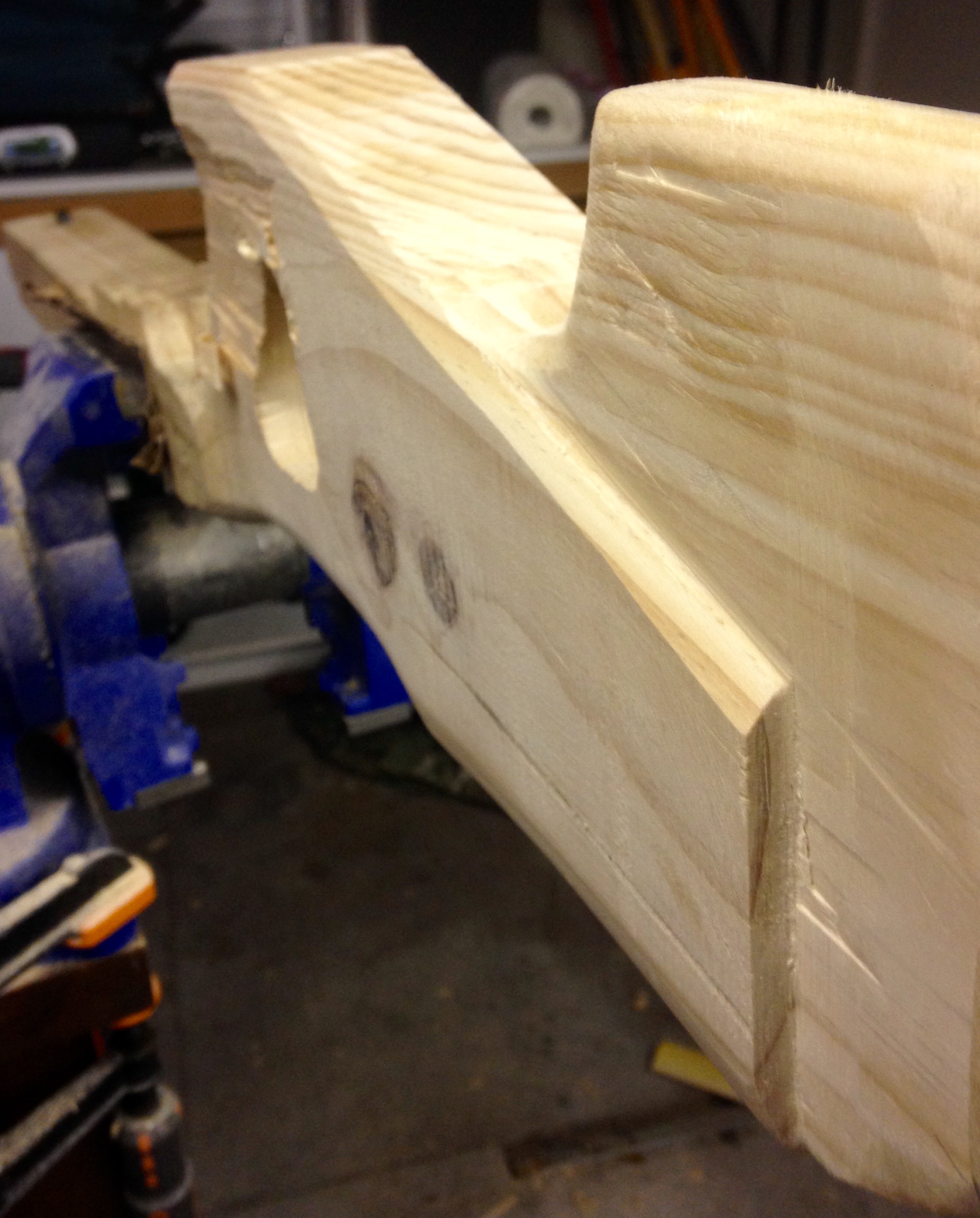

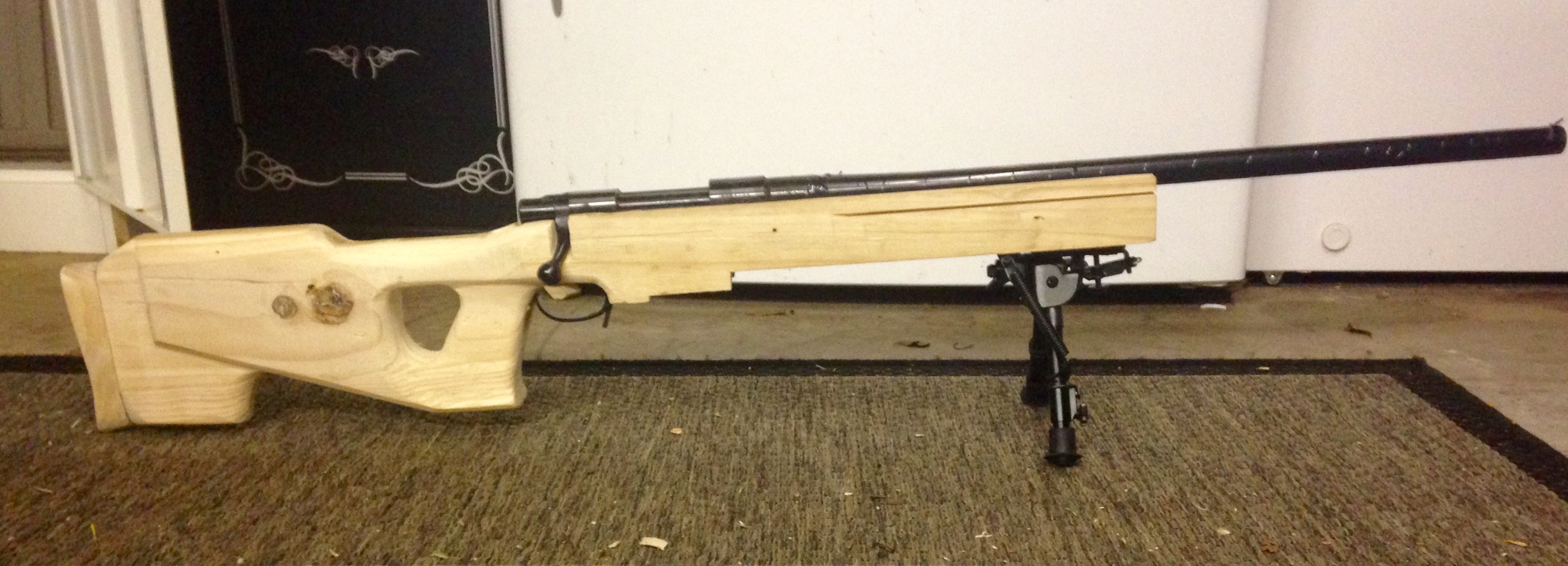

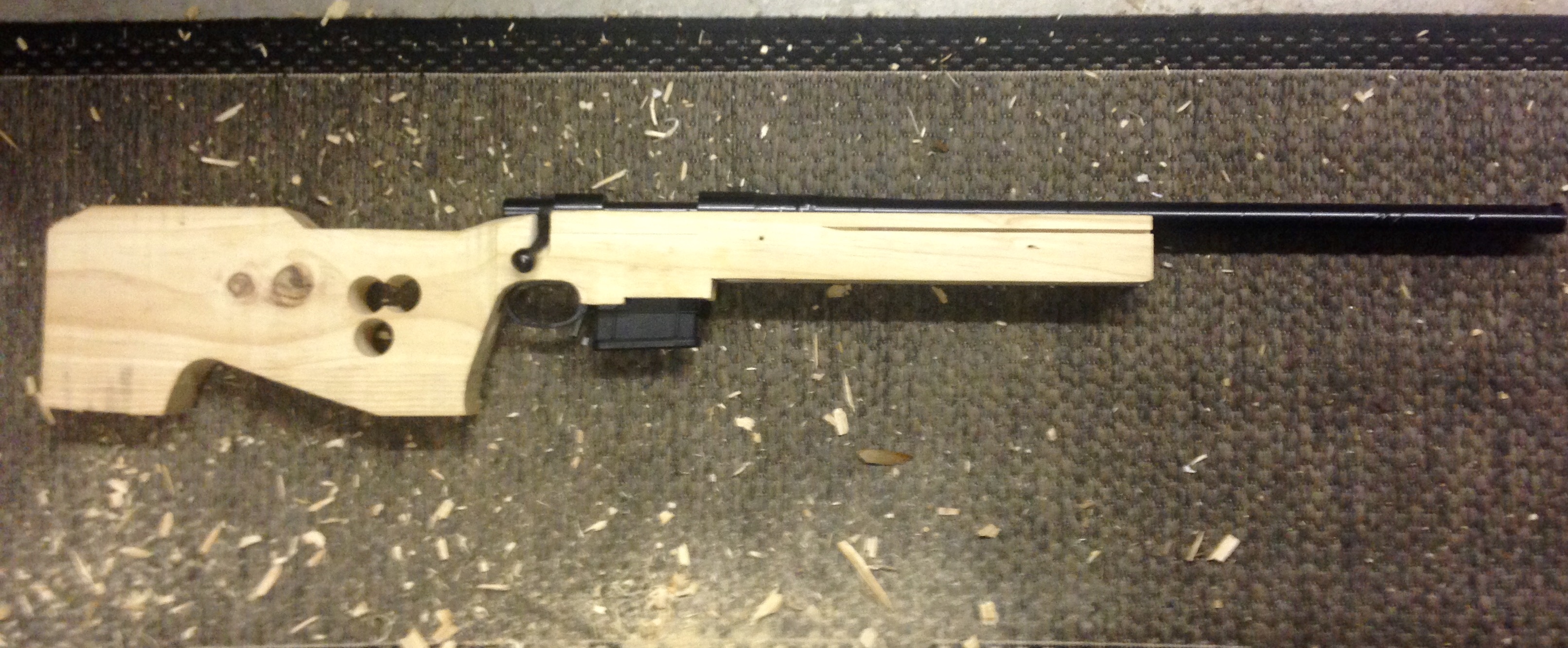

Day off for cup day so I got a bit of free time. Today I started putting some shape and contours into the stock. The idea behind my stock shape is , being a bench or prone only rifle, you grip with your right hand and your left hand tucks underneath. It will be a right hand only stock. I think it will be nice having a large grip area for my off hand.
Started out just removing some material with a chisel, getting a basic shape.
Grip
I then put some fairly sharp angles along the hip line to really give the stock a distinct shape.
Angles
This was done with a sanding block and just being careful to maintain the angle.
Butt
As well as more shaping and straightening of the thumb hole.
Butt
Mainly working on symmetry and getting the lines of the stock pleasing to the eye.

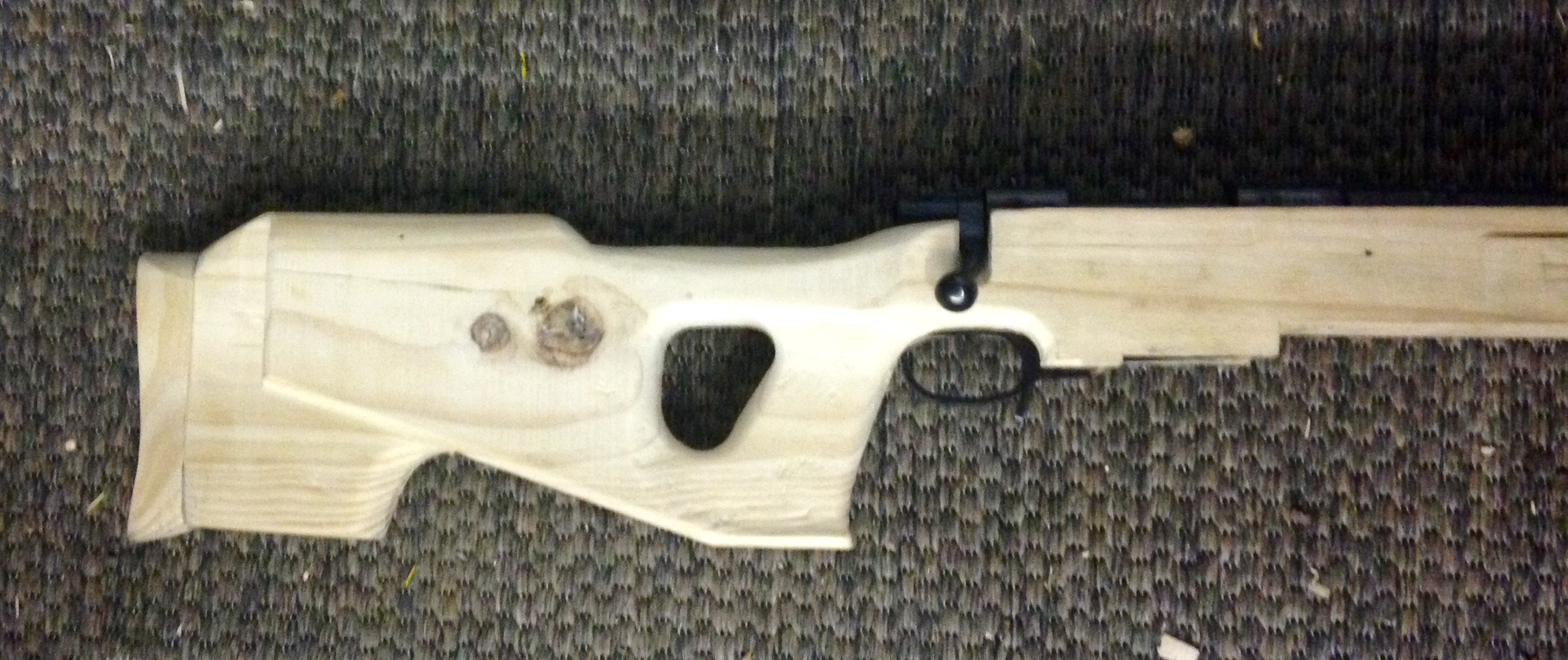

So this is my current progress. Next step will be more refinement on the buttstock then begin work on the forend.
Stock progress
Stock progress

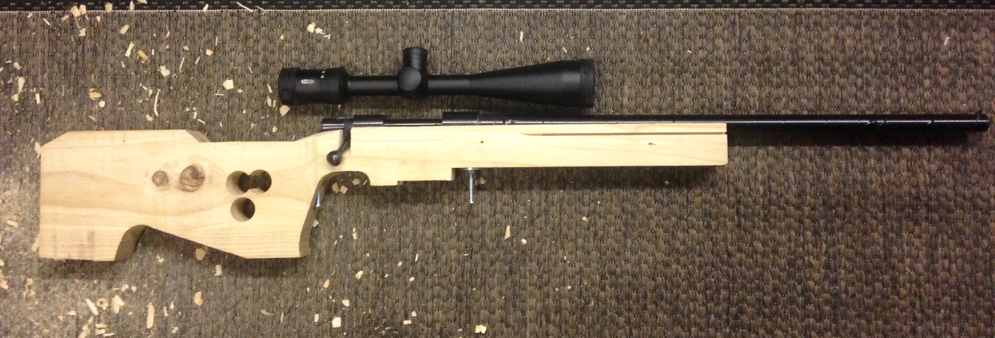

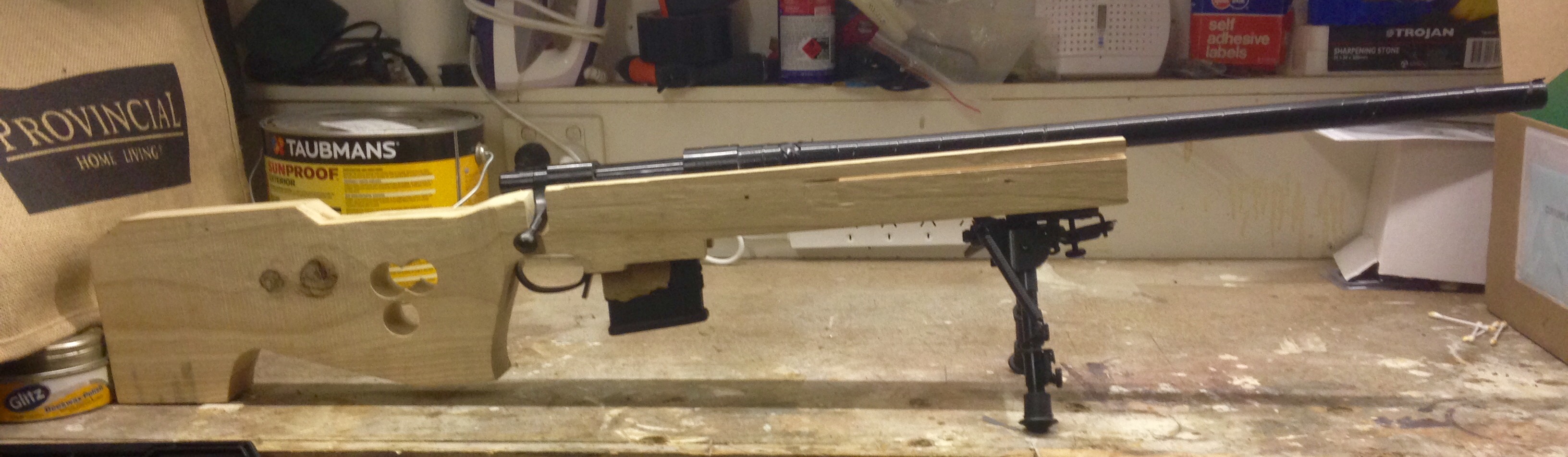

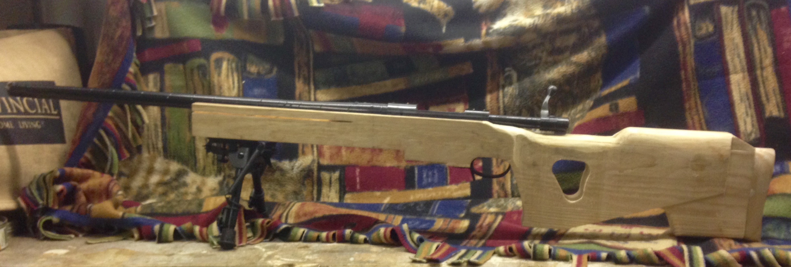

Post by Supaduke » 25 Mar 2017, 10:45 pm

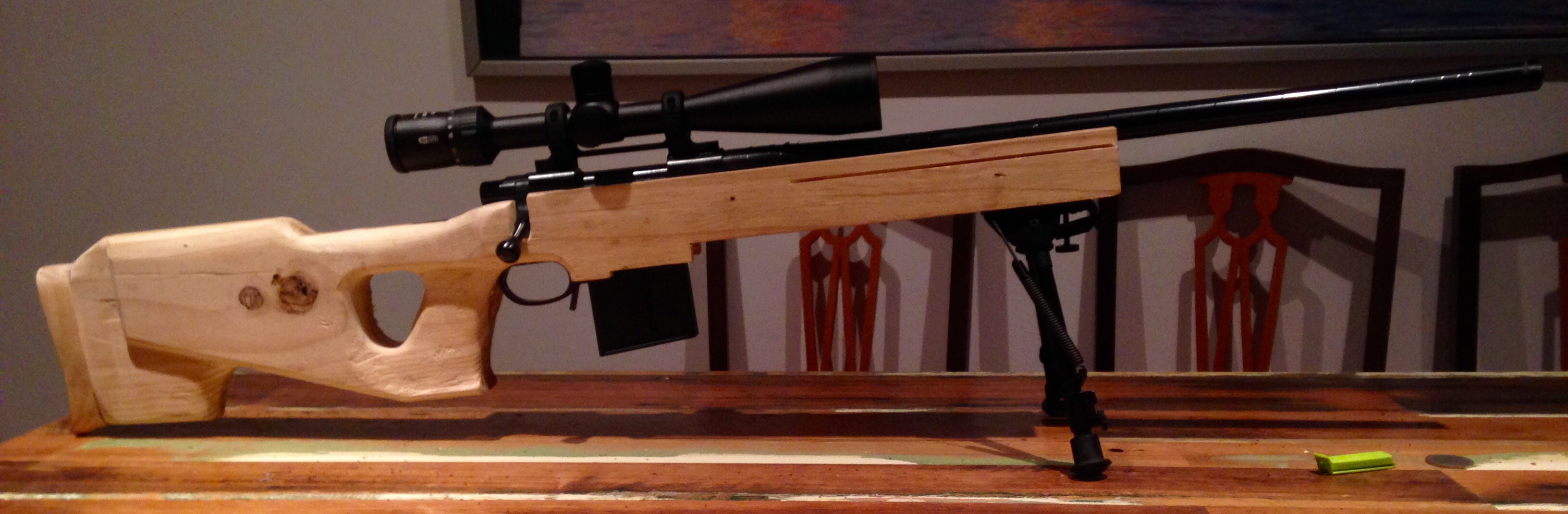

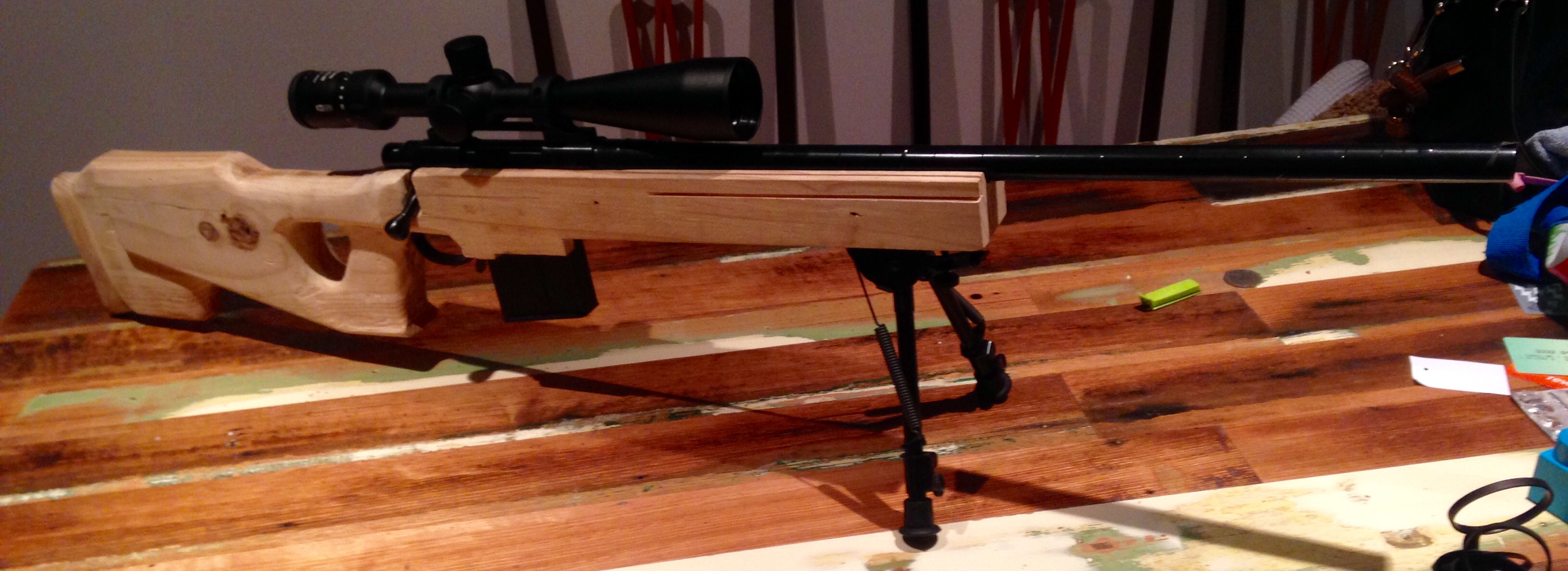

Project has been on hiatus for a few months as I have been a bit busy. Finally got around to collecting a few more bits:
- an AICS compatible accurate mag with blinder plate removed for longer OAL.
- a DNZ one piece scope mount, have heard good things, thought I would try one.
Got it all mounted up and I'm quite pleased with the overall look and feel. A few mods to make now that I have a bit more hardware mounted.
Will need to shorten the length of pull by about 10-15mm as I'm not entirely satisfied with the current eye relief.
The comb will need to be lowered about 5-10mm as I'm having to adopt an unnatural position to get my eye lined up with the scope.
The whole action needs to move about 5mm forward or bring the handle back about the same distance to get a more relaxed trigger pull. Currently my finger feels slightly crammed up in the trigger guard.
Grip handle needs to be reduced in both width and length for a slightly more comfortable feel and to be able to wrap my thumb a bit further around.
Still deciding on what shape the forend will be
Next bit of hardware will be an atlas bipod and piccatinny mounting rail.
Anyway here is where it's at.
P.S there is electrical tape wrapped around the barrel to protect it in case you were wondering.
