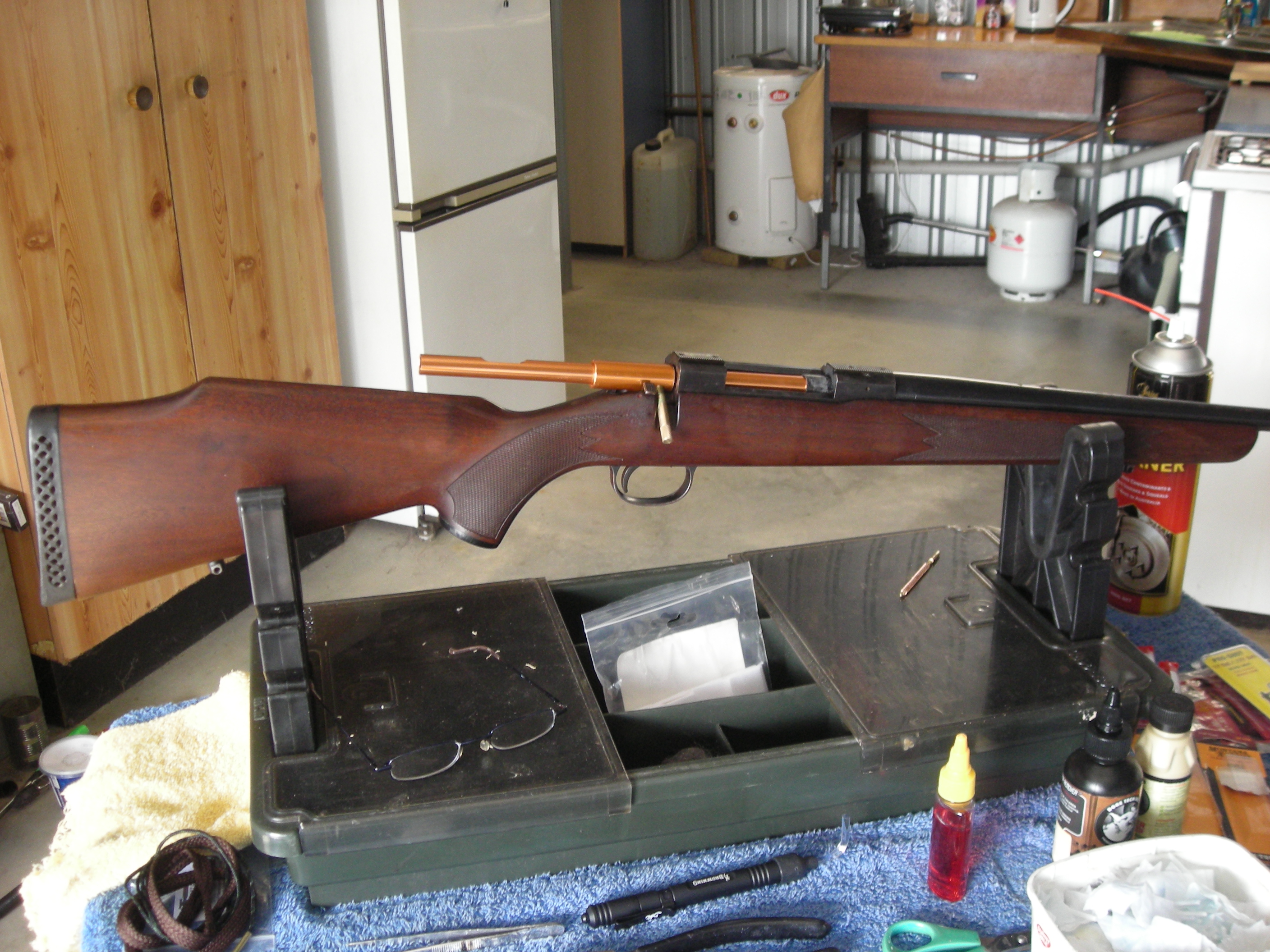

First job was to do a bit of inletting, and then bed the new stock to the barrel and action. But the previous stock owner had refinished it at some stage, and the inside had a good coat of what I suspect was Tru Oil. So I figured it had to go first, so I stripped the stock fully, which I was going to do eventually anyway. It was an ok job, but it could be better.
Given the stocks were bot short action stocks I expected them to be the same, and that it would fit straight away, but that was not the case. More work then I expected, but it the end it fits nicely.
This is my bedding method, using JB Weld. No doubt there are other opinions on how it should be done, but for a sporter I think this is ok.

A bit of touching up with the stripper was needed. Interesting the previous finish did not bubble up like I have seen previously. Strange.
My new Ryobi linisher. Handy for this job.
This is a Limbsaver "grind to fit" recoil pad. With common rifles you can buy pads that fit perfectly, but not for mine. This pad gives a very nice result, just a lot more work! :problem: I have used one before, so knew what I was up for, hence the linisher. I used a different method this time, and ground it to shape when fitted to the stock. Obviously you have to be very careful this way, but getting the profile to match the stock is much easier. So slow and steady is the go. I needed a 220-240 belt to finish it, but only found a 120 at Bunnings, so I had to finish it off by hand. More work! :crazy:
Recoil pad turned out well, so now on to the stock. After a light sand a good steaming, it came up pretty clean. A few dings in it were able to be removed, so now it will need sanding with various grades of paper and then finished off with 0000 steel wool before the Tru Oil can be applied. Some time consuming work now, to be done when time permits.

Stock has had a lot of work, and is now getting the final coats of oil. Looking good I reckon.
But there is one problem that I am yet to fix. I am not liking the factory bolt knob.
Here is my LSA55 bolt, which is much better. It is one piece, where the M55 has the plastic knob that screws on.
So the plastic knob needs to be deposited in the rubbish bin, and a nice replacement fitted instead. Some googling turned up nothing I wanted to fit, so I will have to make something. Hopefully, whatever I make wont end up in the bin as well. :roll:

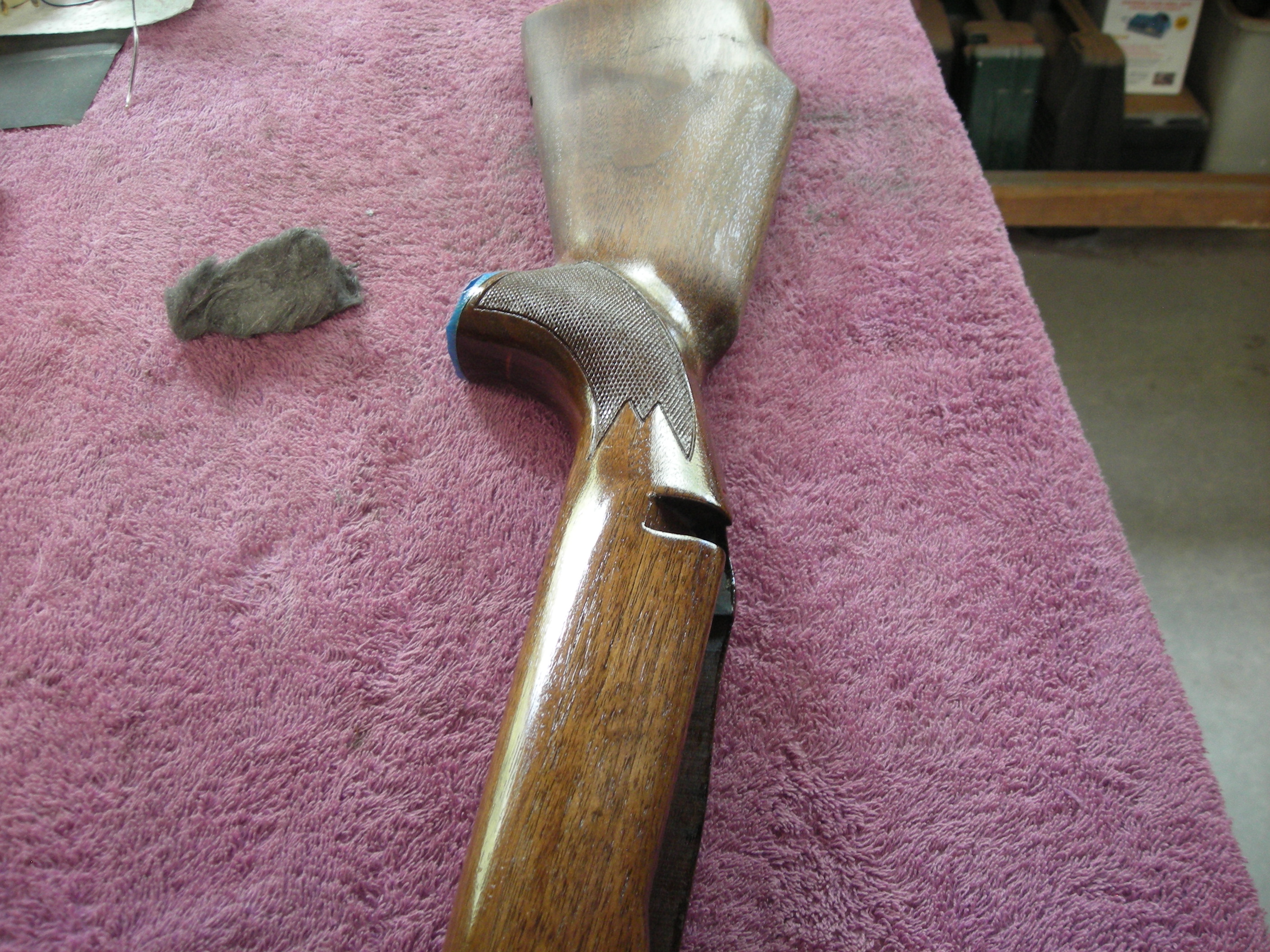

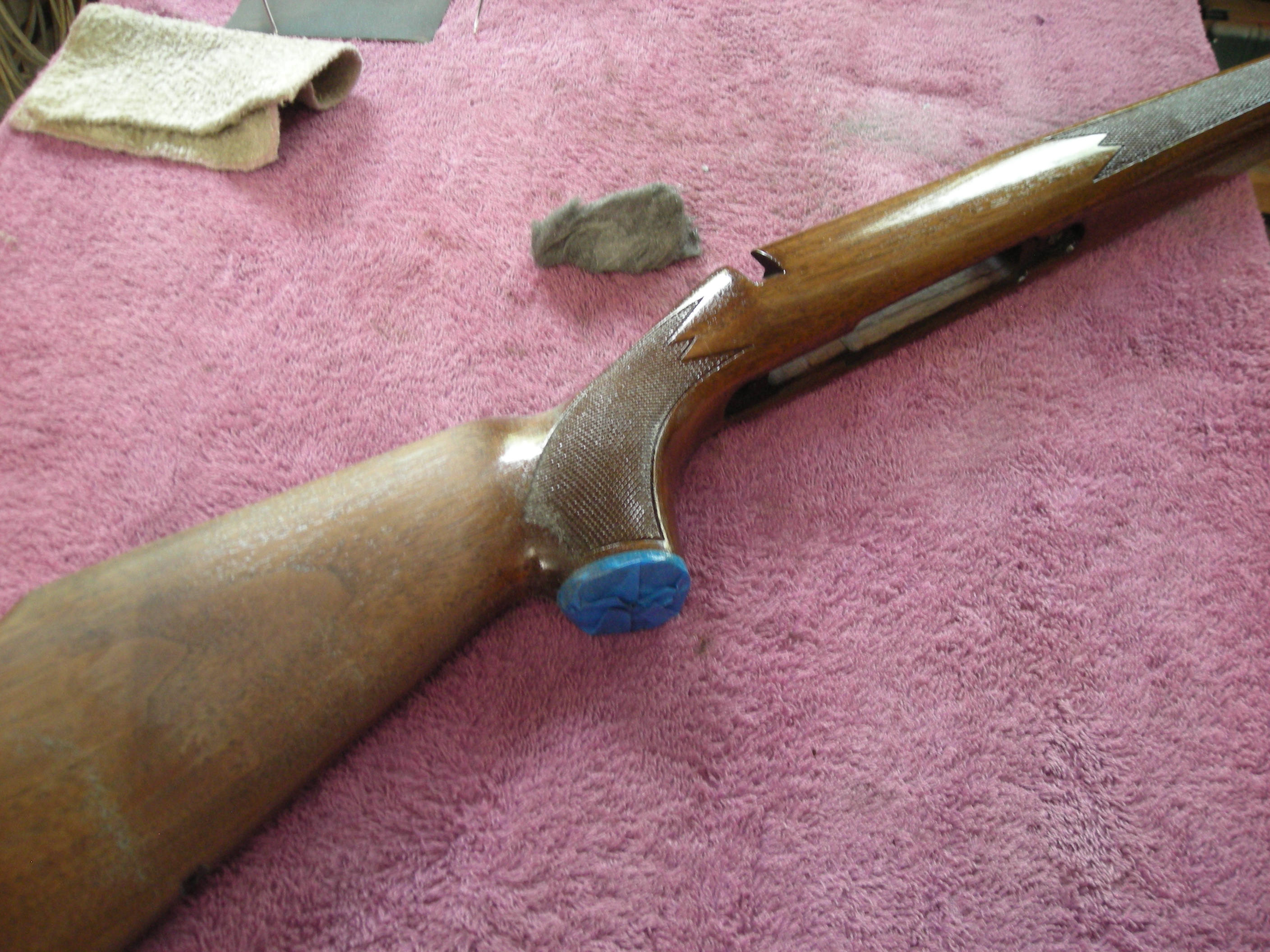

The original stock I have no use for, so it was always going to be sold off later. But I had intended to re-finish it first. No point trying to sell an old, well worn stock to some that already has an old, well worn stock. :crazy: Better if it is tarted up a bit, and given that I have had some practice with doing stocks, no big deal.
As you can see from an earlier photo, the standard M55 stock is not a bad thing. Not a lot of grain, but stained nicely.
I decided to strip it back to bare timber to see what it was like underneath. I reckon compared to the Deluxe stocks it obviously has less figuring, but also I think they are finished to a lesser standard. Basic finishing, and then stained and a grain filler and sealer used before the final coating. When I stripped it back, there was a lot more open grain than the fancier stocks I have done, and it took more work to bring it up to similar standard. I have decided to put the work into the timber, no stain, and no filler. So lots of sanding, wet sanding, and rubbing back, to get a nice finish
So far it is looking quite nice, and something different to a standard M55 stock. Getting rubbed back again here, ready for final coats. The rubbing back with the ultra fine 0000 steel wool is probably the hardest part. Plenty of effort, and it takes about an hour and a half each time. Gets a good sweat up!
