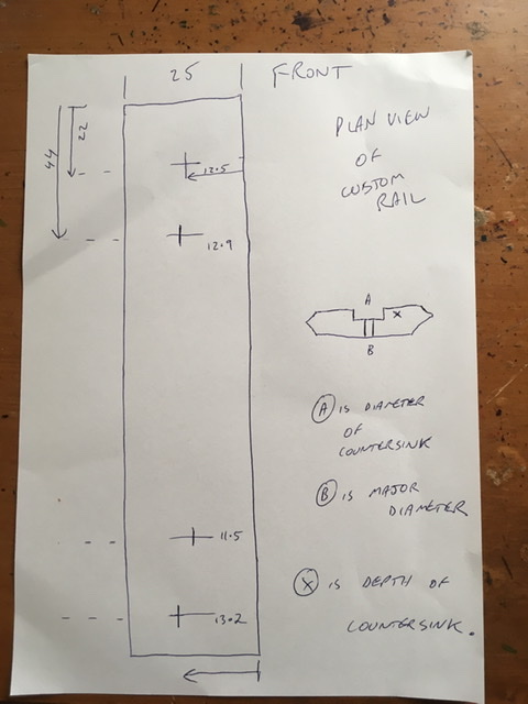

Been a while since I posted a pic hopefully this works

If u post me an alum rail with accurate measurements I can put New holes in the right spots to suit your crooked line up This pic is just an example. Measurements should be to the nearest tenth of a mm , or in thou .. you would have to work out a very accurate method for measuring your existing line up And the shape of the csk hole is important too . A sample screw would be ideal

Blr243 wrote:If u post me an alum rail with accurate measurements I can put New holes in the right spots to suit your crooked line up This pic is just an example. Measurements should be to the nearest tenth of a mm , or in thou .. you would have to work out a very accurate method for measuring your existing line up And the shape of the csk hole is important too . A sample screw would be ideal
Mate thank you for that. Sincerely appreciated and of course I am more than happy to remunerate you for your time. I am away at present but will see what I can do when I get home.

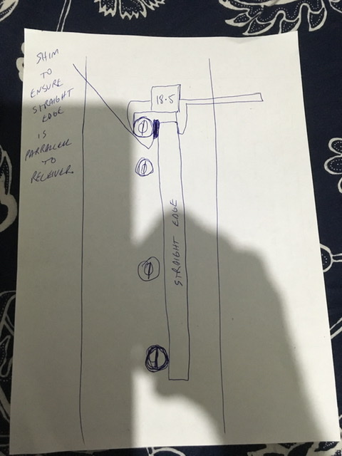

I have been thinking of the best way to accurately measure the deviation of each screw hole. Attached here A plan view sketch a straight edge shimed to ensure its parallel with the receiver... then calipers to hook onto the straight edge and the outer edge of the screw . Then I could make a .6 mm sheet metal Preliminary template and post it to u .... if spot on then I could make the real deal with the actual rail ... and a slab of beer for my next trip to the cape would be fine

Post by JimTom » 08 Mar 2022, 7:17 am
