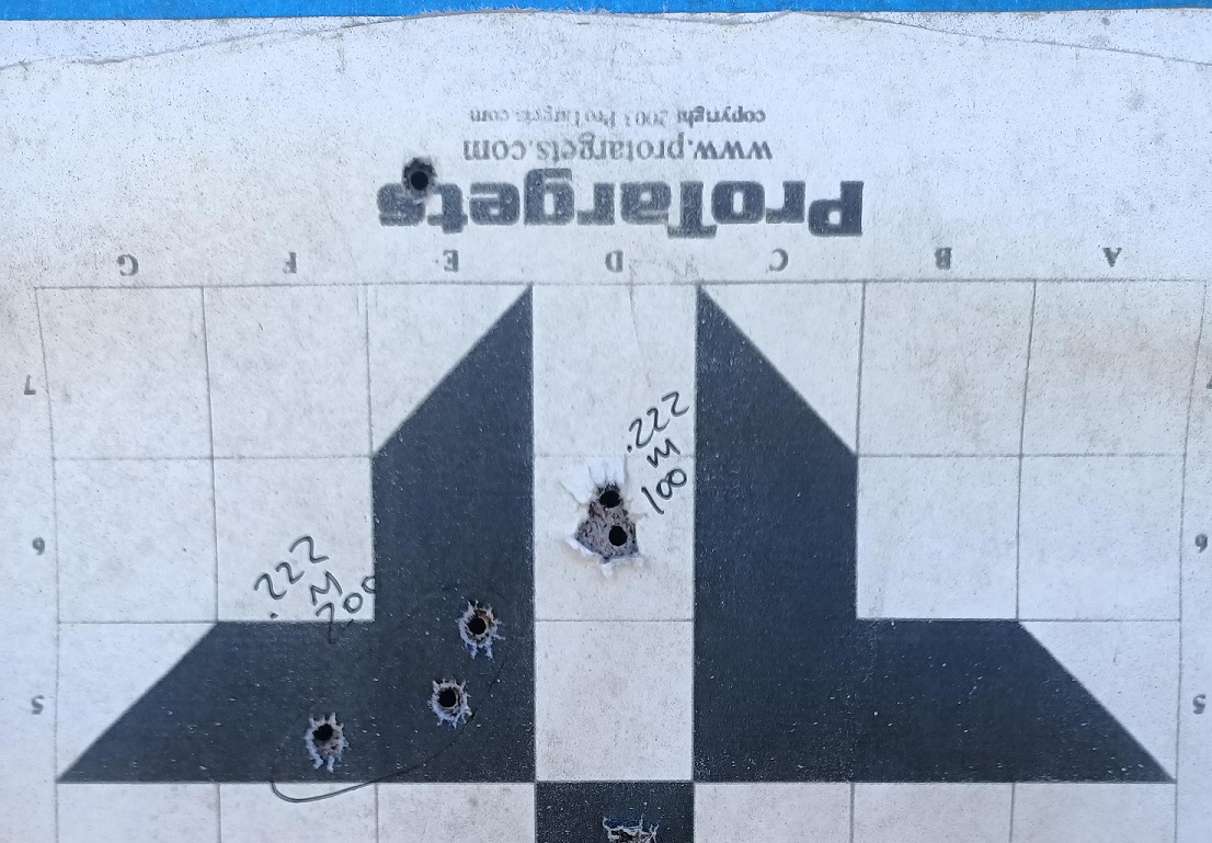

Re: .222 Magnum build
Post by Am88 » 14 Dec 2020, 12:27 pm
Shoots pretty flat, each square is an inch, 3 shots at 100m 1 of which was a clean patched barrel, top 2 are in the same hole, then 3 shots at 200m. Not making excuses but I only have a fixed 7 power on this and had the morning sun shining at me :lol: was actually pretty hard to see that thing at 200 not gunna liethe crosshair filled the lines up a little too much so I was just doing my best. Not sure on velocities but it seems to be up there with these results according to Strelok and the bullet BC, Approx at least.
After all the rubbish I went through I cant believe seating depth changed the whole outcome.
Am88
