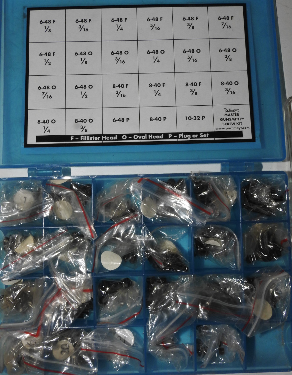

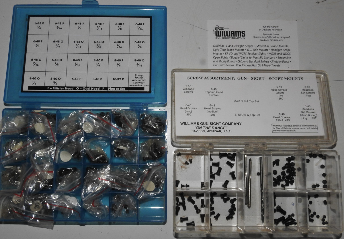

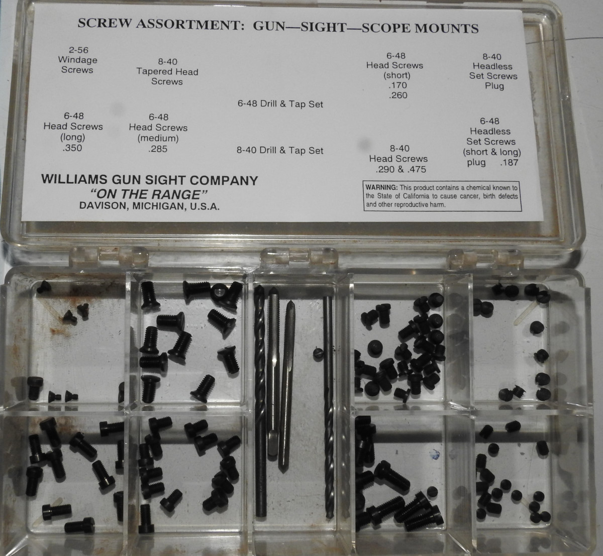

Screw sets:
https://www.brownells.com.au/index.php? ... anu_id=798
(Torx head)
https://www.brownells.com.au/index.php? ... nu_id=1350
(traditional styled slotted heads)
Attached images are my 2 screw sets; One from Williams, and one from Pachmayr. The later Pachmayr sets as listed on Brownells seem to use Torx heads.
From a quick look, I dont think my Pachmayr set have any countersunk heads in the set; the Williams set does.
I hope this helps.
Cheers,
Rod.
