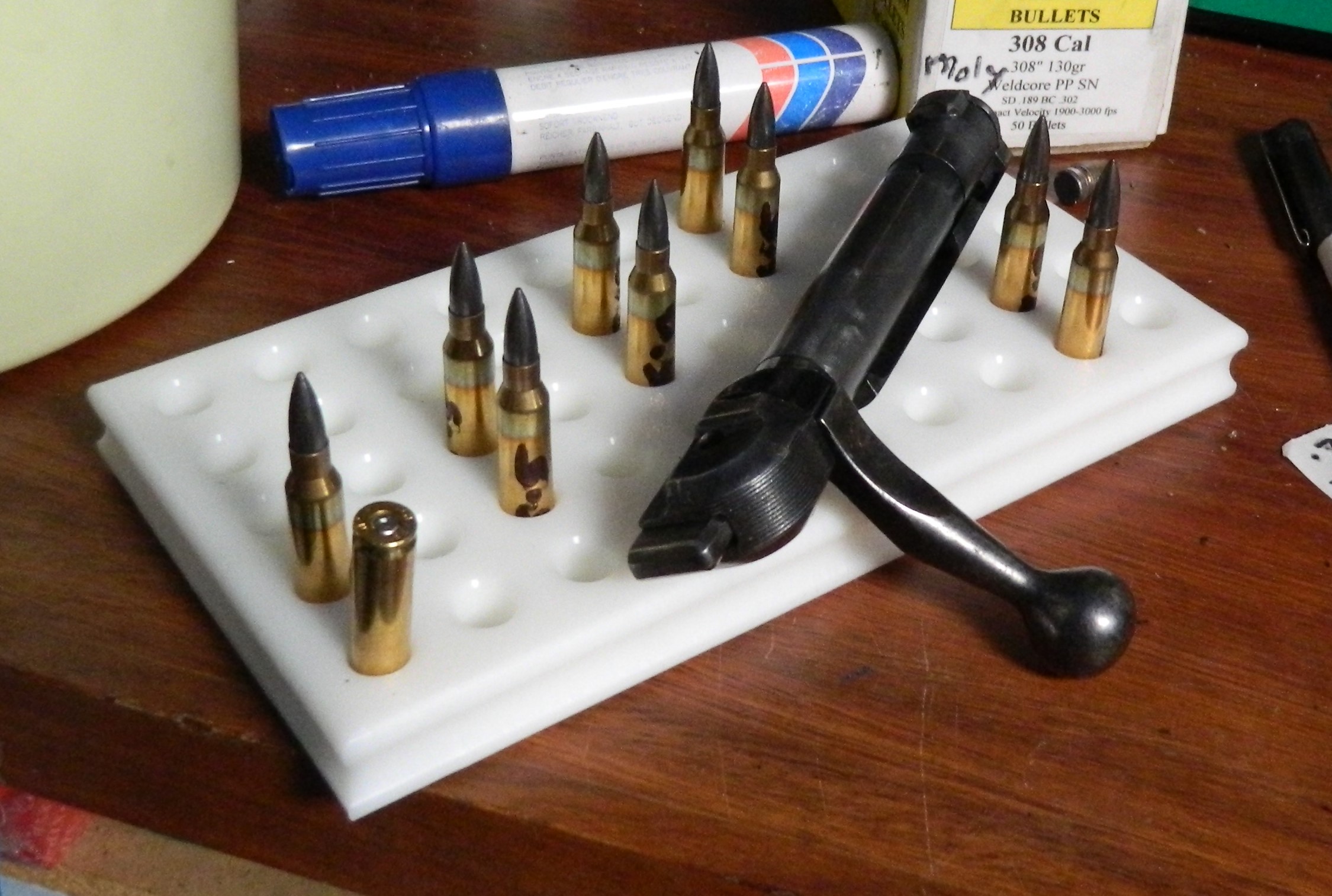

The loading block, with the 1/2 grain increasing powder charges (x2 each), and the first shot now fired.

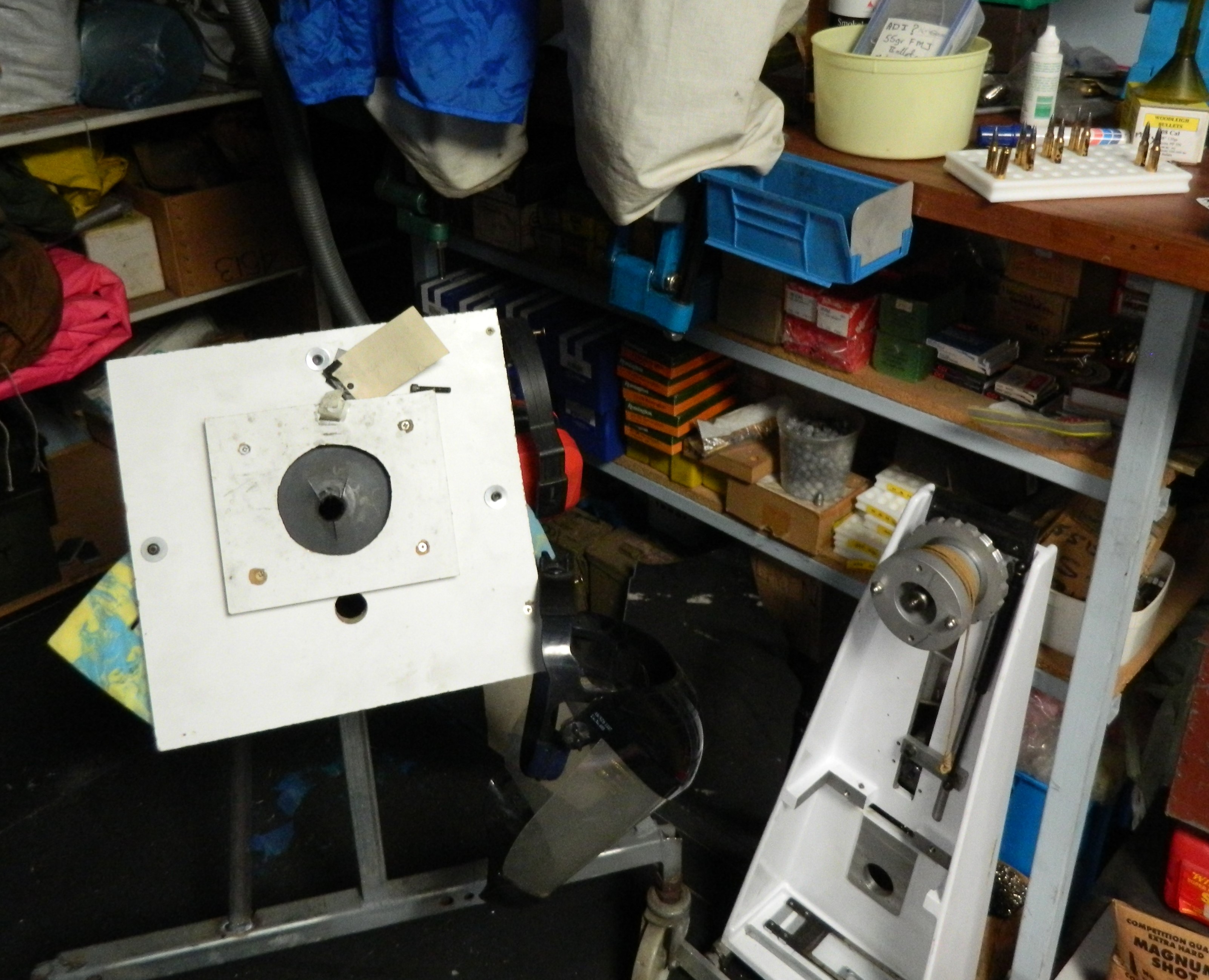

Here is the bullet trap, next to my loading bench.

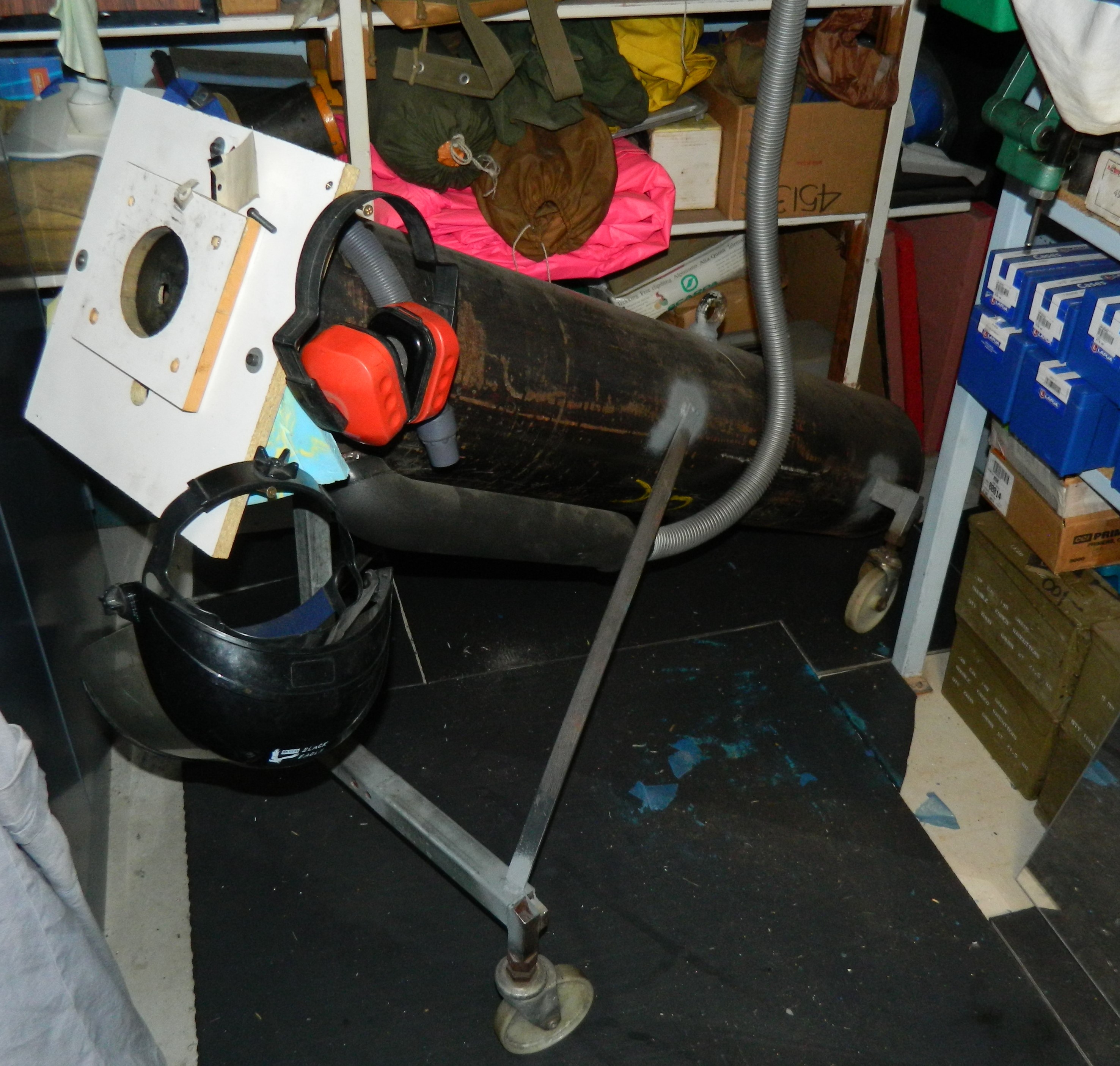

Here is a better view of the bullet trap (250mm Dia, 9.5mm thick steel wall x 1.500mm long steel pipe, filled with "Stuff"......... to stop bullets.
Please note the flexible exhaust hose, connected up to the B/Trap.

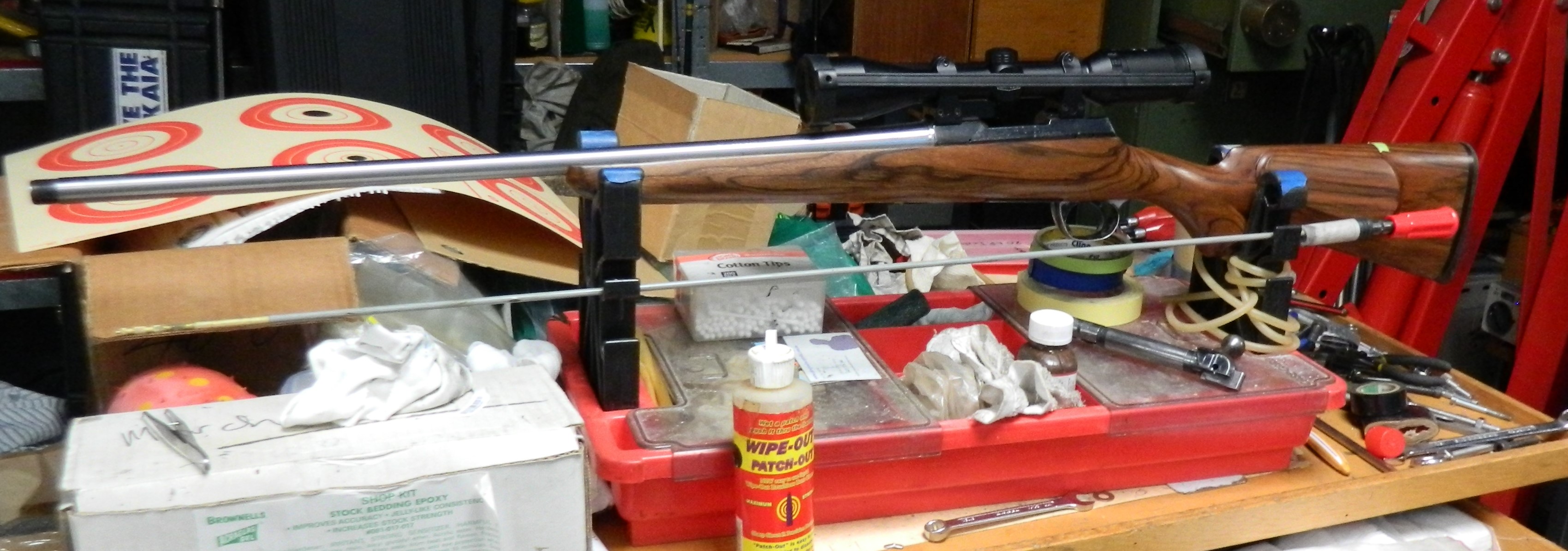

And the rifle in it's MTM cleaning cradle, with some Patch Out, bore solvent up the barrel.
I do a Ladder Test, and run in the barrel at the same time.
