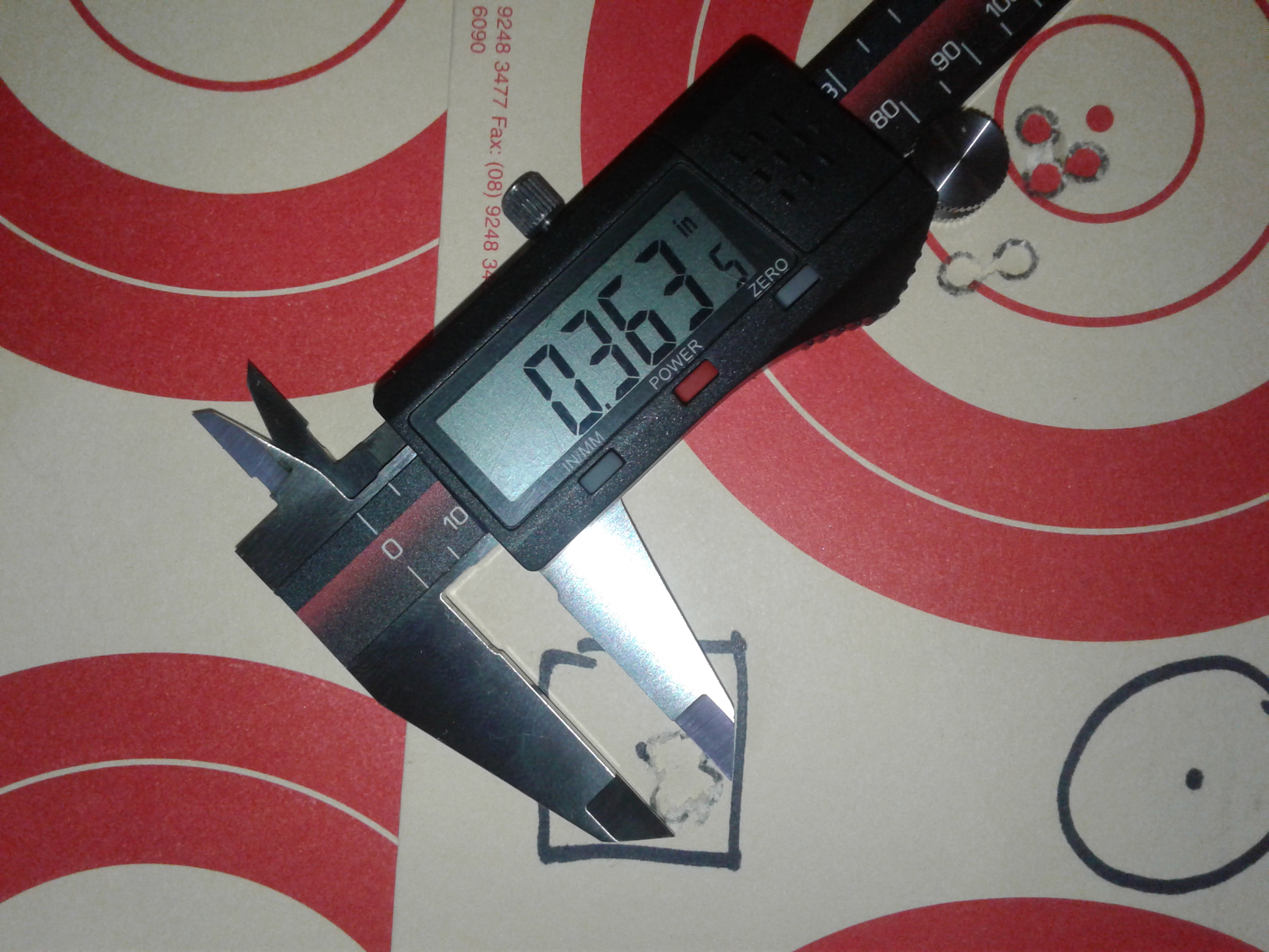

hi all. just wondering if anyone has performed a bedding or floating job on a 22lr. my rifle is a 1960 krico 22lr . the barrel sits in a nicely inletted stock, but it's sitting hard on the channel. i know some rifles don't respond well to floating. anyone want to share their experiences or opinions ? the rifle will shoot around 25-20 mm 5 shot groups at 50 already with it's chosen ammo. i just want to tweak it a little more.... :lol: :thumbsup:

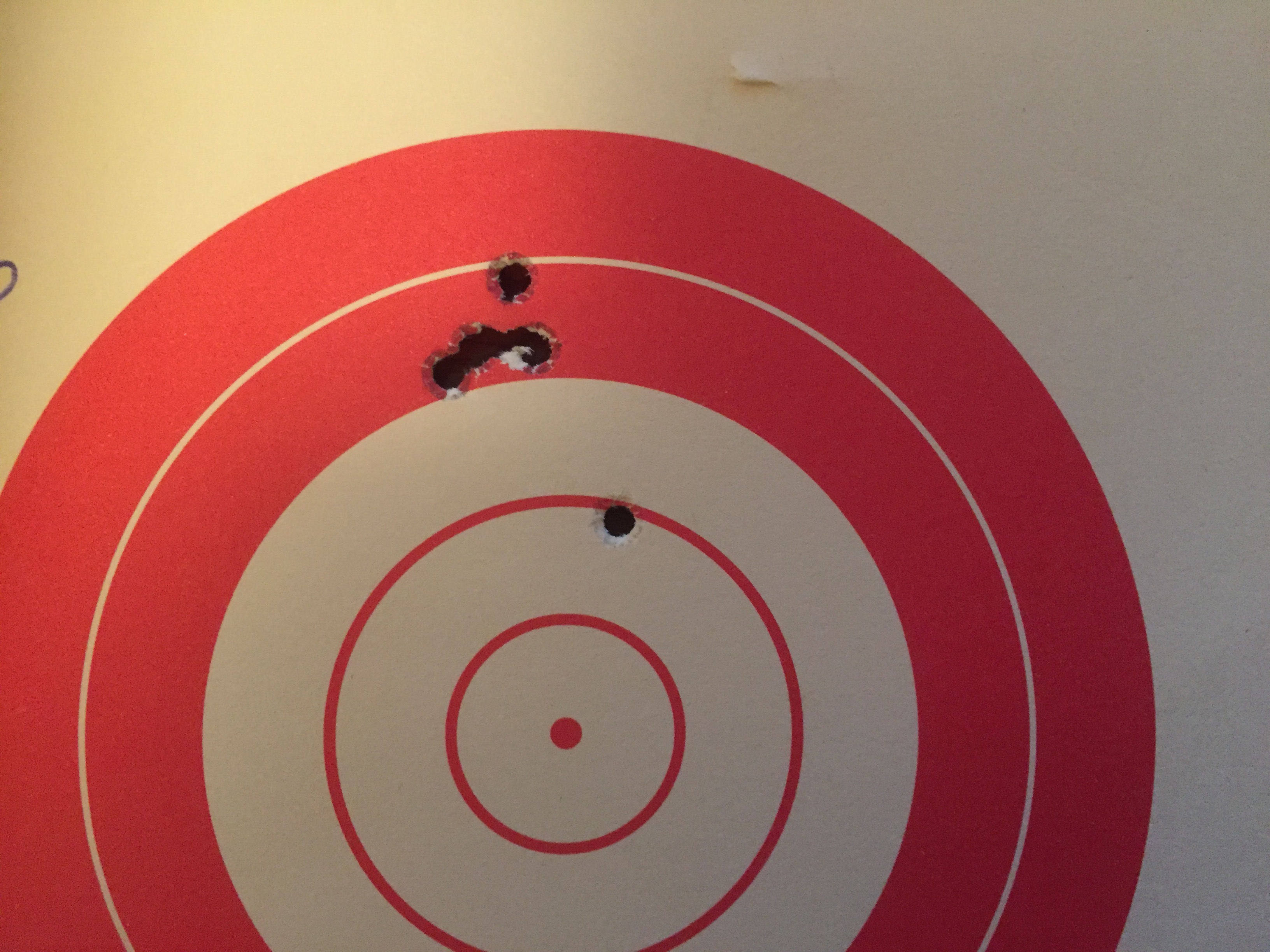

well fellas, i'm thinking about packing it with cardborad to get the barrel floating and taking it back to the range to see if it makes a difference. the attached pic shows a bit of vertical stringing which someone suggested was a sign of bedding issues. i'll keep playing , stay tuned :thumbsup:
krico and 40gr win sub hp's

Dunno why my phone flips the pics at times, that pics on its side. That’s a nice CZ ya got homer, I had a 2E a while ago that wouldn’t shoot that good :thumbsup:
