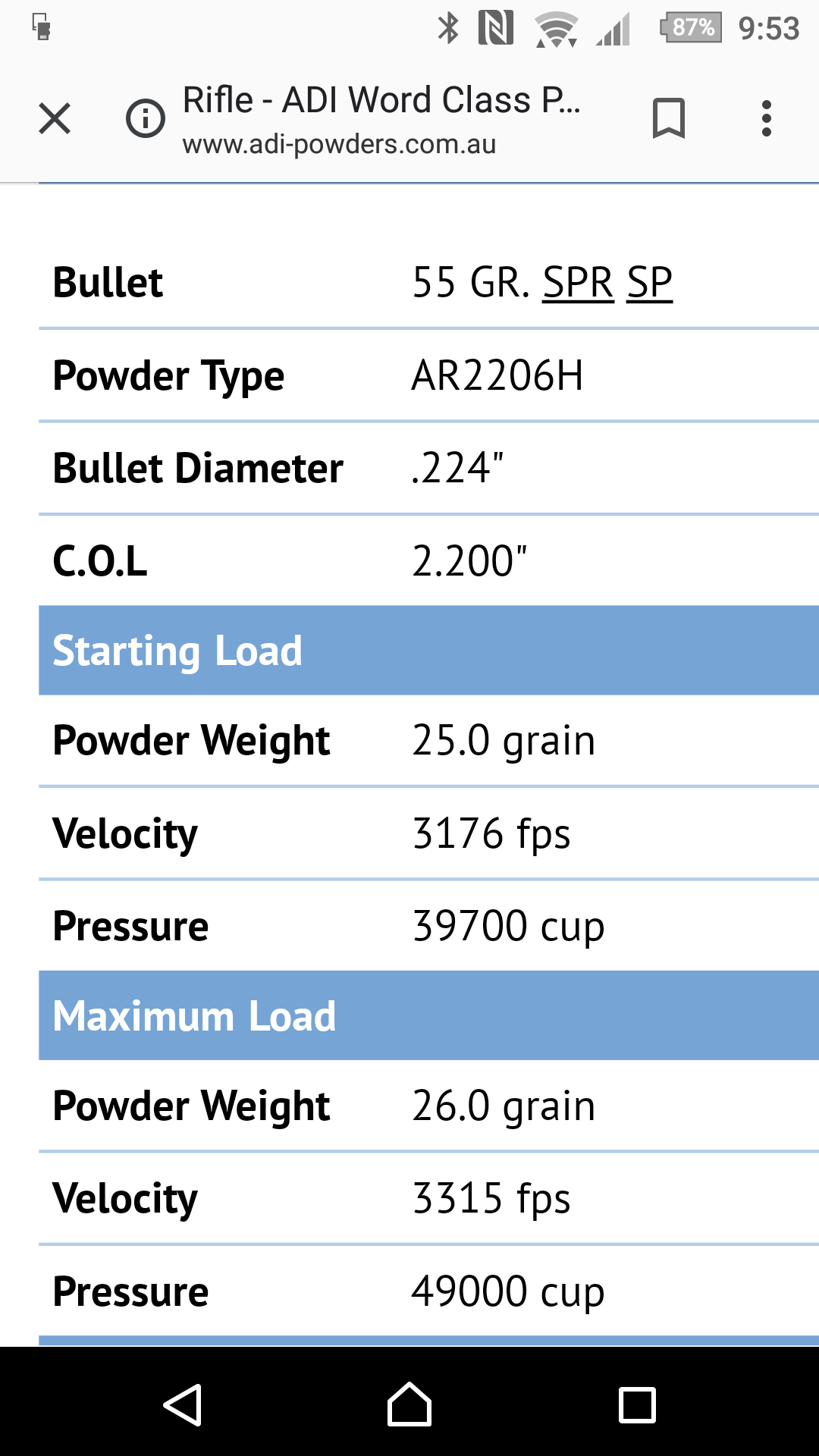

I've just looked at the ADI load data for the Roo Max I just bought, not much wriggle room with min at 21gn and max at 22 of 2206H

Post by Roo farmer » 12 Nov 2018, 9:29 pm
Really? What are you comparing to? The closest I could see listed is the 55 grain Speer SP, and it's much higher. I know I run 25.4 of 2206H with Sierra Super Roo 55's.
Roo farmer
Posts: 107
Re: Replacement Barrel For Howa .223
Post by Gaznazdiak » 12 Nov 2018, 10:21 pm
Roo farmer wrote:
Good thing you pointed that out, I was looking at the Barnes solid copper TSX :roll:
Thank you. :thumbsup:
Looking at the correct line, yes 25-26.
