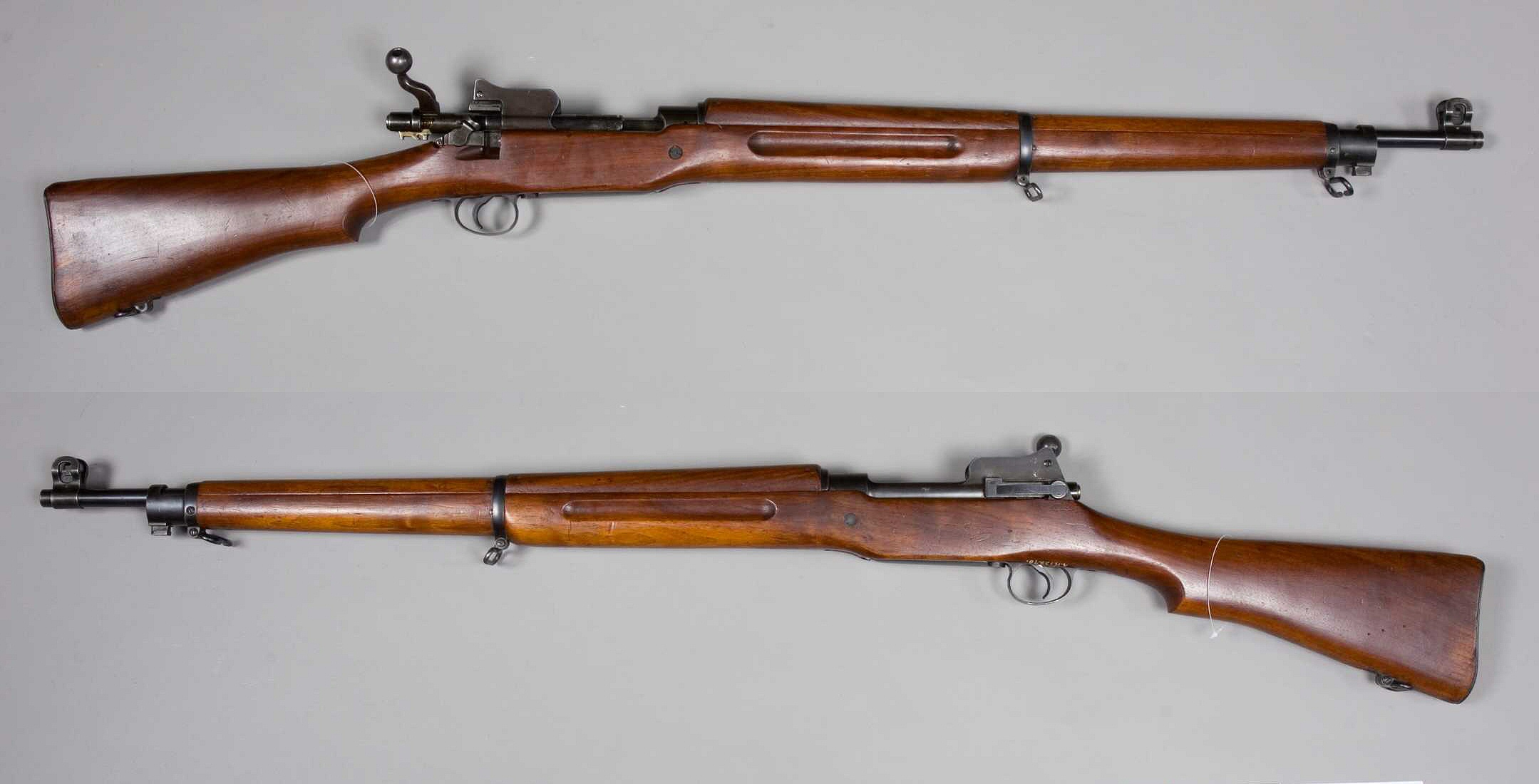

Post by wrenchman » 28 Feb 2019, 2:45 am
here you go guys very nice gun the m1917 it a very collectable here only made 2 years
