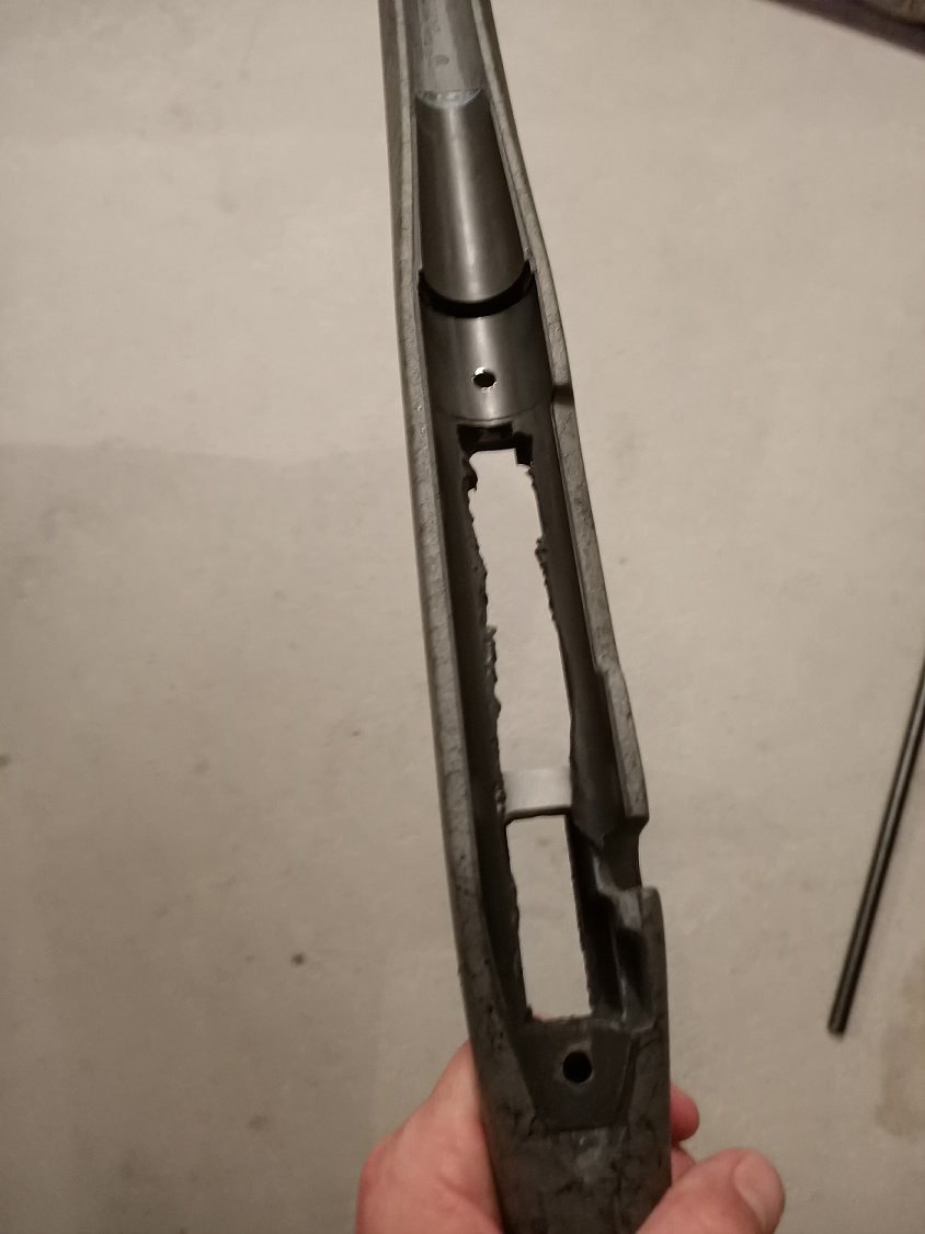

Post by Am88 » 11 Nov 2019, 9:06 am
These were two rifles I've bedded with Devcon 10110, it was very easy to work with, not runny stayed in place and cured as it was meant to, also very easy to clean up. These photo's were taken straight after pulling barrelled actions, no cleaning. T3 and Rem700, Pretty happy for a backyarder
Tikka Bedding.jpg (255.41 KiB) Viewed 10917 times
Rem Bedding.jpg (140.26 KiB) Viewed 10917 times

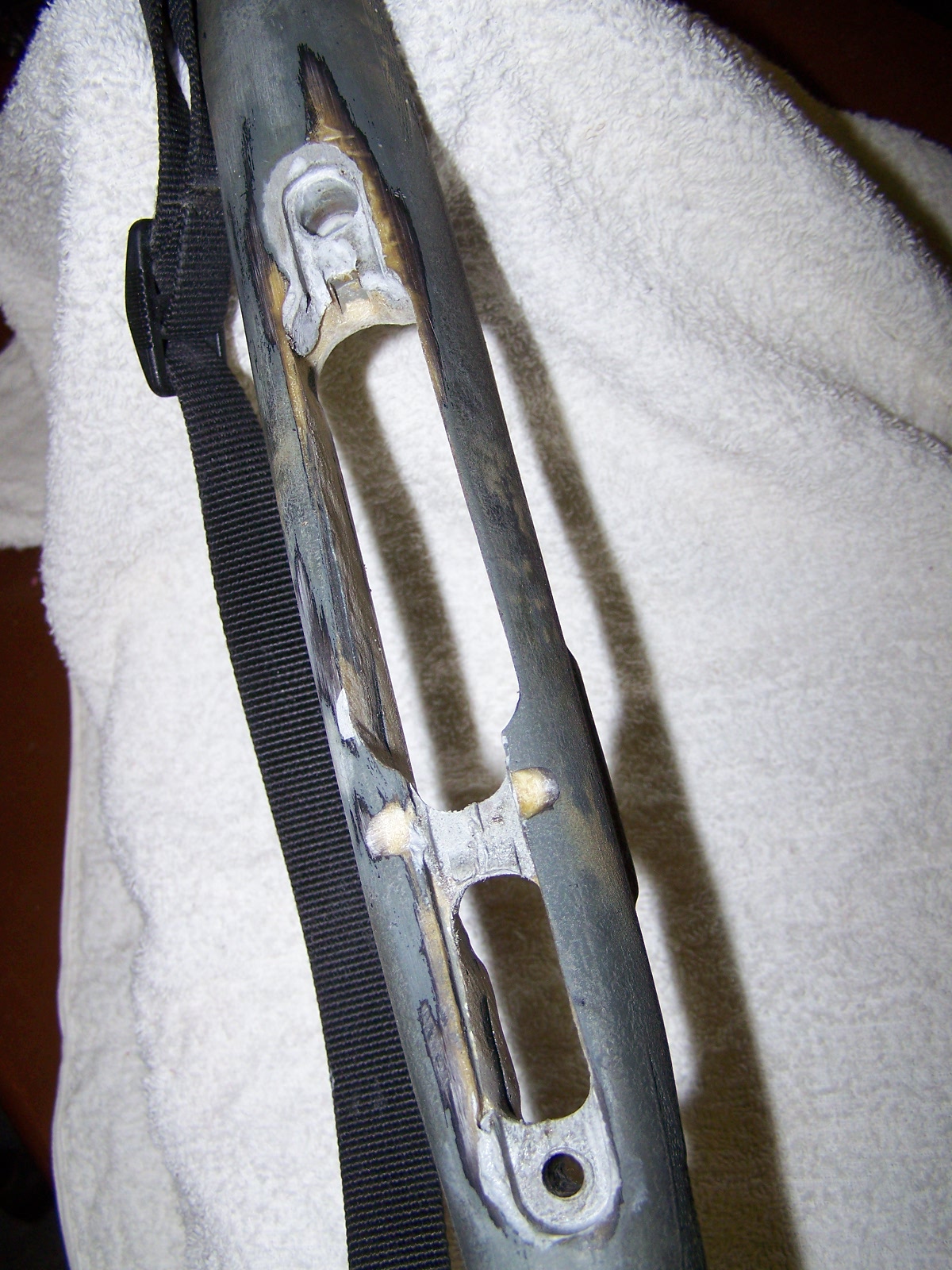

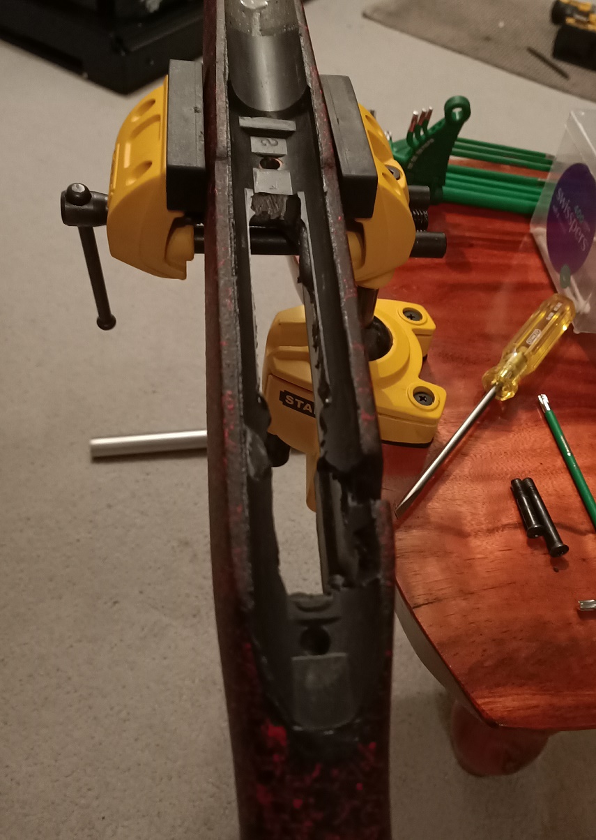

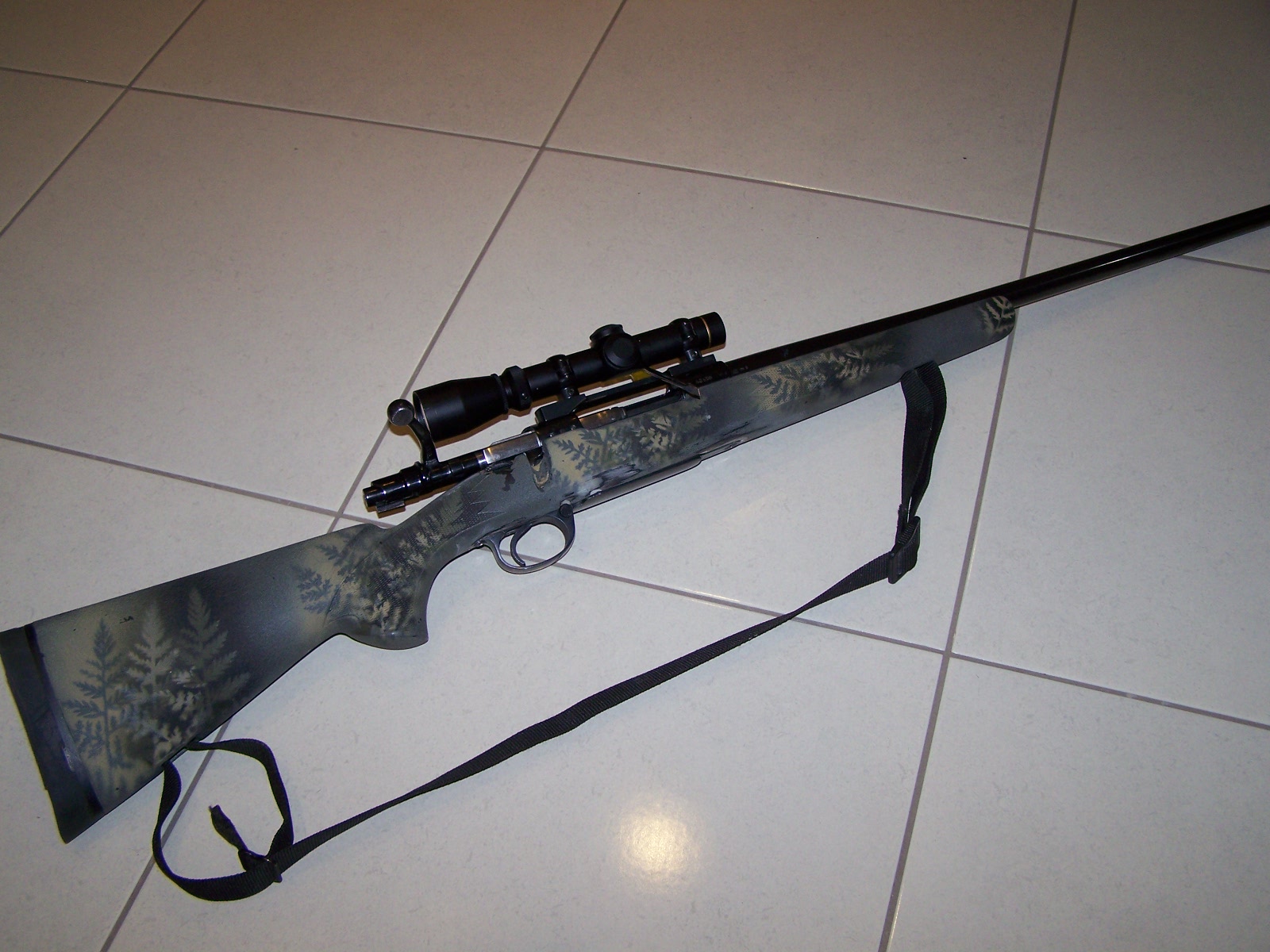

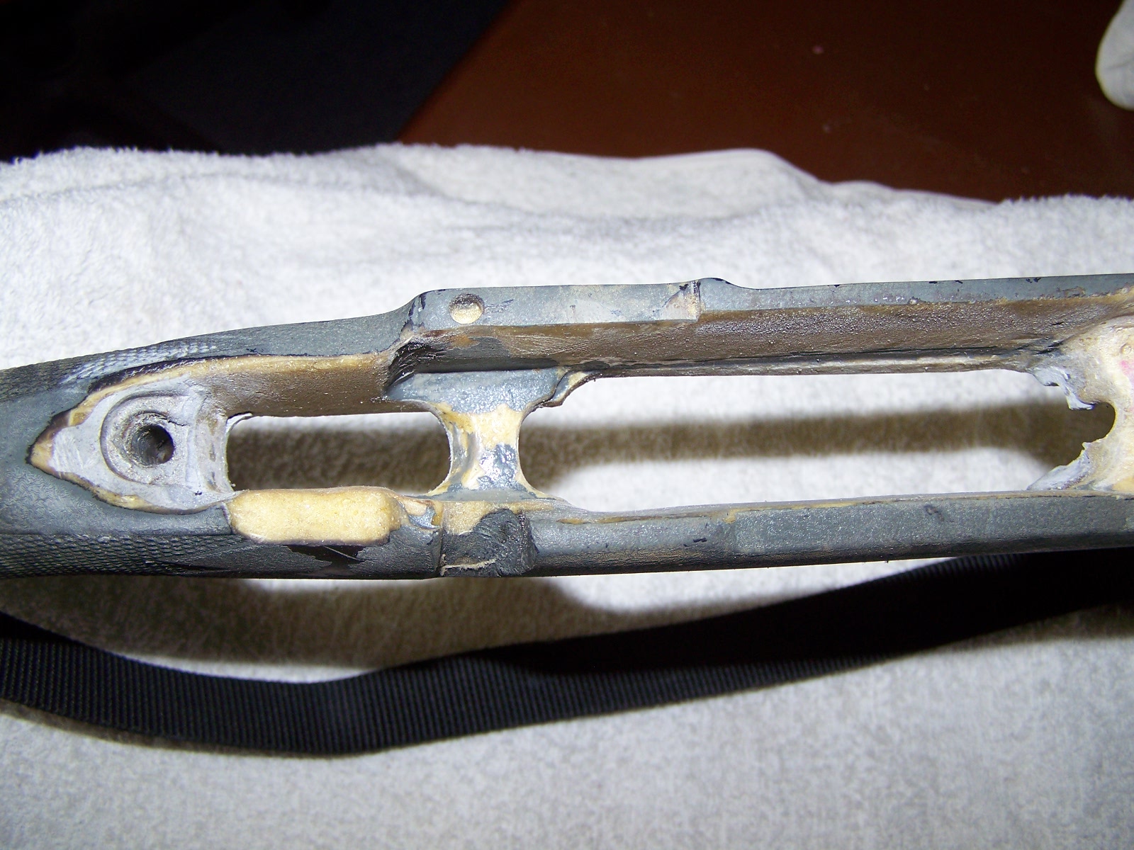

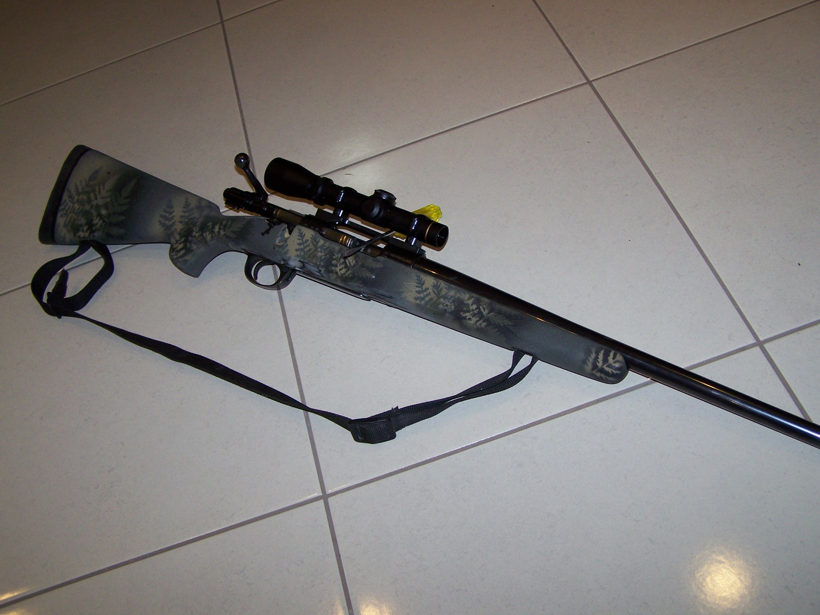

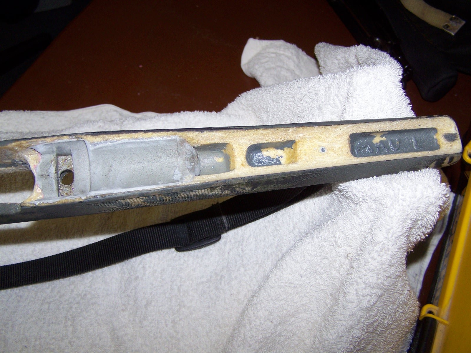

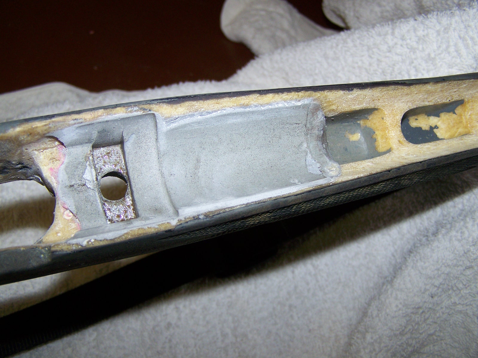

Post by Die Judicii » 20 Nov 2019, 6:16 pm
I finally got around to bedding and floating the rifle with the Sika product.
Where necessary to block or retain the compound I tried kids "playdough" and it seemed to work well and is easy to remove afterwards.
For a release agent I just used Coppercoat,,,,, so I used what I had on hand and it all did the job.
I'm pretty pleased with the end result, and only have to do a bit of paint touch up on the stock where I had to relieve it for a good fit and float.
In the next few days I'll check the zero and the handling characteristics before trying it out on some bigger pigs.
This stock is 110% better to hold and handle than the original one which was so slippery it nearly jumps out of your hands when firing it.
