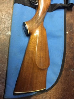

I wasn't really going to bother with this, but bugger it some people might find it interesting. Some of you may have picked up from other threads I'm getting a barrel put on a CMC Mountaineer action I picked up already chambered in .223 with a Varmint barrel. Got the phone call and made payment last Friday from that it's ready to go so it should be here this week hopefully.
I was never really going to do anything to this other then bed the action, planned on leaving the stock and just using it, but I got the stock back out of the cupboard last night and I'm not happy with it so looks like I'm taking on another project. First is to strip the finish, got the bits yesterday arve from bunnings will get into that this arve. Also the original swivel stud holes are a bit flogged out and the studs are loose and sloppy, I have some 3/8" oak dowel left at home from another job so will drill the holes out and fill them. Length of pull also needs to be longer.

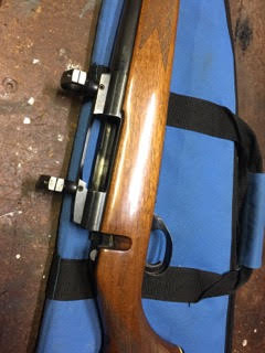

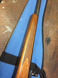

This is as I got the rifle.
CMC .223 3.jpg (19.11 KiB) Viewed 18664 times
CMC .223 2.jpg (18.71 KiB) Viewed 18664 times
CMC .223 1.jpg (18.65 KiB) Viewed 18664 times

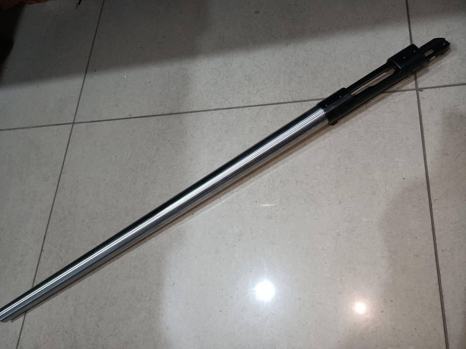

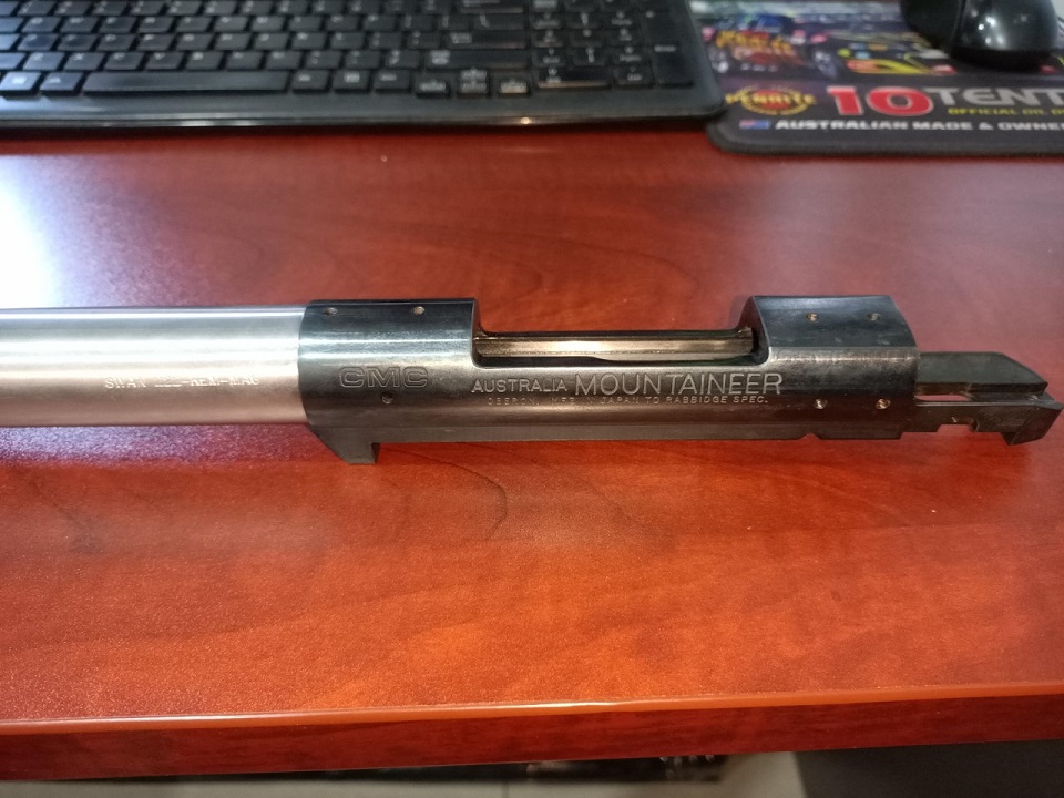

Well today is a happy day as be buggered it just turned up in the post :lol: lucky I'm not walking around with this one. :clap: total lead time I waited was 9 weeks, Allan originally told me 8 so 1 extra week and over Christmas I couldn't complain.
24", 1/12" twist, Krieger #17 profile

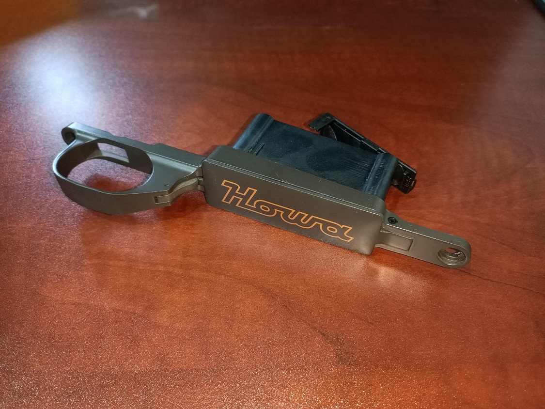

Got a bit excited when I seen these, brand new bottom metal complete with magazine. The paint is all coming off the factory one and a bit of corrosion, this one will look much nicer, the action already has Howa written on it so not too stressed about the writing.

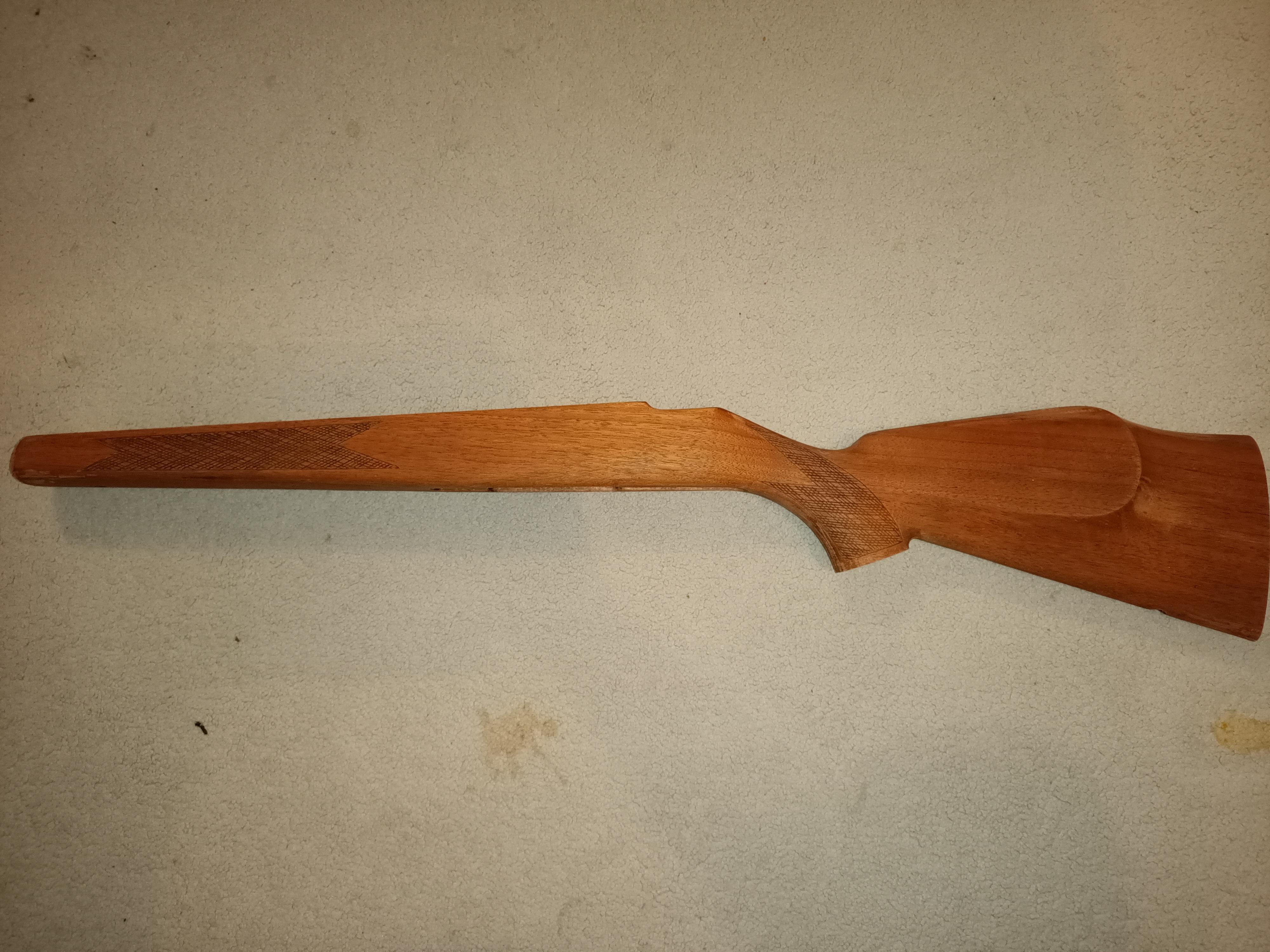

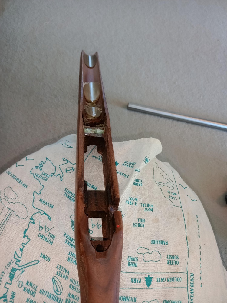

Was a big weekend so didn't get as much done as I would have liked, got the barrel channel to a stage where I could would on the pillars and do the bedding so I have repetition when I put it in the check the barrel channel, I have something I want to try with that later on anyway to stiffen it now I have so much material removed. I made up a couple of rests out of bog in the barrel channel to take to weight of the barrel so it does not affect my bedding. Made up 2 pillars at home, done a test fit to get length, worked out really well so happy about that, just need to lathe a couple of grooves in them. Coming along slowly :drinks:
Barrel Channel.jpg (228.97 KiB) Viewed 18518 times
Am88

Post by Am88 » 21 Jan 2020, 9:10 am

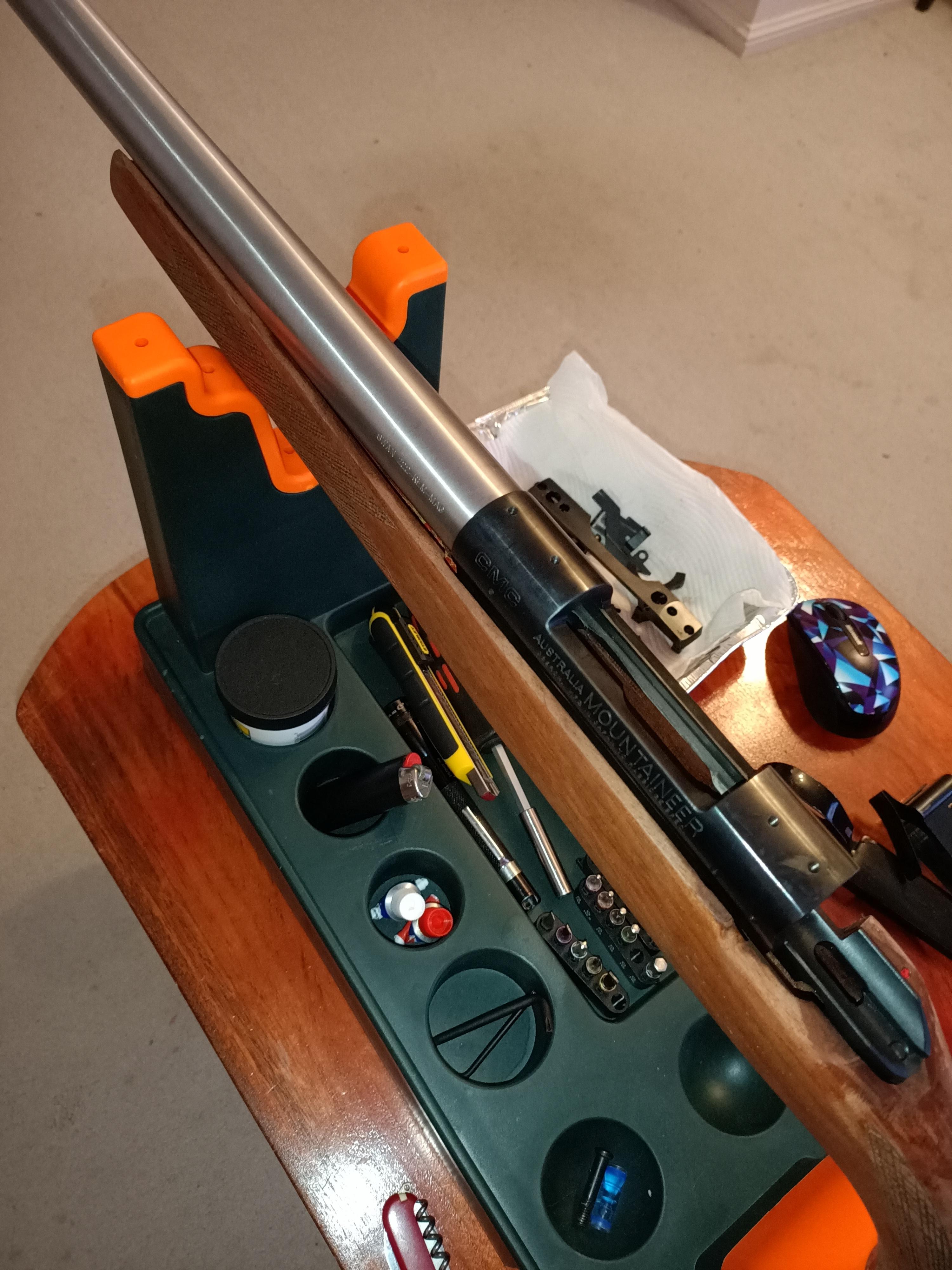

Got it happening last night, attached the pillars sorry no photo’s of them forgot, get myself setup with the bench, couple of Jack Daniels to settle the nerves and mixed up the Devcon, never pillar bedded a rifle before so I think it went well, used counter sunk bolts to centre the pillars to the bolt holes, ground down the counter sunk head to be smaller then the pillar. Popped it out this morning and all looks good, one lesson learnt, on previous rifles I used to put way to much bedding compound around the rear screw, and it was always so much to clean it all up after the process, so I said to myself this time I will just use less, I didn’t bloody use enough :lol: not to worry it just didn’t come up and squeeze out the back, now there is a gap around the rear tang bit.
I couldn’t help myself, I had to do a dummy fit with a scope, that is using medium DNZ reaper one piece rings. Coming along.
