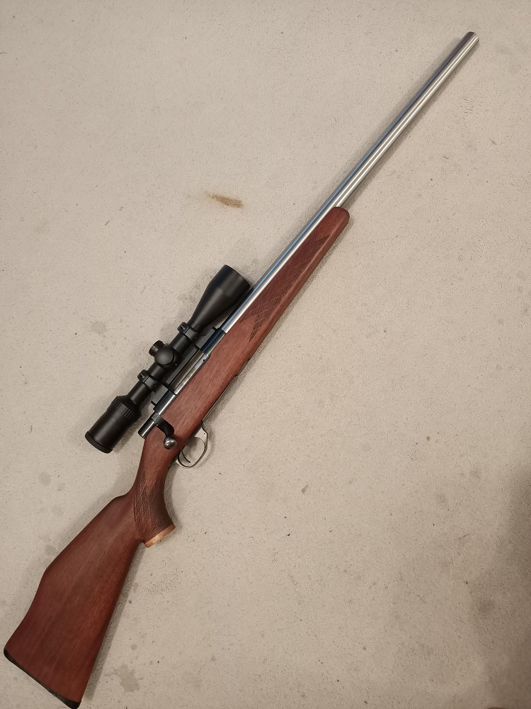

Post by Am88 » 09 Oct 2020, 8:47 am
This is how the rifle sits now. Stock has darkened up nice enough. Will see how I can get the 55 grainers to shoot.
Am88
