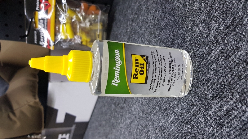

Post by Aliqua » 13 May 2020, 7:14 pm
In my haste I didnt ask all the questions at the store and just got what was recommended...
Is this a one size fits all bore lube/cleaner or should I also consider additional products? Is this also used for external protection (no wood on my stock).

Post by JimTom » 13 May 2020, 7:29 pm
Mate there are a thousand different ideas, and a thousand different products on the market for cleaning centerfire rifles.
If you do a search there will be a few that pop up.
My regime is as follows. I use G96, wd40 or similar and run a few patches through the barrel just to get rid of and loose stuff like dust, a bit of powder fouling etc.
I then use hoppes #9 to remove carbon etc.
after that I run bore tech cu++ to remove copper fouling.
I then run a patch with CLP or G96 up the barrel for storage. I wipe down the bolt and externals of the rifle with G96.
No doubt some will disagree with what I do however it works for me and I achieve excellent accuracy from my rifles. There is more than one way to skin a cat mate. Have a quick search on this forum, plenty of different ideas.

Post by Aliqua » 13 May 2020, 7:53 pm
Thanks guys - yeah I have read the forums and they talk about rem oil. Just didnt know if this was the same stuff.
I'm starting with range shooting so it's low/no dust. Will have a look at some of the other products mentioned and make a regime...

Post by Aliqua » 14 May 2020, 4:43 pm
TassieTiger wrote:Aliqua - are you also asking re bore run in / bore cleaning after shooting ? Because that’s another question all together...and again will result in many opinions / products. I assume you have a cleaning rod, brushes, jag, etc.
Hey TT,
I've got the rod, got the jags and brushes and the role to cut my fabric etc... the thing was all he gave me to clean my gun was a small bottle of rem oil. Didnt think that was enough for removing copper and carbon etc.
I guess it was an open question-- what chemicals do I need to clean my bore pre-first shoot, after every shoot and for external use before storing (as I'll only be able to shoot about 1 time per fortnight/month).
I just dont understand how anything could be a solvent and a lubricant... and if it was would you leave that on your gun ling term with solvent in it? I wouldn't.
So confusing... and like everyone has said, so many varying opinions. Hard to get a start point haha!

Post by Aliqua » 18 May 2020, 2:35 pm
So many termonologies to learn. I want to obviously get small grouping for target. But also just undertake hood cleaning practice.
So where do most of you get a "decent" bore scope from? I think all I need to find is something for copper - my local didnt have any.
I've opted for hoppes 9 carbon, and going to use the rem oil for lube/protect. And after a shoot look down the bore for the copper. They're hornady super performance 308 165gr sst bullets so I assume it's going to leave a bit to clean out...
